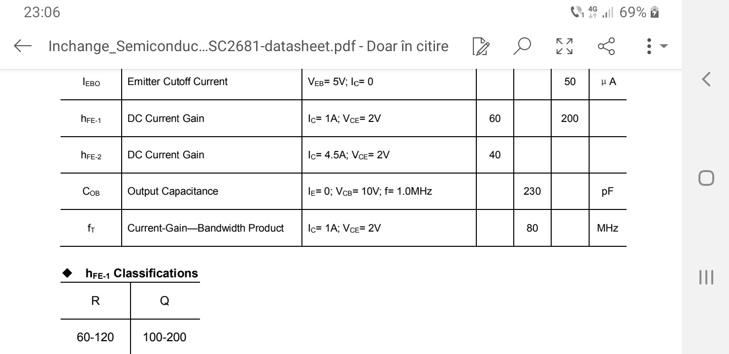

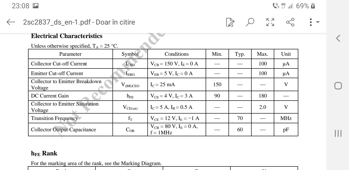

About low cob...

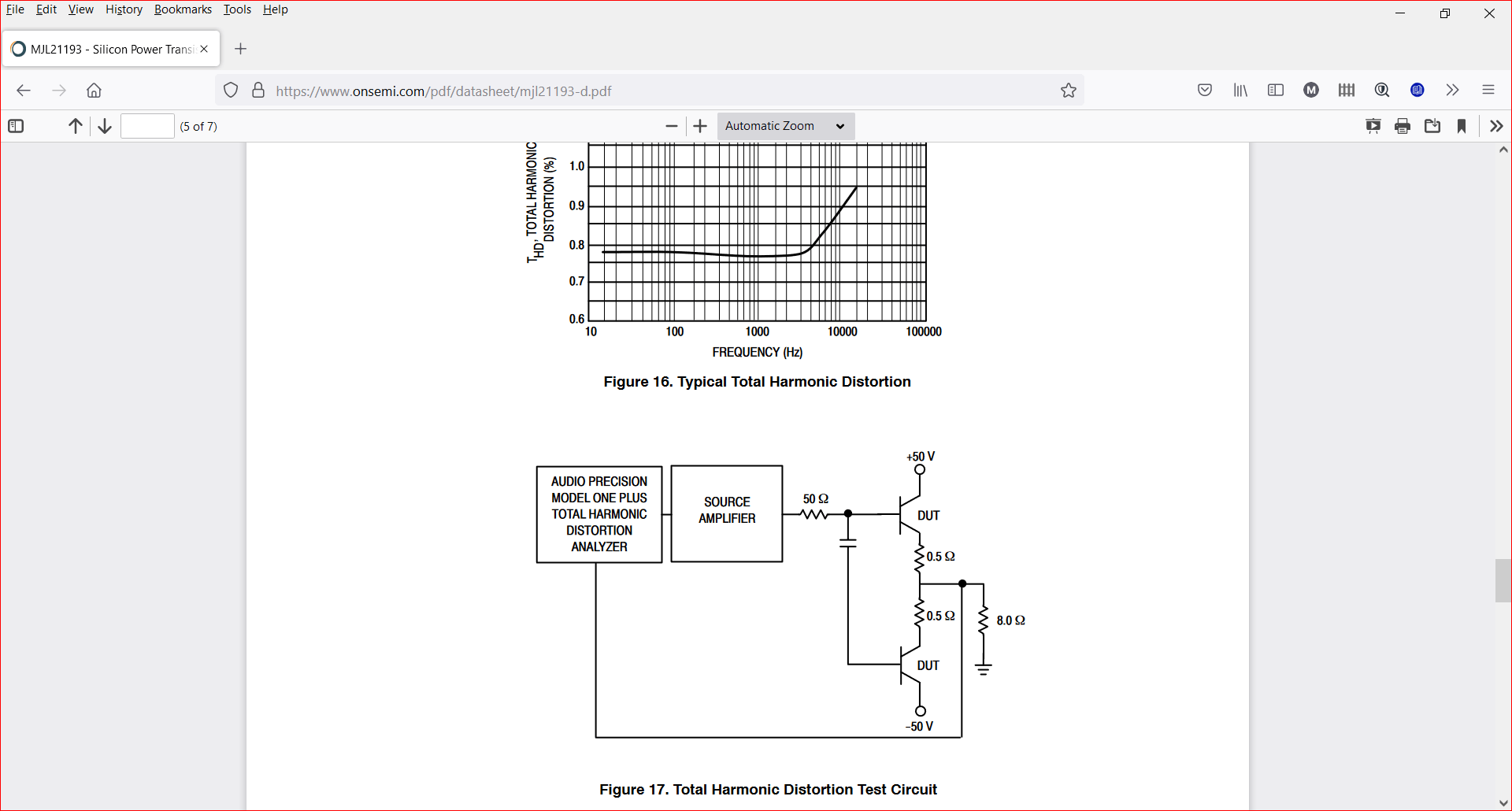

Except you want to equal top 1980's amplifier performance that today aren't anywhere to be found in any price range...
My buffer has 0.011% thd at normal listening level. Why would i want to build that with ~0.8% thd and more at higher fr.

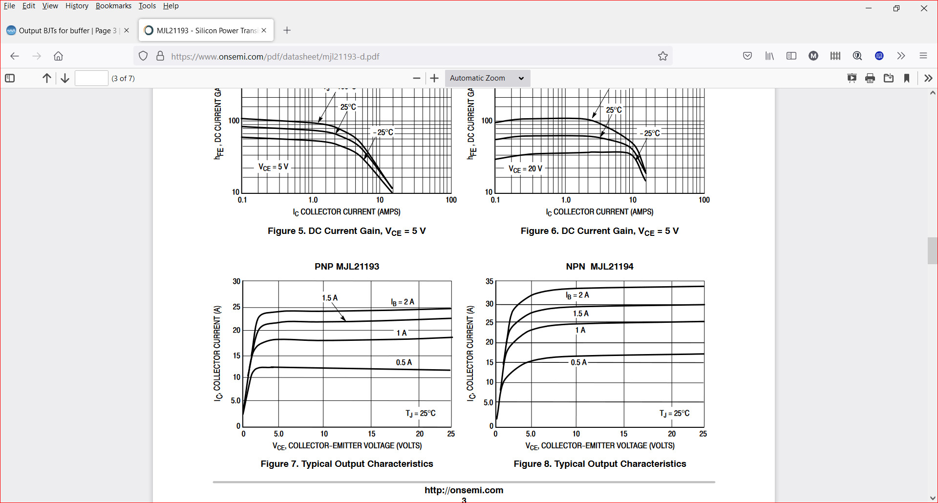

These transistors have been used in recently published magazine published designs that give THD of <0.008%, 20Hz-20kHz at 32W into 8R. These results are test proven using Audio Precision equipment not simulations. The design follows the Blameless model which uses nfb to attain that level and operate at a low level of Class AB. If you look at the graphs below you will see these have linear operating characteristics at high current levels. These plots would look even flatter with lower base currents and operating in Class A.
This design was tested with a variety of output devices and drivers included the closely related NJW21193 and NJW21194 which were standard as well as 2SC5200 and 2SA1943 which were verified as meeting the same standard as the NJW parts. The humble TIP 35B and TIP36B were performance verified for surprisingly good performance.
