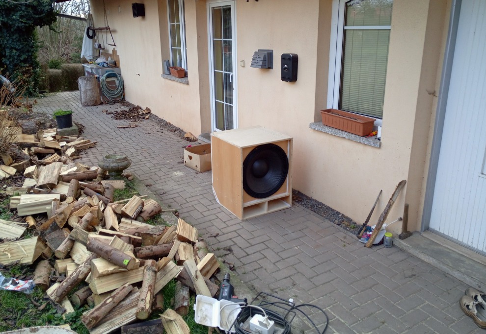

...Soo, I made a prototype enclosure.
Can´t believe the accuracy of my porth length wild guess. 29Hz without padding (will push it to 28 with padding). About exactly as I expected.
Plugged it to the amp and listened/measured.
The output at the low end is still there, not weaker than in larger box.
I´m amazed of the speaker. It´s sheer power (motor force) still is able to drive the bassreflex port even in small volume of the box.
Bassy songs sound more "with ease", yet I don´t really feel like it goes significantly deeper. Things rattle a lot in the room, even at 25-26Hz, that is a good sign, yet my ears say NO from 29Hz down. Diminishing returns so to speak. I will leave it at that.
The box is smaller than the original one, and even with few centimetres shaved off of each side, handling of the box alone improved significantly.
On the other hand, I effed up on the ergonomics. Mean WHEELS.
The back side of the box doesn´t allow for usable wheels at this moment. Yes, the box could roll on the flat ground with small wheels, but that is not what I´m looking for. Big wheels either wont fit, or will stick too much out of the box. I really wonder, if extended "skids/sledge" on the bottom of the box, and additional two wheeled handler/transporter wouldn´t be better idea after all. Decisions, decisions!

The next one is from further away. Looks tiny, yet still is not compact enough to encourage you to man handle the box when you need to move it every time. Some kind of aid is still needed.
I have to figure it out.

Heh, that would most probably only work for moving, but not much anything else. Ease of building and box volume would suffer too, and not to mention - this bloody speaker can develop force in excess of 800N, if not 1000N peak. Than thing wants to move, I can guarantee you... Even in this box I have it now with little underpowered amp, It felt like badly loaded old washing machine at times! The box with the speaker (15mm ply) is like 40kg now, and the force is 80kg.... Of course it is not direct force to the enclosure, but it really moves the box anyway. Nobody ever heard of "drag race competitions of bass bins" ? That´s common quality indicator for some. :)
You certainly don´t want to make this thing tall.
By the way, the port is "folded" now too.
Yes, I like that too. The front wall of the box is used maximally efficiently. Yet it was more "front side" efficient approach with the original box with triangular bassreflex ports in each corner. That way, this box looks bigger on first glance.
Because of that, my brain is still "ball of wire" and in confusion about what to think about that box.

That is a concern I have with these drivers. Big output in small box equals shaking...force cancelling mounting would work well if size wasn't an issue(hence wanting to use 2x15" instead of a 21", although not tuned as low).
I think you're at the box size limit for that driver and tuning! It really is quite small for what you can get out of it.

Yes, these things, downsizing and technology, bring new kind of issues, never causing problems before. Might sound funny if it is not your problem yet, then it becomes quite bad issue. You got good solution though.
While I mean the downsizing seriously, I cannot afford to put two 18"s in a box. Also I would like to have two bins. That wound mean I cannot really stack these together or against wall.
