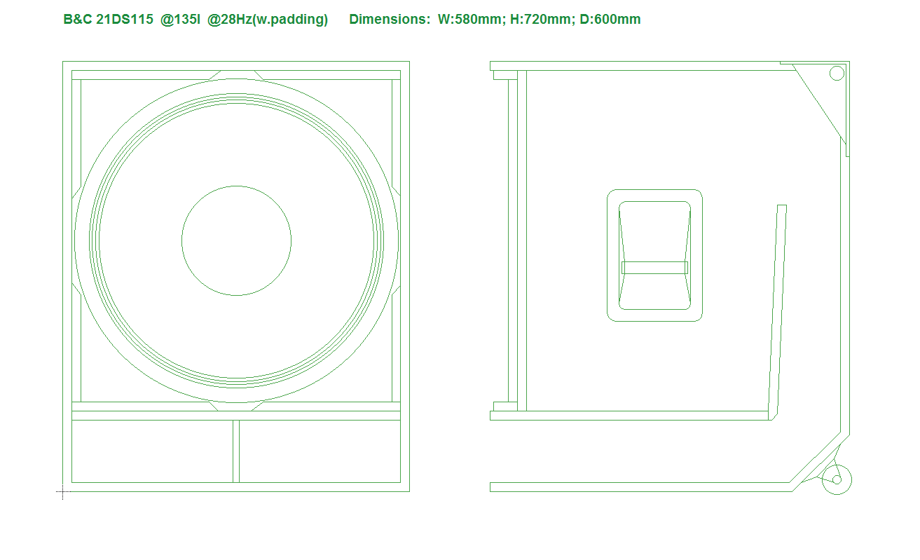

...Soo, I made a prototype enclosure.
Can´t believe the accuracy of my porth length wild guess. 29Hz without padding (will push it to 28 with padding). About exactly as I expected.
Plugged it to the amp and listened/measured.
The output at the low end is still there, not weaker than in larger box.
I´m amazed of the speaker. It´s sheer power (motor force) still is able to drive the bassreflex port even in small volume of the box.
Bassy songs sound more "with ease", yet I don´t really feel like it goes significantly deeper. Things rattle a lot in the room, even at 25-26Hz, that is a good sign, yet my ears say NO from 29Hz down. Diminishing returns so to speak. I will leave it at that.
The box is smaller than the original one, and even with few centimetres shaved off of each side, handling of the box alone improved significantly.
On the other hand, I effed up on the ergonomics. Mean WHEELS.
The back side of the box doesn´t allow for usable wheels at this moment. Yes, the box could roll on the flat ground with small wheels, but that is not what I´m looking for. Big wheels either wont fit, or will stick too much out of the box. I really wonder, if extended "skids/sledge" on the bottom of the box, and additional two wheeled handler/transporter wouldn´t be better idea after all. Decisions, decisions!

I have redesigned my original plan, so the 100mm wheels would fit.
I´ll try that one.
While I mean the downsizing seriously, I cannot afford to put two 18"s in a box. Also I would like to have two bins. That wound mean I cannot really stack these together or against wall.
BMS drivers are also beasts, with great excursion limits making me drool over these. Too bad they didn´t ramp up the motor force too. It would be with the IPALs right there....
I´ll try that one.
New prototype of the box has been made, with 100mm wheels that fit in.
Welp, Not exactly as I expected - the box really needs to be angled a lot to go safely (balanced) above the ground. One really needs to get down to it, to pull it well.
It has been pointed to me, yet I didn´t think it´s a biggie. Once things got real, it is not so easy.
So the "corner" handle is not very ergonomic for rolling around, yet straight handle cannot be put and used on the top desk, as the box would not be balanced well for pulling.
I´m now considering something like a suitcase handle and other solutions.
What a drag, to get just simple box easy to lug around...
