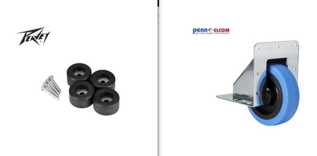

here's my favorite wheel solution so far....(both parts found at PE)
The corner wheels are 4" in dia.
The rubber feet are 1.5" in dia and 3/4" high
The wheels extend 1.25" below the bottom of sub/mounting bracket, so the bottom rear of the sub rests on the wheels off the ground.
I put the rubber feet under the rubber feet under the front of the sub, and add a 1/2" spacer to the feet , which lets the whole sub sit level 1.25" off the ground.
It's good vibration isolation, and serves as the necessary blocking when worried about rain puddles outdoors.
Biggest thing is, it makes the sub instantly easily movable 😀
