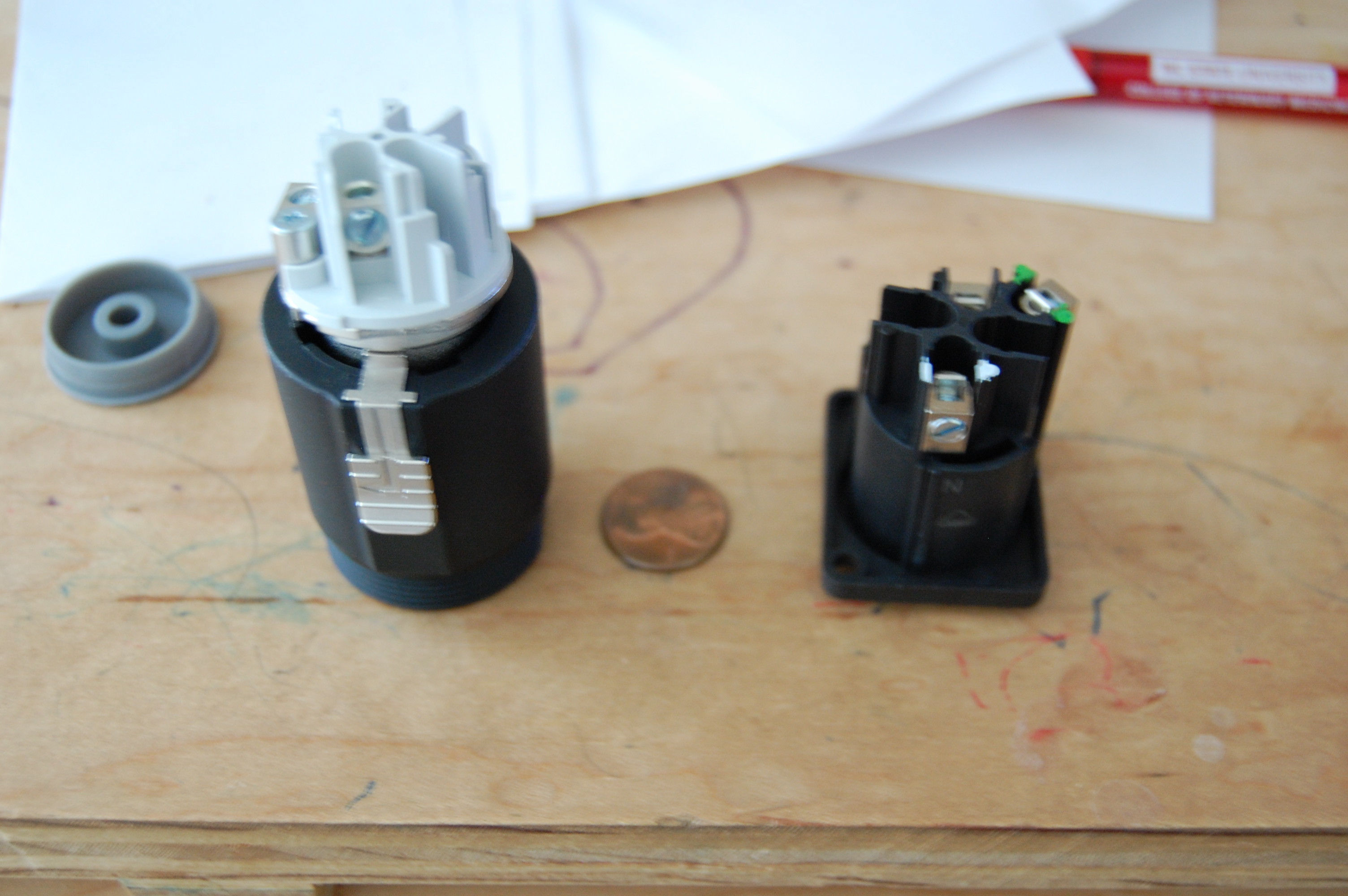

powerCON 32 A - Neutrik
Probably overkill, as they have a 20A version.
Got them for preamp😀
These would also work although not so nice looking

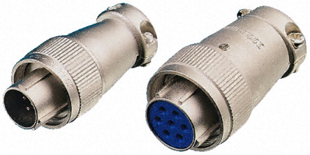

btw, I also found the mentioned Amphenol and ITT Canon
but there others
Coninvers, Binder, Hirose...
all these I have found listed as Circular Connectors, for Industrie and Automation
but there others
For about $10 a set a nos ITT/CANNON/AMPHENOL is my favorite.

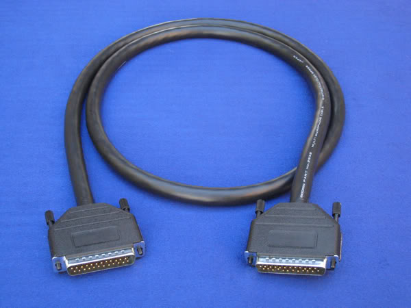

these look nice gold terminals and a nice secure connection , but i,m not sure about thier current rating
... nice secure connection , but i,m not sure about thier current rating
those are usede fro PC, printers, etc
known for having the worst possible pin connection
only the connector 'house' is secure
besides, its a low current design
IMO...I think the Amphenol and Binder connector looks good
I expect angled connector will be very practical for using shortest possible connection
maybe only 5A current rating, but using 6 pole, and paralllel in pairs for a 3pole connection, I guess it would be ok

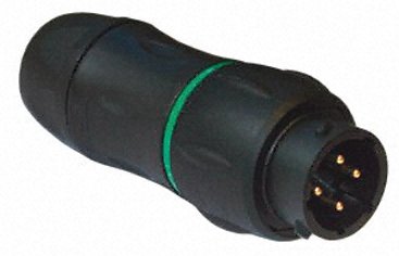

These any good?
looks right
but cant say 'good' without knowing them
btw, remember to look at cable thickness
