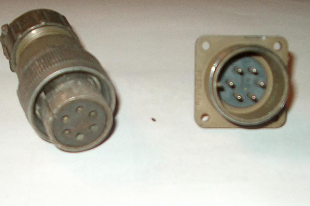

For about $10 a set a nos ITT/CANNON/AMPHENOL is my favorite.
If you can stand the vintage industrial look its a great connector.

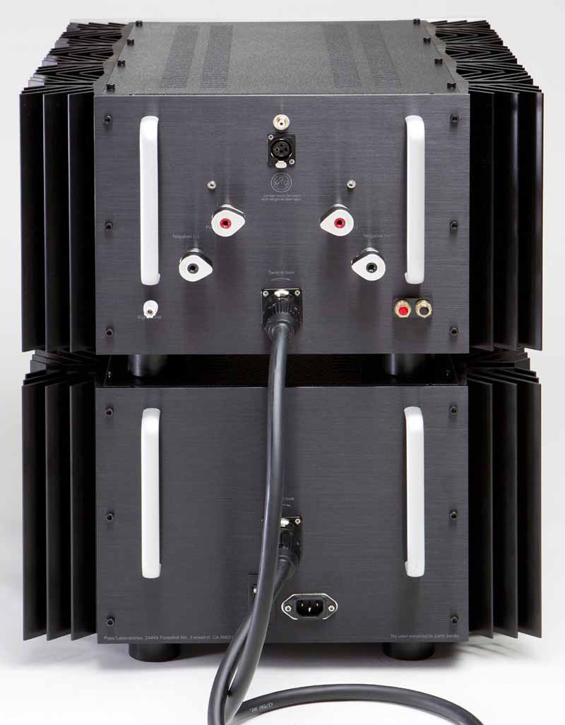

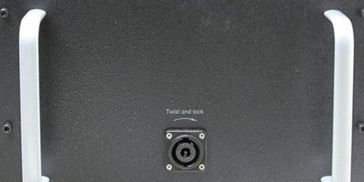

Gday all
Thats the speakon 8 pin i beleive Mr Zen and just what i was thinking of using
Tinitus i,m going to be using the plugs and making my own leads so i can make the umbilical totally different to the mains power cord
The speakon connectors i,ve looked at so far are rated to 30a continuos so will be fine
