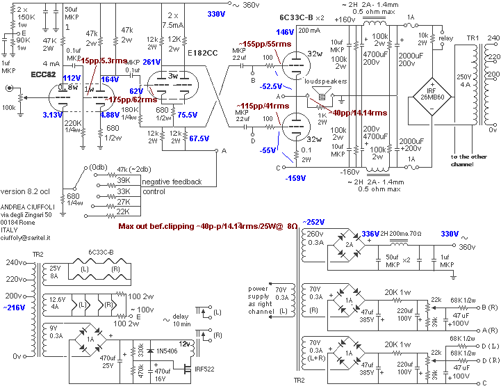

Ciuffoli Ver 8.2 OCL OTL
I am buidling the CIuffoli OTL amp but currently am at a loss as to the use of non electrolytic caps in the power supply B+ section and on the driver section of the amp.
Does anyone have a clue as to why he is using such caps and whether electrolytics would do as a replacement? Mind you the caps are placed after the rectifier bridge so there is no question that we are dealing with DC voltage supply not AC.
The difference in cost in substituting them with electrolytics is substantial.

The reason is better sound quality from MKP than from electrolytic caps.
Surely 200V MKP caps aren't all that expensive?
We have 2*10µF/200V. 2*1µF/400V and, these are the most expensive ones 2*50µF/400V. The latter you can replace with a 100µF/400V electrolytic and bypass that one with some polyprops, say about 5µF + a few styrenes.
If you really want expensive look at what it would cost to use Black gates instead of the polys.
Cheers,😉
P.S. In case you haven't ordered the powerxformer yet, I'd recommend using separate bias supplies for all rails.

Seeing you're in the U.K Ansar has a good rep but seems hard to come by.
Very often Audyn caps are cheaper and smaller in size than Solen SCR.
All of the above should be available in the U.K.
Cheers,😉
