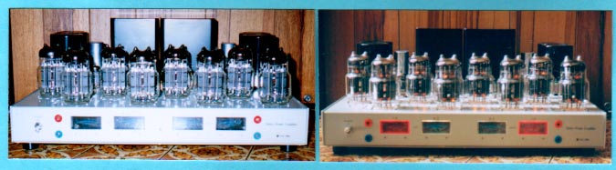

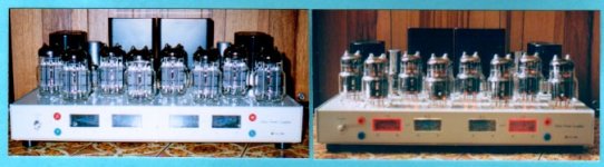

Since we're "talking" 6c33, try holding this lot down.:xeye:
I didn't want to pollute the othe thread.
OUTRAGEOUS OTLS
Thanks John.
I am curious to know how they drive a bunch of valves like the 6C33C.
Just imagine having an amp like that in your living room and one of the valves goes South....:xeye:
Gives me the creeps,I'll stick to my old faithful 6AS7 family of valves.
Cheers,😉
