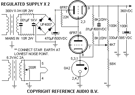

Since you mention the importance of PS and possible regulation of the driver stages of the amp (like Rozenblit's design), would you suggest a way to improve on Ciuffoli in this respect?😕
You could add a regulated supply like this one:
The self can stay but the xformer should have a secondary winding of 300VAC.
Naturally you'll need a xformer to heat the 6FR7 too.
I'd recommend one regulator per channel to avoid IMD.
Cheers,😉
