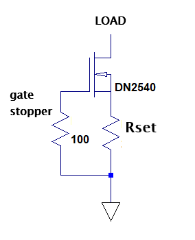

If you continue to have problems getting that 10M45S model to work, maybe you can try this DN2540 model instead.
Close LTspice, then.,..
Copy and paste that into your standard.mos file in \LTspiceXVII\lib\cmp\ or wherever you store your standard.mos file.
Then when you reopen LTspice use the device picker to insert an nmos symbol into your schematic, then right-click on the nmos symbol and choose DN2540.
Code:
.model DN2540 VDMOS (Rg=1 Vto={-1.52-4.5m*(temp-25)} Lambda=6m Rs={0.35*(1+3m*(temp-25))} Kp={800m/(1+6m*(temp-25))} Ksubthres=0.11 Mtriode=0.35 Rd={6*(1+3m*(Temp-25))} Cgdmax=10p Cgdmin=1p a=0.25 Cgs=100p Cjo=200p m=0.7 VJ=2.5 IS=4.0E-8 N=2.4 Rb=10 )

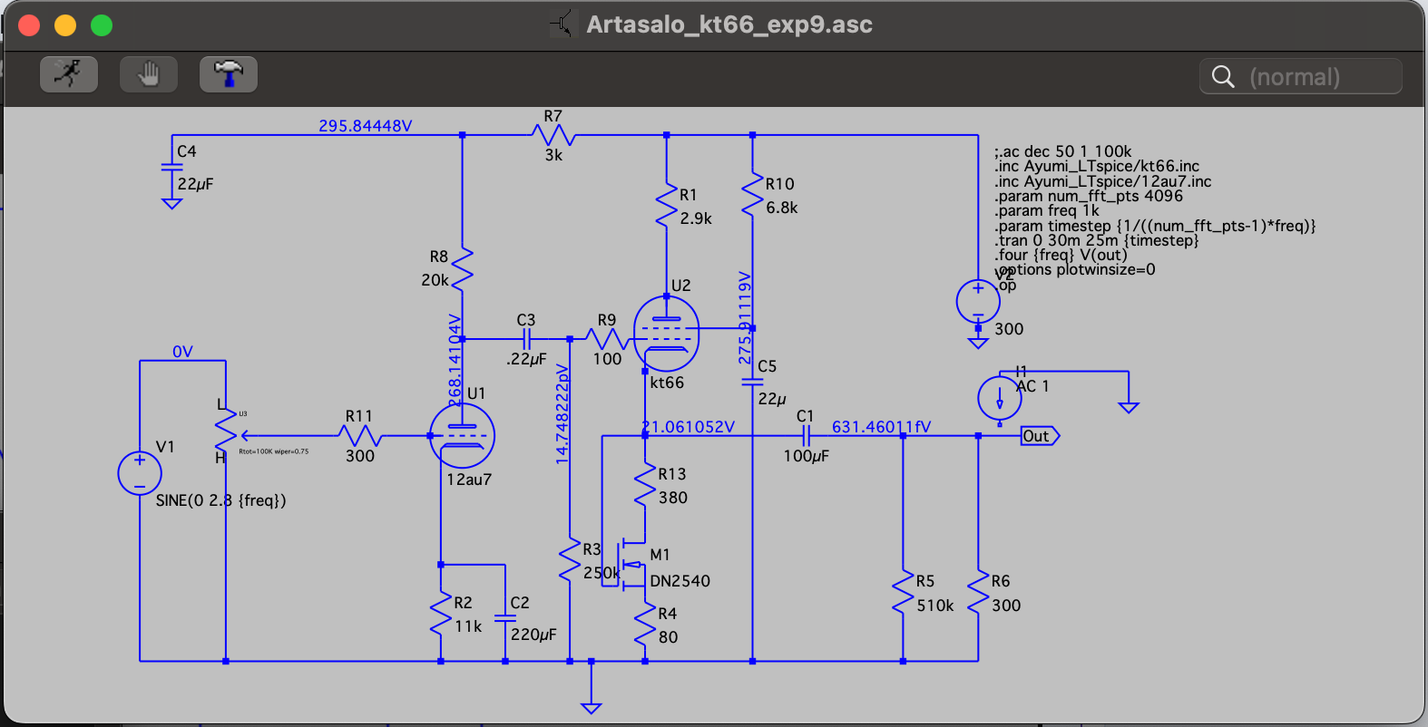

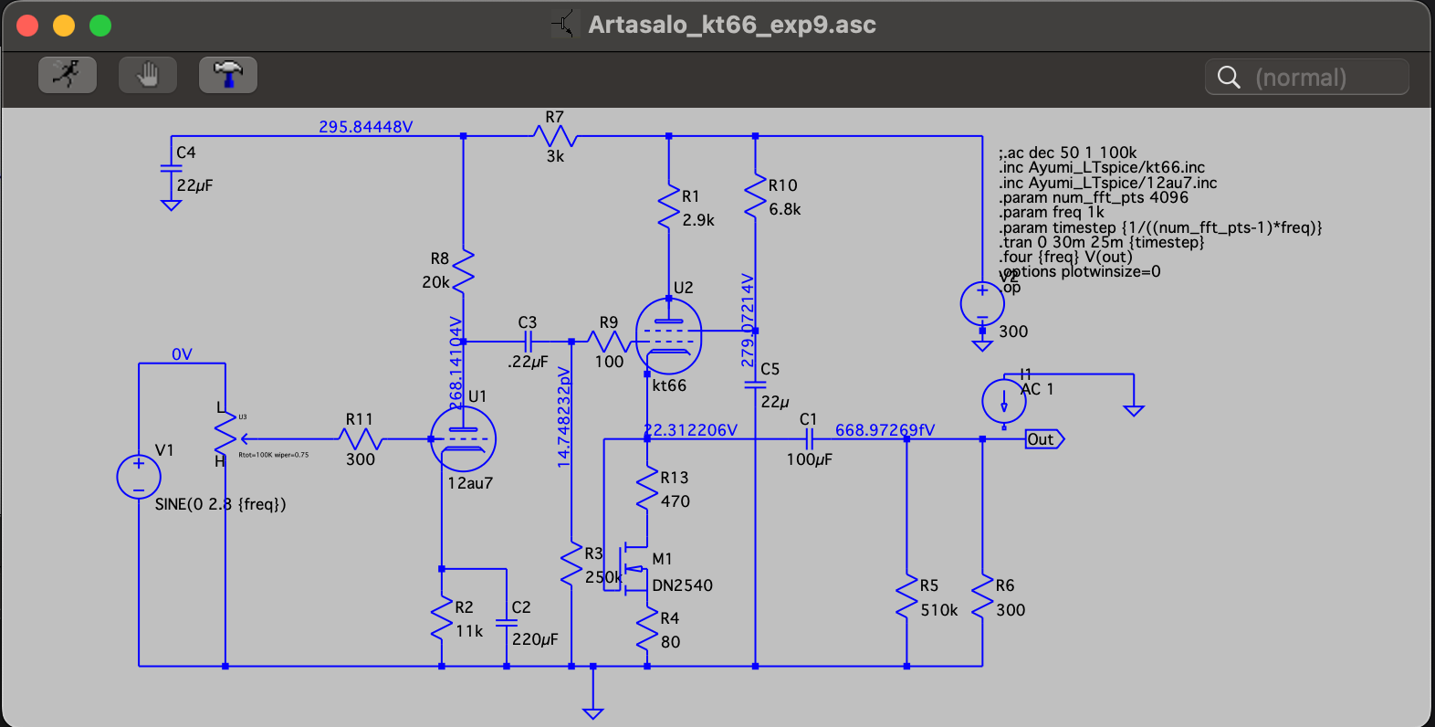

So set up this way:
I get basically identical results in terms of anode voltage/current, gain, and distortion. Would this make an improvement in sound quality on the real build? No idea. Though it'd be an easy thing to experiment with once I had it on the bench.
So set up this way:
Might need to add a diode. Honestly, still feeling my way this stuff and throwing things at the wall... which is a way of saying I barely know what I'm doing and appreciate everyone's patience.

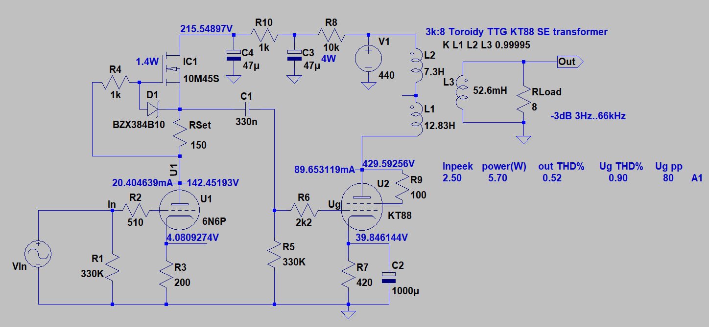

To @20to20 so this project was initially inspired by people using the KT66 in the OTL Feliks Euforia. Donald North Audio also uses a KT66 in a headphone amp, though that one is transformer-coupled. I appreciate the admonition to study more circuits but I don’t really understand the objection to this one. Why would the distortion profile be meaningfully different than the simulation?
To @rongon as I said in my first post this is explicitly for high impedance dynamic headphones, I have no interest in 32 ohm headphones for this project. In the simulation I get 95 ohms output impedance which is perfect for my headphones (and less than the Crack)
The thing that’s interesting about this project is to do KT66 tubes. If I wanted 6AS7, I’d just build another Crack.

1. I've never seen a DN2540 current sink wired up the way you have it. What is the purpose of R13 (380 ohms)?
2. Why is the gate of the DN2540 connected to the cathode of the KT66? Why not connect the depletion mode MOSFET's gate to signal ground, as is normally done?
3. What is the purpose of R1 (2.9k) in the plate of the KT66?

I hope you don't mind answering a few more questions about the proposed circuit:

Hi @rongon ,
I wouldn't take the DN2540 version of the circuit too seriously; I was playing around with doing a constant current mod to imitate the Speedball mod on the Bottlehead Crack, and I tried wiring it up to the output in imitation of this design: https://www.diyaudio.com/community/...with-12au7-and-kt66-tubes.427541/post-8012530 and it measured better than wiring it to ground (in the simulation), but I'm not sure this is really the way to go, and as I say I'm not sure it would even have a discernible difference in the output. (If you scroll back you can see a different design with the transistor going to ground with a different transistor that blew up the tube in the sim.)
The R1 anode resistor is there to prevent the KT66 from melting down as I explained here: https://www.diyaudio.com/community/...au7-and-kt66-tubes.427541/page-3#post-8010300 -- without that resistor, the anode voltage and current surpasses the tube limits when you turn up the volume, but with that resistor you can turn the volume all the way up without that happening.

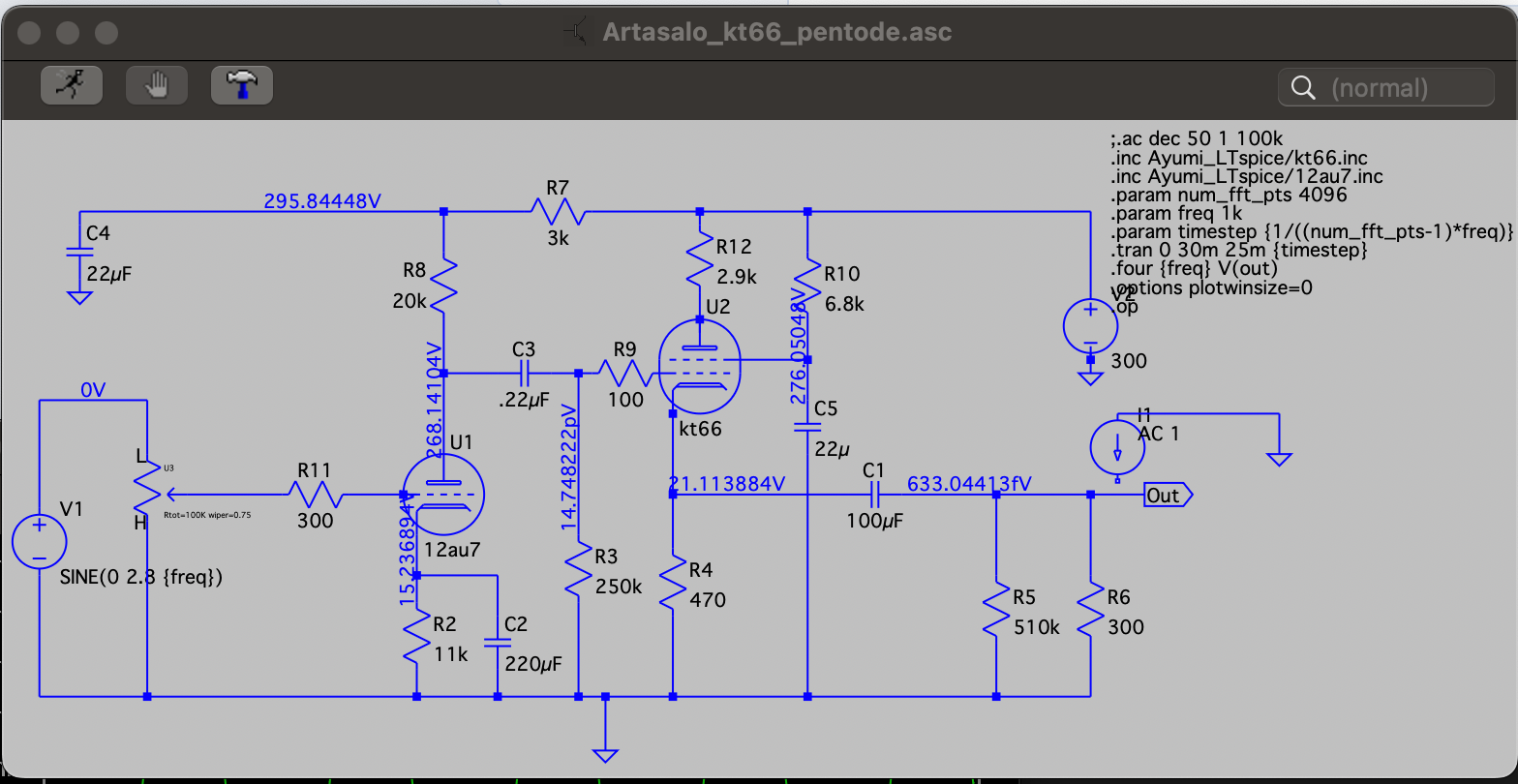

For reference this is my current "best" version of the design:
Which in the sim has 0.13% THD.

1. That R1 resistor is reducing the gm of your KT66, increasing Zout and worsening performance. It may be better to bias the KT66 cooler to prevent it from overheating at high output levels. It will still be in class A because the circuit is single-ended.
2. It looks like you wired the DN2540 incorrectly. A depletion mode MOSFET is a lot like a vacuum tube. In normal operation it needs to have its gate held negative to its source (like a tube needs its grid held negative to its cathode). The set resistor (Rset) is analagous to the cathode load resistor (Rk) for a self-biased vacuum tube.
If the CCS were to be used as a cathode load (current sink), the bottoms of R7 and R3 would go to signal ground. The drain of the MOSFET would connect to the cathode of the vacuum tube.
3. You wrote "Which in the sim has 0.13% THD." At what output level and into what load? Was that 1Vrms into 300 ohms? Or 1mW into 300 ohms?

Can you share your KT66 model?
I just whipped together a sim in LTspice using Adrian Immler's 6L6GC model, and got interesting results.
1. The 6L6GC plate-cathode voltage is only 170V.
2. The 6L6GC screen grid (g2) voltage is 270V.
3. The 6L6GC plate is only dissipating 7.5W. KT66 is rated at something around 20W plate dissipation (that's from memory, I'm probably off by a bit). You could use a 6V6GT there and get the same performance.
4. The THD I get at 1V rms output into 300 ohms is 0.38%, which is actually not too bad (which surprised me).
5. That 2.9k R12 resistor is burning hot, dissipating 4W all by itself. That seems to me to be a waste.
6. When you tested the circuit without R12 installed, how did you tell that the KT66 was overloading at high signal levels? How did you test that? What did you see?
When I short out R12 I see the 6L6GC plate dissipation goes up to 12W, which is still well within the limits of KT66, and is even within the limits of 6V6GT. The plate voltage and screen voltage are then both around 280V (which is fine).
7. The 12AU7 is running very current starved (Ip only 1.4mA), which means its rp must be somewhere up around 15k ohms. You put a plate load R8 of only 20k ohms, which is not even twice the 12AU7's rp at that operating point. That does give you low gain but it also brings high THD and possible problems driving the grid of the KT66 -- especially if it's wired in triode (higher input capacitance due to Miller effect). What led you to choose those operating points and parts values for the 12AU7?
8. If a design goal is to reduce the gain of the 12AU7 then why is its cathode resistor bypassed with a capacitor? Leaving that Rk (cathode bias resistor) without a bypass cap will introduce current feedback and both reduce the gain and lower distortion.
So if R6 is HP and not the amp's output Z, then that makes the output Z 470R pushing 300R. Not the right ratio, yes?
How did we figure the Zout is 470R?
Is that 1/gm of KT66?
...So I just gave it a quick check. Yes, in the sim I threw together the Zout is about 400 ohms. I would increase the gain of the voltage amp stage and wrap some parallel NFB around it to lower Zout to acceptable levels (which would also lower THD). You don't need super high input impedance. 50k would be good enough, since the sources are undoubtedly going to be either digital or a phono preamp.
Good catch!
Good catch!
It's the only significant resistance between the K and ground. I should say lowest R between K and ground.
Even with a CCS as the cathode load for the KT66 (6L6 in my sim), the Zout is only about 400 ohms.
I tested it by measuring a 1k sine wave output voltage into an open circuit (infinite load Z).
I got 3.4V peak out with 470mV pk signal in.
I decreased the load R until I got half the Vout (3.4V/2 = 1.7V).
That turned out to be about 400 ohms.
The Vout with a 300 ohm load was 1.4V.
