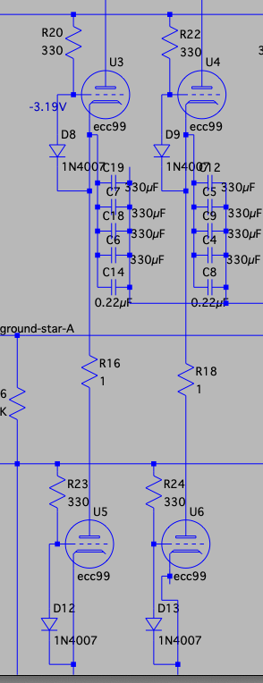

Hi Guys,
I have a rough and ready schematic here (LTSPice) attached.
This was done VERY QUICKLY on my break so save the critiques it is what it is, it may not be my neatest work but it is what we have.
I have ran it in SPICE but takes a while.
If you see anything obviously (I know have alpha brain and cannot see anything) then let me know or amend as required.

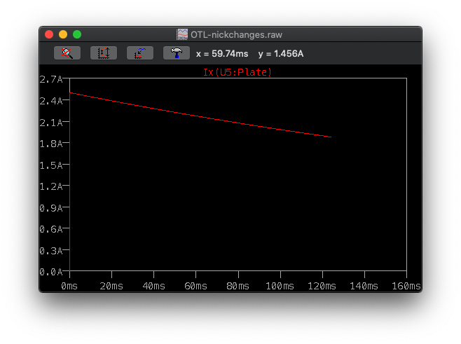

I put 400m ESR for the caps, 80m for the large electrolytic and 0.01ohm on the voltage sources, but after that:
You may want to setup the ESR for the caps you want to use.

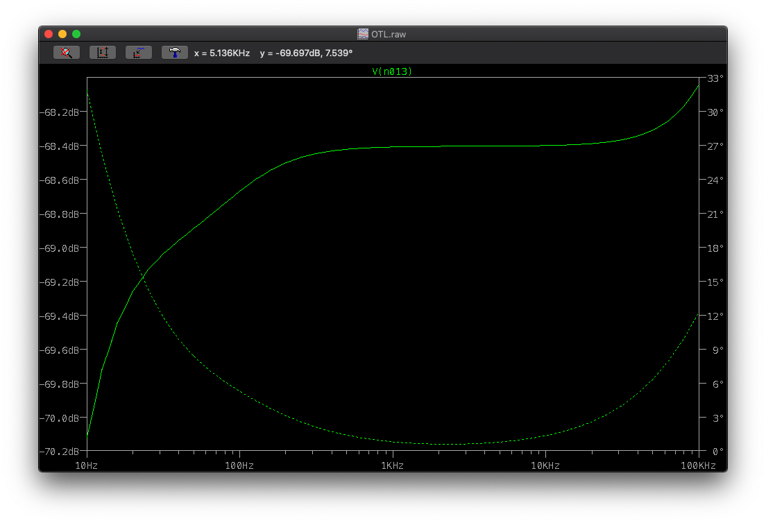

Hi Nik
What results were you getting without the ESR.
It wouldn't settle enough to allow a bode plot. Where I've seen this before it's because the ESR/voltage sources need at least something in there.
Thanks Nick,
I could see the 80v Spike at the load.

125mA MAX plate accords the data sheet, I think it may have overshot this, that is the 6080, and around 60mA for the 12au7 from memory
Also the load is 200Ohm+SPEAKER, there is a 5w 200Ohm Resistor tied across the terminal of the speaker
1. Missing grid bias resistor at the input
2. R16 22k is too low and draw too much current, est value 100k
3. NFB phase of this LPT stage (U11, U12) is reversed.
4. R23, R15 cathode res 2.2k bias is about 3.8V is insufficient to out 80V drive.
5. NFB to this stage (U9, U10) is reversed
6. No grid bias resistor for grid supply (78V and -80V)
7. NFB to LTP stage value is too much, sensitivity is low.
I attach the version I edited that sim properly, but do repeat check on the above areas again.

Hi Koonw,
The GBR 470k I missed
R16 is 22K
NFB reversed for you because you move input to from U12 to U11
R23 and R15 are 2.2k
Ditto
100K resistors grid bias on the grid supply - they were hidden on the power supply
The value are correct on the NFB to Long tail
I have checked the values again and they are all correct, I checked your version and it is not how it is in reality albeit your design does work.
I cannot comment on the original design as it Atillio's special number 1 OTL amplifier design.
An interesting discovery this morning, when I was looking at the amp, I lifted the 5.7Uf coupling cap and R14 (22K) was black! something has drawn a lot of current, looking at the circuit that leads to the output cap, just another little stinker to throw in.

The correction was based on your drawn schematic, I just comment that it's incorrect. I hope you only use it as a basis for reference. We don't know the actual circuit unless the designer publish it. As we don't find original circuit it's up to anybody guess. The photos you posted is helpful but not enough for us to duplicate the circuit on paper nor to double check for you.
