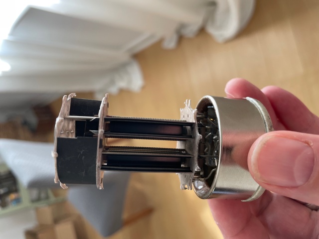

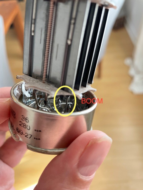

Now I have, within day one, attached the dissected tube image, I can verify that it is the upstand connected to the K1 pin, however, the once attached lead has now gone, I have no video evidence of this occurring however I think the image does empirically demonstrate the condition to be as told.
The 'event' which I have enveloped under the definition of the verb 'BOOM' or 'BLOW' was a large white flash which I presume to be ionised plasma (this is just my hypothesis given the conditions, my antithesis is that it was a marshmallow, I have yet to publish my work on this).
I do not have the specification for the amount go Torr inside of the tube, however I am just about at sea level where we live so we can assume an air pressure of 14.7psi outside of the tube.
I trust that the photographic evidence is of such quality you are able to deduce, as have I, that an amount of current greater than the failure tolerance of the material used to connect cathode to the pin has passed from the anode (or the grid) and as such, created a light show only rivalled by a Pink Floyd concert.

Since the connection between the cathode and the pin has melted, a lot of current has clearly passed through the tube. If it was my amplifier, I would fit a fuse on the anode on each tube before experimenting further. And buy a big pack of fuses. I would then connect a volt meter between anode and cathode on one of the tubes and another volt meter between grid and cathode and monitor the voltages when the amplifier is turned on. If you don't have two volt meters, go to the shop. It will be tricky to solve this blindfolded. 🙂
If the anode-cathode and grid-cathode voltages are OK and the tube still passes too much current then the heater to cathode insulation must have broken down. But, you wrote that the heaters were connected to ground so that shouldn't happen. To verify that the connection is still OK, measure the resistance between the heaters and ground.

Tubes can crack or shatter when a serious overcurrent flows through a pin where is passes through the glass. A miswired socket on a Russian 6S19P forced all the current an 8 amp 6.3 volt transformer winding could deliver through one plate pin into the tube and another out of the tube. This scattered the glass all over the bench.

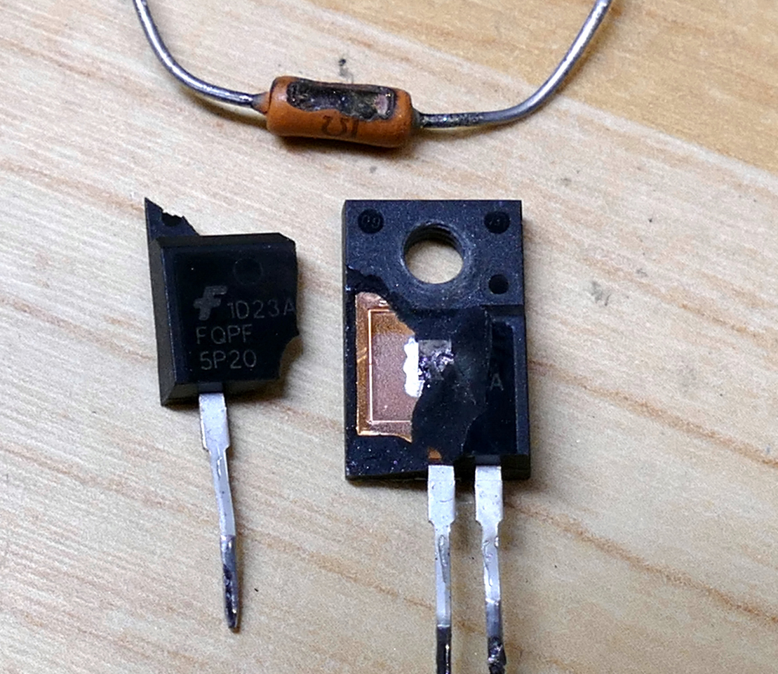

My biggest bang occurred while trying to curve trace a tube / mosfet pair with my HP6448B power supply operating at 650 volts. This supply is an old style 60 Hz switcher with 1000uF of output capacitance. When an error in judgement dumped all that stored energy into a mid sized TV sweep tube, it did literally explode.....and yes I have pictures.
There were actually two such dumm blonde experiments that ended badly. In the first case the tube simply flashed brightly, the glass cracked, and a few pieces fell to the bench nearby. You can see that the crack started where the plate pin (pin 7) passes through the glass. I assumed that the mosfet failed, so I put in a bigger fet and tried again. This time there was a much bigger bang with scattered glass and mosfet parts all over the bench and floor.
The plate pin was permanently welded into the socket. The rod from the plate to the glass is visible in the picture, but most of the link that passes through the glass was vaporized causing the glass to shatter. Autopsy revealed a tube arc resulting an a small loss of cathode coating. It is still not known whether the tube or the mosfet failed first. If the fet shorted (the usual failure mode) it would remove all bias from the tube resulting it trying to eat all the stored energy in the power supply.
This was a tube rated at 24 watts plate dissipation. I was planning to test it up to 50 watts or more, but a dumm judgement error actually applied 350 watts. I have seen 40 watt tubes eat over 600 watts for a few mS, so I still believe that the fet failed first. A subsequent test on a similar tube alone showed that it could indeed survive brief tests at over 100 watts, but I did not go past 100 Watts.

The tube I uploaded was not in this condition when it happened, I delicately removed the glass to preserved the internals.
I used a diamond wheel for most of it and then the rest just fell away

Maybe. 😕attached the dissected tube image,.... it is the upstand connected to the K1 pin, however, the once attached lead has now gone ..... I think the image does empirically demonstrate the condition to be as told.
