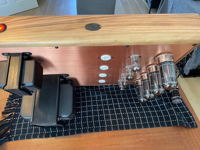

WHAT exploded?Hello Guys,
I have an odd one, 6080 OTL amplifier, I plugged in a new preamp and it blew all of the tubes (they exploded) on both channels.
Filaments?
Plates?
Molten metal inside tube?
Shattered glass flying all over the place?
Pictures please.
Did you blow another set of tubes?So, changed the coupling caps, same thing,
Again, pictures.
🙄I have NO schematic nor values, but I have the spec sheets for the tubes (EEC82 Driver 6080 Output), I know that too much current is passing to the K1 K2 but I cannot work out how...
Pictures please.I say this as I dissected one of the tubes and the connection from the K to Pin has gone.
Please pictures of the exploded tube remains.Also, I put in a 6080, turned it off then on then off then on and bang... same again.
Glad to help but we have ZERO data to work with.Any help would be great, I am scratching my hair away.

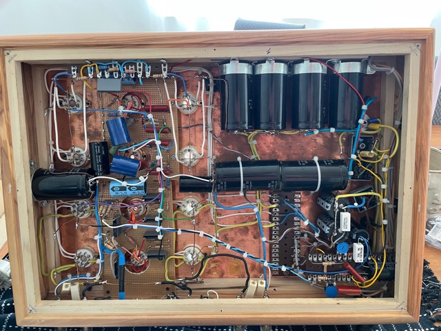

Can you attach a photo of the underside of the point to point? We should be able to spot some gotchas.

There are 4 6080 per channel, top 2 measure 160VDC to GND, K1 and K2 are tied directly to ground on this half and Bottom 2 measure 160VDC to K1 and K2 respectively. -75VDC is solid on both channels.
There is a ground wire from the 6.3VAC rail to the filter caps of the B+ so there is a short from the winding to GND, but that is not new.
I am going to put a load on the speaker and see what magic occurs......

I don't think you can say without an osciliscope attached if it's stable. Probably worth draining out and then checking the resistance of the output capacitor (I assume it has them). If it's direct output (ouch!) then it's the tube bias out of whack.
If the operating point is out of whack then a signal could cause an overload but typically class A would simply have a problem idling and not be stable. Which is why I'm thinking that there's some thing causing either (a) a bad operating point or (b) a bad input on the grid (ie operating in an unintended A2 due to a DC leak).
All of this is hearsay - can you upload a photo (amp and the inside P2P wiring). It allows us to understand what is connected to where and if there's component failures.
The only way a speaker would cause a OTL to fail is if (a) the speak is a short and there's no isolating output.
The picture would also show us if it's a straight push-pull power or a circlotron but the latter shouldn't (in theory) cause the other tubes to die.

I most certainly bought this from Attillio, it was an amp he assured me was their state of the art OTL..............
Please take a look at the images attached, Tektron is not exactly world renowned fellas and I do not think the Chinese would go to any length to copy the design.
Anywho......
Let us not get drawn into such arbitrary matters gentlemen, the battle front is not between us, it is on this god damn amplifier!!!
Note the blue caps, Jenzen 5.4uF, the old ones were RSPRO nasties..
