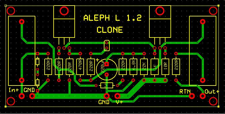

Good morning Mads!😀
Nice schematic! What do you think is it works?😀
I think I will try to build.
Thanks!!!
Greets:
Tyimo
Thanks!!!
Greets:
Tyimo
Is your PCB designed for standard parts or for SMD?
If it is with normal parts I coud test it for you and for me!😀
Tyimo
Tyimo
It is a mixed mixed technology board. How about if I mounted the SMT parts and you mounted the PTH parts and tested it? Do you have a oscilliscope and signal generator?
I havn't got, but my friend has! So, I could test it...
