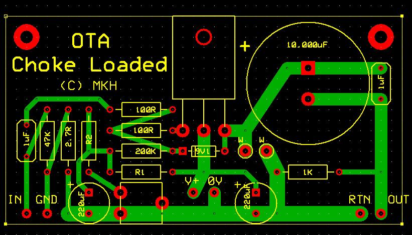

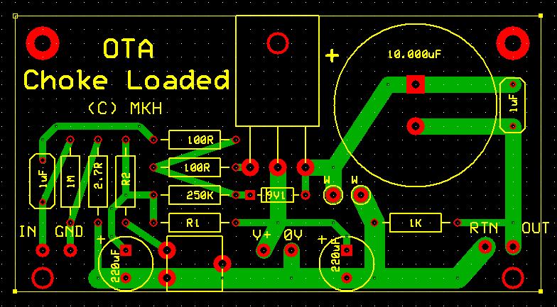

Looks good Tyimo 😉
-Do you have a pot in the bias network?
-The impedance seen from your source is the paralelled value of the input bleeder resistor to gnd and the gate bias resistor. If you want 200K Zin, you must use 1M bleeder and 250K gate resistors. How about mounting holes on the lower side of the pcb?

Hi Mads!
Thanks for the suggestions!🙂
You wrote one time to me : "Input impedance is essentially the resistor from the voltage divider to the gate (100K)." ?!?
As you wish my Master!😀
I have the trimmer pot in series with R2 (in the voltage divider, down to ground) to get the adjustable value for different bias voltage. Isn't it enough?
Greets:
Tyimo
Greets:
Tyimo
