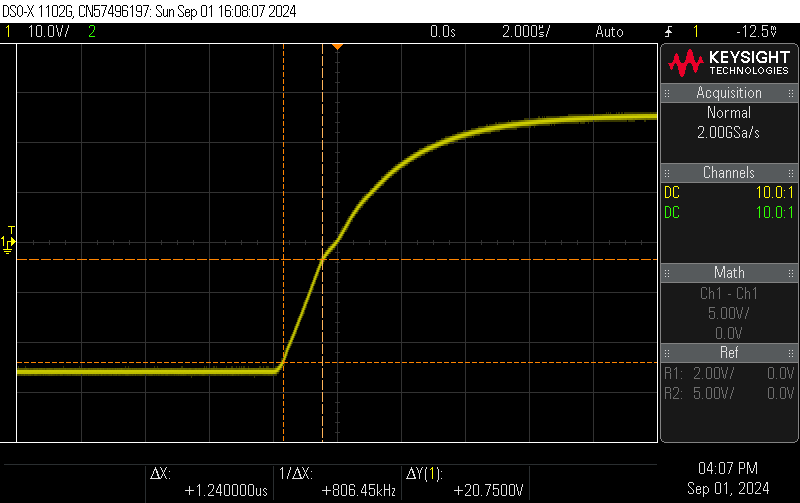

For the analogue delay line, I never bothered to figure it out. Never had a need. It was designed so you didn't miss the waveform at the trigger point. For those who haven't seen a delay line, it is usually a coil of shielded wire inside the scope chassis. The amount of delay wouldn't be very long at all. Useful only at very high sweep speeds.
For sure! I am more used to seeing the display begin on the left, not center. Curiously the default for most digital scopes is center.
I have used it set to both center and right if I was most interested in what happened before the trigger. This isn't the normal case.
Yup. You gotta know your tools!

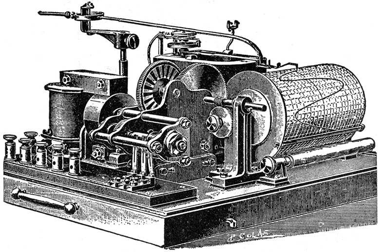

This is an early storage oscilloscope.
All oscilloscopes offer storage. The first were on paper/drums, CROs store by the persistence of the phosphor coating on the screen (otherwise we would see nothing at high sweep rates) and digital stores in silicon for as long as we want.

What's your point? You've gone off on a tangent with that.
We call those chart recorders, not oscilloscopes. I had to certify those as well. More than familiar with chart recorders, are you? There is nothing wrong with the normal definition used by most people between the two types of waveform viewing instruments, three adding your mechanical one. Feeling good about yourself now?

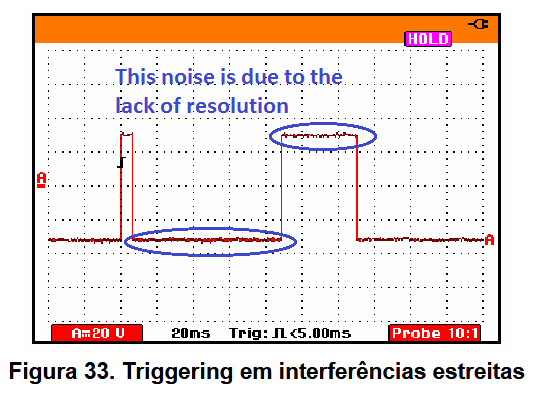

Being 8-bit based, keep in mind that there are 256 levels, so S/N or distortion observable level is around -48dB or 0.4% in voltage.
Also, the display has limited resolution (not as good as a high end smartphone or workbench good oscilloscope, for example), so, if observing some "noise", you will not be able to know if the noise comes from the signal or if it is just lack of resolution.
If what you need to observe is very low level of noise, then this equipment is not appropriate.
It's not a lab equipment for observing minimum details such as 0.001% distortion, S/N -90dB measurements or things like that.
But, as long as you know the limitations, you can do a lot with it.

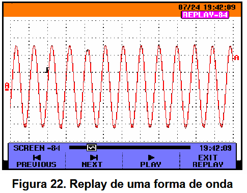

From the user's manual (comment in blue is mine):
The graph below is probably showing a perfect smoth sinewave signal, but the lack of display resolution will show the sinewave as a non smoth trace.
As long as you are not worried about smothness, no problem.
On the other hand, if you are troubleshooting a sinewave inverter and want to observe the superposed high frequency (let's say 40kHz) over the 60Hz sinewave resulted from the low pass filter, then you need a better resolution or you need to filter out the 60Hz first and then amplify only the high frequency. The creativity and experience with circuits can help to overcome some limitations.

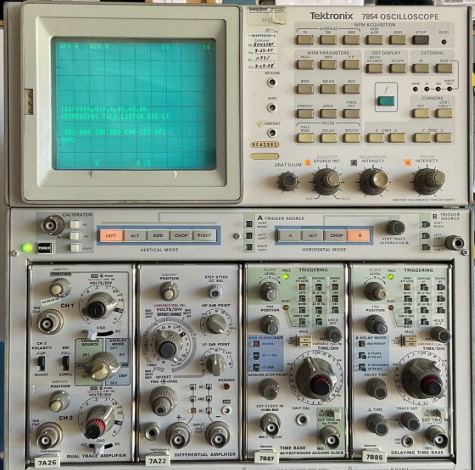

All of my bench equipment at home is anchored together with GPIB firehose, enabling computer control. Obviously, you can't do that with an analogue oscilloscope...
Yes you can. There were several hybrid scopes early in the digital era. The Tek 7854 below is an example. Its max sample rate is 500 KHz but it can capture the screen at whatever the plugins can manage (mine stop at 12 GHz) and share via GPIB. (I have one for when my Siglent 1204-XE is not adequate to the job).

@1audio: I swore at an early hybrid 'scope in mid-80s. It was a Tek, although not nearly as fancy at that 7000 series. The ergonomics of using its digital department were appalling. We also discovered that its B time base was triggered after delay rather than running after delay, or perhaps it was just erratic. That caused a lot of grief when timing PAL video into a vision mixer. Nobody trusted that 'scope after that discovery. You have to be able to trust your test gear...
  • Thank You
Reactions: anatech
I've never sworn at an analogue CRO, but I have sworn (under my breath of course) at DSOs.
You have to have both (at least one of each, maybe more...) in your lab. Thing about a CRO is the controls are always where you left them and visually obvious, usually logical. You can operate them with your eyes closed. But DSOs have more "menus" than a large restaurant, rotary encoders and 'soft' buttons. I'm just old-skool I think.

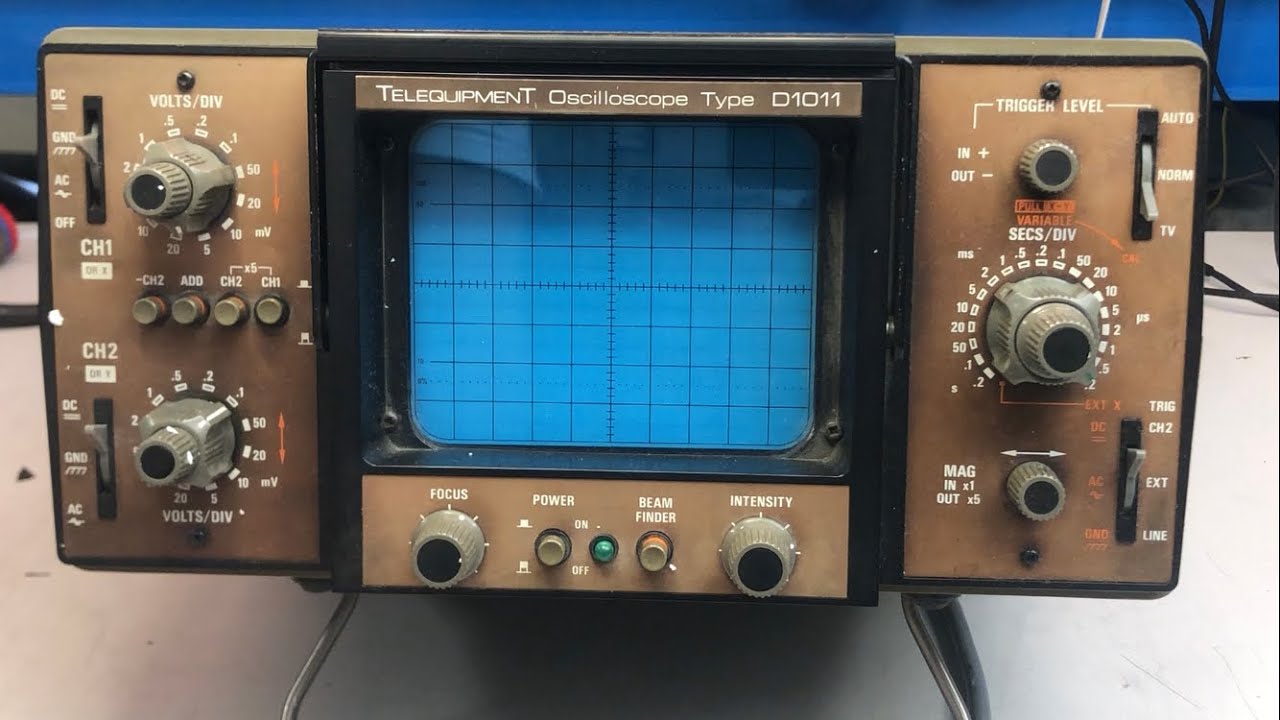

Its a telequipment D1011
That's almost the 'scope I bought for £35 (mine didn't have the x5 gain switches). Twiddle the "TRIGGER LEVEL" control to see the sloping edge. Be careful not to overstress those four lever switches at the corners. Inside is a little gold-plated beryllium copper wiper that operates directly on gold-plated PCB contacts. It's secured to the plastic by two tiny studs that easily break, stopping the switch from working. The wiper can be Araldited to the plastic when those studs fail, but it's a fiddly job because you have to unmangle the wiper first and work out where it should be.
