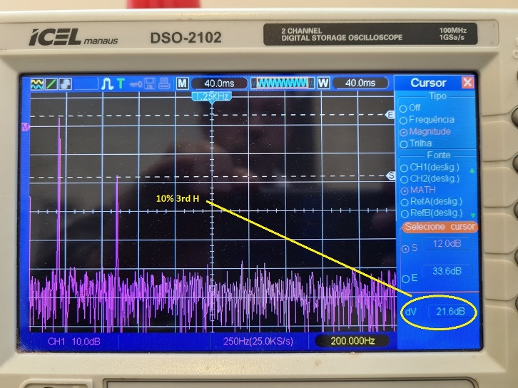

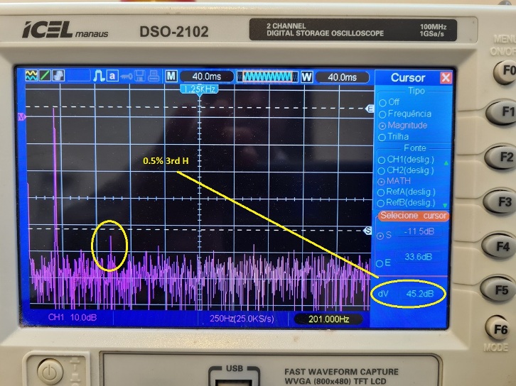

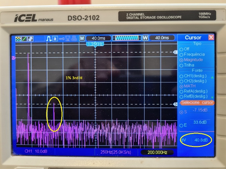

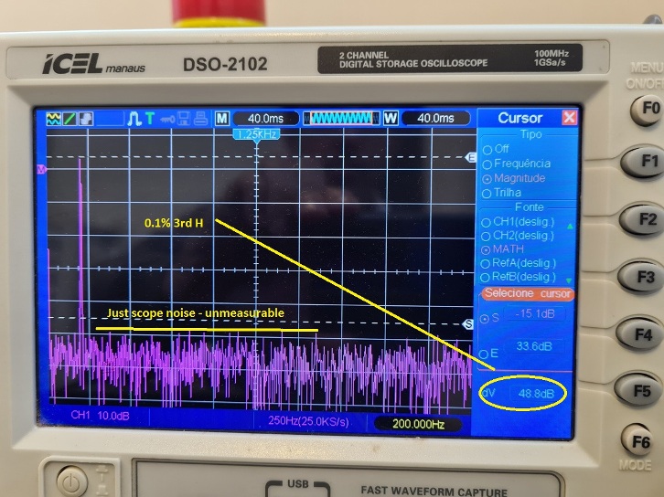

No measurement equipment is perfect and all have their limitations.
If the limitations meet your needs, you are good to go even with the cheap ones.
Example of my case. I have a very entry level 8-bit scope (Hantek rebranded to a local vendor) and I play with audio and switching circuits most of time,
Using only the bare scope, I'm limited to 48dB (or 0.4%) measurements. Any other more precise measurement, I perform using other means, such as adding filters, pre-amplifying the signal to rescale it etc.
To get used to my scope, I've prepared several sine wave files in 16bits/44.1kHz using Audacity with different harmonic distortions.
I added 3rd harmonic 10%, 1%, 0.5% and 0.1%.
Then I've played these files back and measured them with the scope. I could see clearly what the scope was or was not able to measure.
See below: I can measure 0.5%, 1%, 10% distortion, but I cannot measure 0.1% since I reach the noise level.

Yep. Oscilloscopes are not precision instruments. Keep in mind how they're used: The operator reads the waveform height or zero crossing points manually off the screen and compares with the graticule on the screen. A good operator might be able to get better than, say, ±1 % precision that way, but forget about umpteen digits of precision.
If you want to know the amplitude of the signal, use a voltmeter.
If you want to know the frequency of the signal, use a frequency counter.
If you want to know the distortion of the signal, use a distortion analyzer or spectrum analyzer.
Etc.
Unless you're happy with the 60-80 dB dynamic range commonly offered in a digital scope. And forget about reading anything but gross distortion on an analog scope.
That said, a scope is incredibly useful for showing wave shapes and that can be very helpful in debugging of analog circuits.
