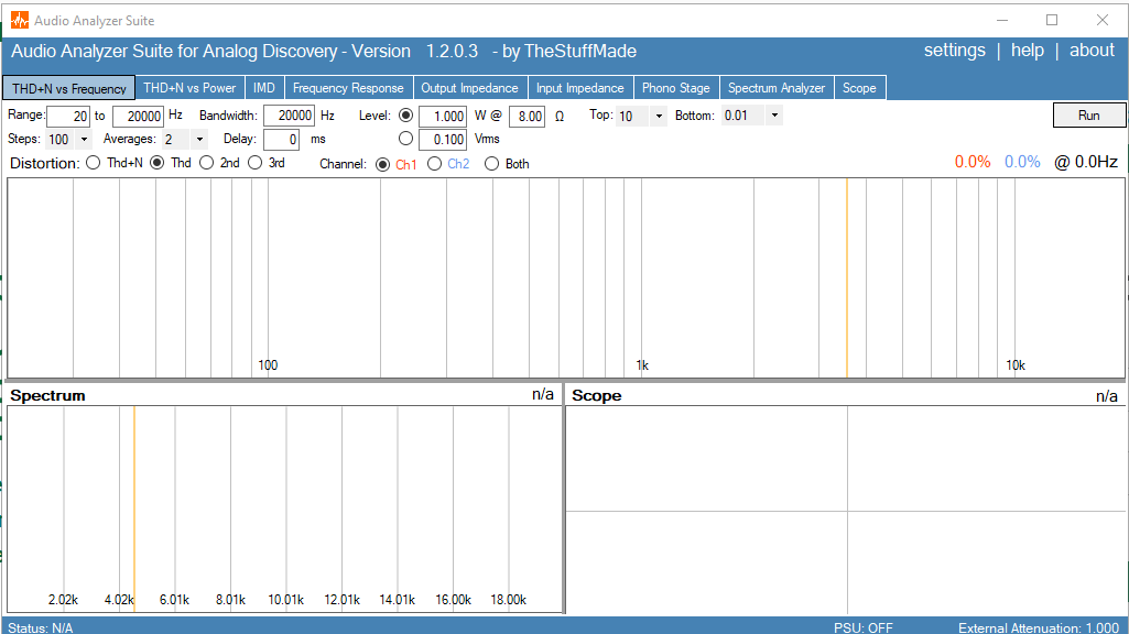

I have one AD2 I find it very cool device, sometimes I use it with this little software, Waveforms software is great too.

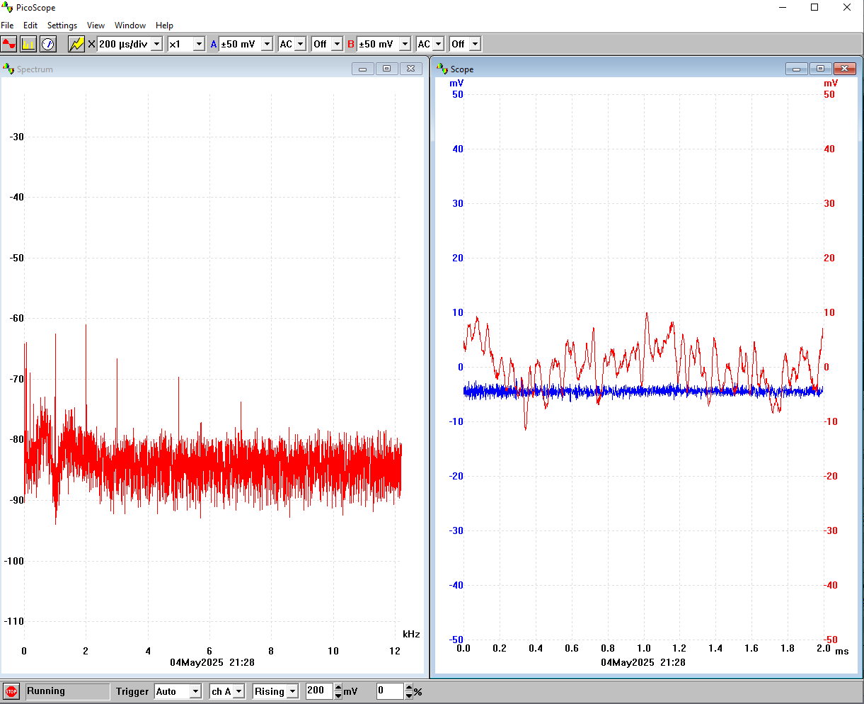

Last I looked at them I wasn't impressed by the front-end of those things. I think the lowest V/div (highest sensitivity) was around 100 mV/div. That's not very useful in the analog world. But it's possible that they've improved since then. You'll want something in the single digit mV/div ideally.
Tom

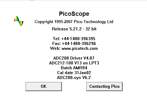

I'm not sure which variant you were looking at. Below is a vintage 12 bit Picoscope using a parallel port interface. Its at least 15 years old and the software is maybe 20 years old. Its still 10 mV/division with lots of detail. 8 bit is the same. The 16 bit I have is limited to 166 KHz (unlike the 12 bit at 1.5 MHz and the 8 bit at 50 MHz). Higher gain on a wideband system just means a higher noise floor. Thats why I have a 7A22 in close range. For looking at the output of an AP 1.5 MHz is more than adequate.
I can provide advice on getting a parallel port scope working on Win 10. However The USB interfaces are lots more flexible and supported by the latest software. Still for general troubleshooting a PC scope is klutzy. I pushed the Pico guys at a trade show about adding a knob. They said the boss is adamantly against it. I feel similar wanting a knob about the Quantech interface and AP interface. However for graphing etc. PC interfaces are fine.

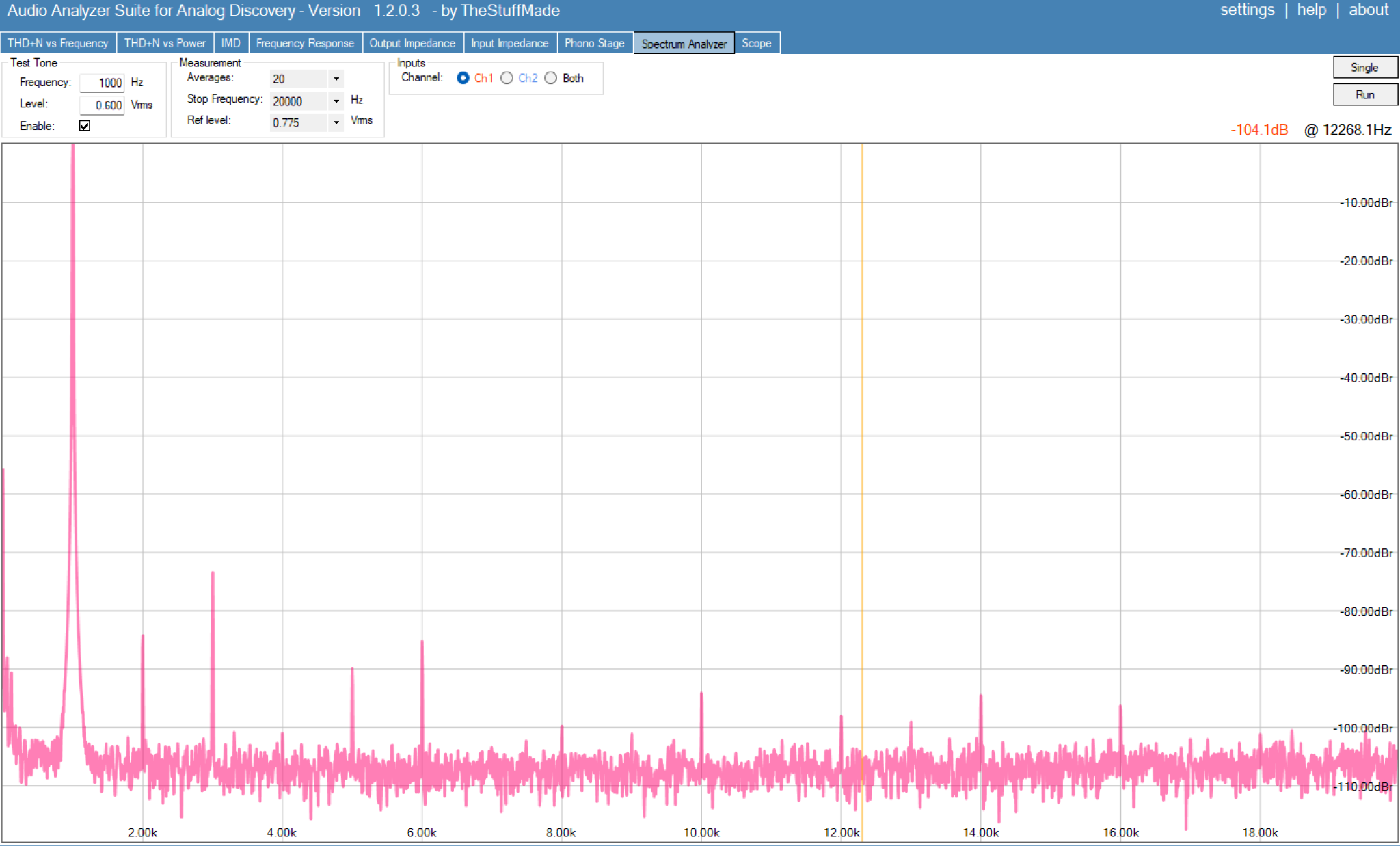

@Hipocrates, Thanks for posting the audio analyzer suite software for the AD2! Here is the AD2 loopback (through scope probe, though) harmonic spectrum and noise floor. Good enough for me, but definitely not for measuring state of the art (or even 1980s state of the art) amplifiers. H2 is at -84 dB, H3 at -73 dB.
