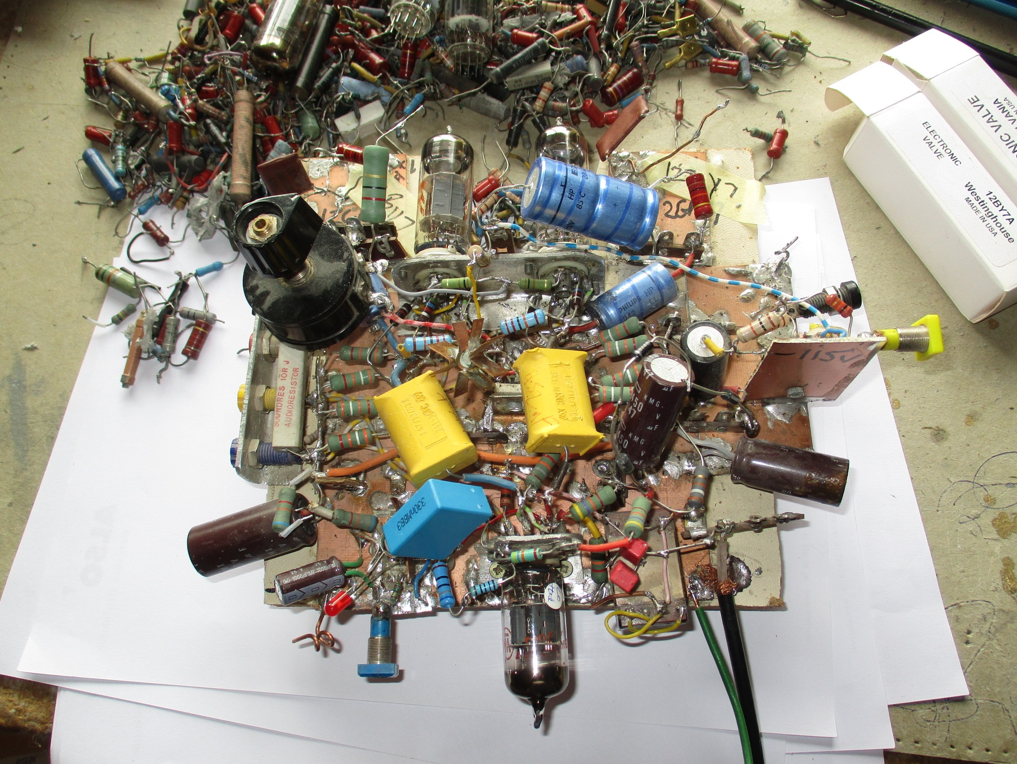

However, my dummy test rig is set up just with front end and cathodyne driver using simulated loads for pairs under test, the duff and horrid spec ones can be quickly weeded out.
Home checking for characteristic tube match with pentodes connected as triodes and balance, apart from measuring anode voltages, a scope probe on the joint cathode (CCS connection ) will see 2x f at quite low amplitude perhaps not quite equal despite the cathodyne outputs being equal. The neg CCS in this instance does a grand job. A 1Khz as an input signal will appear on the CCS as 2Khz or act as doubler at quite low amplitude. The symmetrical amplitude or equality of the waveform is the one to take note, and swap tubes, label accordingly. Later, as part of the power amp mainframe I modified by breaking the joint cathode by fitting degeneration resistors in each cathode leg which adds local feedback. It´s all in the Radiotron Handbook, nothing new under the sun.
I am not particulary tidy worker, but this pie looking test rig modified so many times has been with me for nearly 55 years. The black colvern pot, silvered mica caps, and tubes are all from that exciting era.
Keep at it !
Bench Baron

The output stage distortion contribution in a Williamson is significantly more than from the driver stage, but that said, a 6SN7 typically has noticeably lower harmonic distortion than a 12AU7. It could be worthwhile doing apples to apples HD comparison of the driver stage when trying alternative tube types, or even circuit configuration changes. The driver stage in the Williamson is designed not to reach grid-conduction limits, so as to maintain the loading balance of that stage on the cathodyne out to many hundreds of kHz (assuming a reasonable layout with only minor parasitic capacitance coupling to chassis of wiring and coupling caps).
Agreed, 12AU7 thd noticeably worse than other comparables and yet it revels in Philips amp circuits. That tube for me is a dead end.
Morgan Jones gave it also a thumbs down. Some years ago with my standard jig I did a comparison of various B9A minature pentode output tubes configured as triodes with Pa 6-12W ratings specifically as balanced drivers in mind, exactly over the distortion issue. 6CL6,6CB6,6CH6 12H/G and loads more ex video stuff and so on and found the distortion didn´t vary a great deal but their gain with a given anode load was the dominating factor. (Replacing the resistive anode load with a CCS resulted in a perfect 4-15MHz oscillator). Obviously, casually mentioning this without figures, currents and so on isn´t scientific, but instant plug in results from the 12BY/HG group put me in the desired direction. It is time consuming changing connections as some have center tapped heaters.
