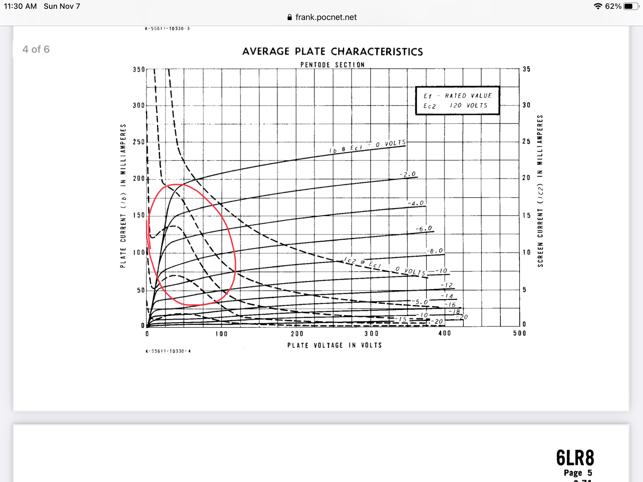

In order to get RF oscillations for one just needs a poorly damped resonance and a source of energy. Anything the universe can do to dump energy in some place other than where it is desired - it is going to do it. If the load impedance goes high enough and driven into hard saturation (which is good for RF efficiency and also what happens with Jimi Hendrix’s guitar Playing) you simply put the screen into its region of negative resistance.
Its not the “cut off” tube that does it - it’s the other side actually, where it’s driven below the knee.
This isn’t the 807 specifically, but all beam power tubes do this. To various extents. With “audio” tubes the plate characteristic has a kink there and the screen doesnt (or has very little). With sweep tubes or RF amps it’s the screen that has the kink and the plate is clean.
With solid state the mechanism is different but results are similar. And sometimes VERY hard to get rid of it.

I have noticed that some Kinkless Tetrodes (KT tubes) have negative resistance in their curves.
So much for 'Kinkless' (perhaps Less Kinky?).
The Kinkless Tetrodes employ Beam Formers (KT66, 77, and 88). Including the filament/cathode structure there are 5 tube elements.
Sometimes it is the Screen curves that are Kinky; and sometimes it is the Plate curves that are Kinky too.
Check out the plate kinks in some the graphs of the KT88. Link:

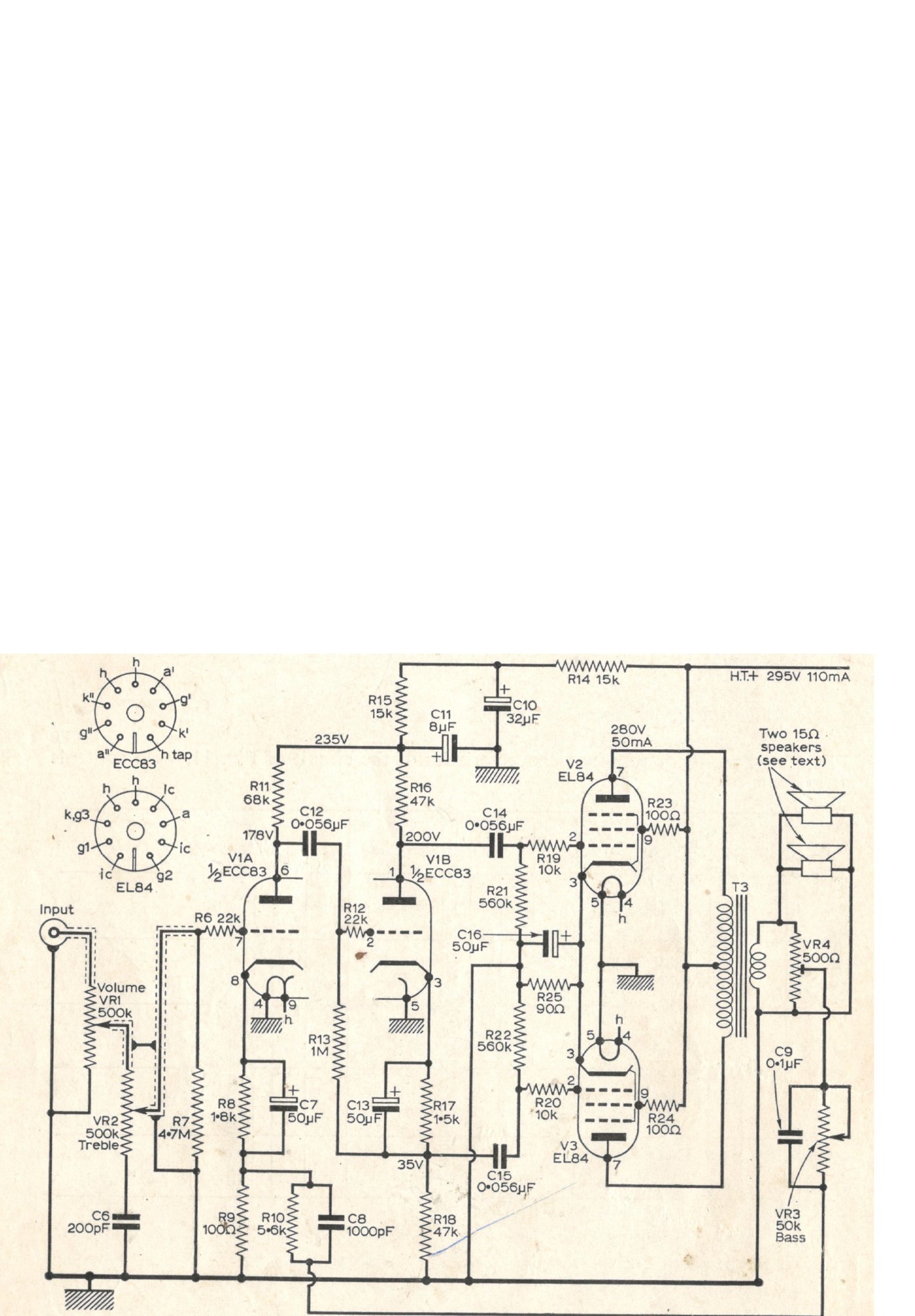

It may seem an irony, that even though I am a long time curator of parallel push pull, one would think fewer primary turns is beneficial, in terms of increased bandwidth, yes; lower winding resistance etc, and with less parasitics generally, but as the frequency bandwidth goes up, so do the problem issues. As others rightly mentioned, the amp stage layout must be absolutely sequential with the output sections and wiring well away from the inputs. Even that global feedback connection must be shielded raises another problem.. Amplifiers in the higher power class, typically my 50W-200W parallel KT90 P_P switchable from 300V to 600V confuses many stability diagrams, that in reality I settle on my long experience which often uses an anode to anode snubber...(this requires top grade components). One of the reasons I
don´t submit circuit diagrams.
Although the output tranny may have an excellent bandwidth to 70Khz or so, in the real world the sound fidelity is excellent, I often settle and trim for 40khz for peace and quiet.
In attachment, an excellent sounding small amp that was on the verge of violating operating conditions I once listened to, was a class A red hot glowing EL84 amp from an unknown record player which used the bass control in the global feedback loop. Plug in a second speaker and it oscillated. constructors be wary of this type of design that enamated around the early 1960´s: Simple, but it can also make one howl of protest !
