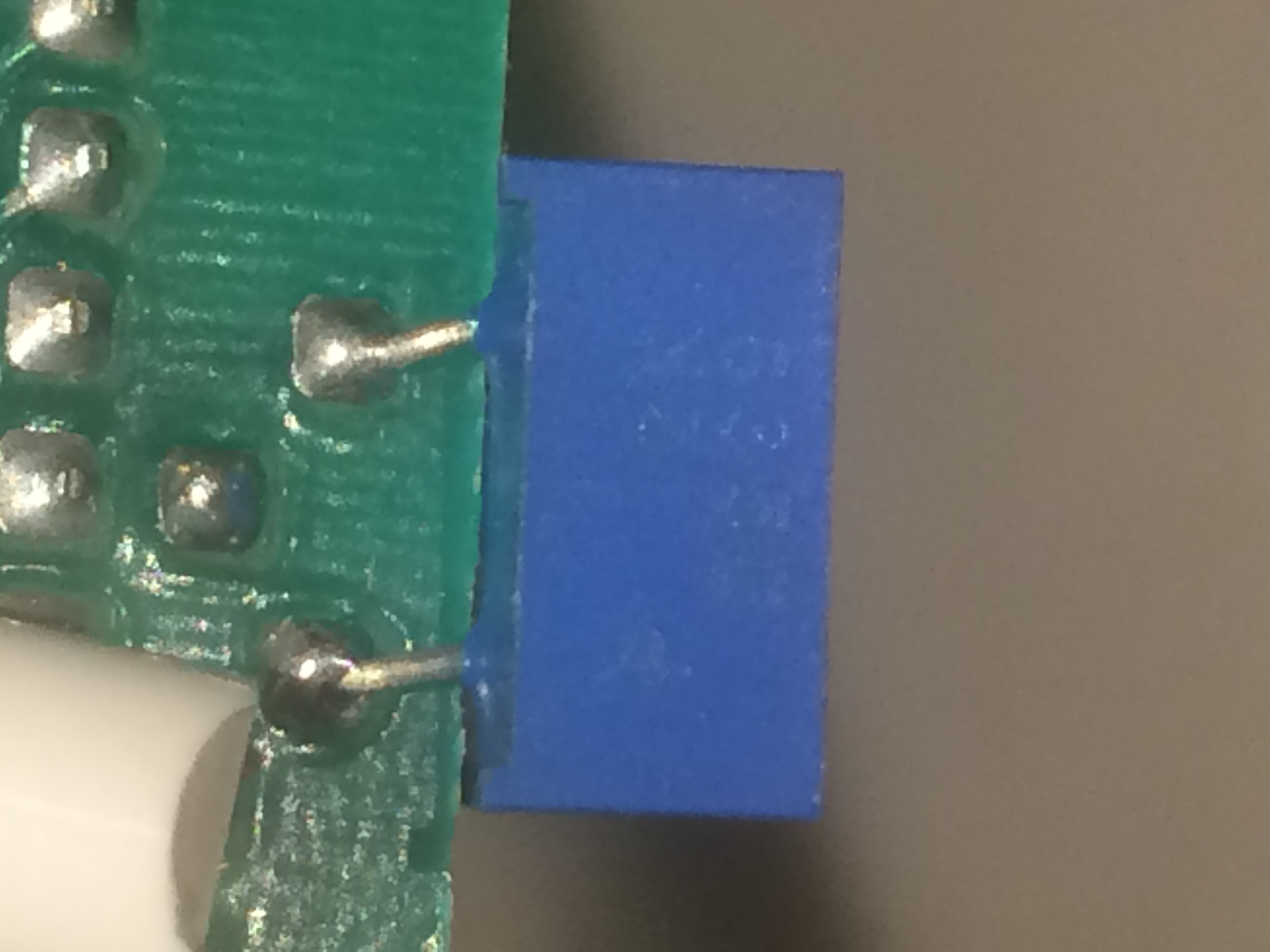

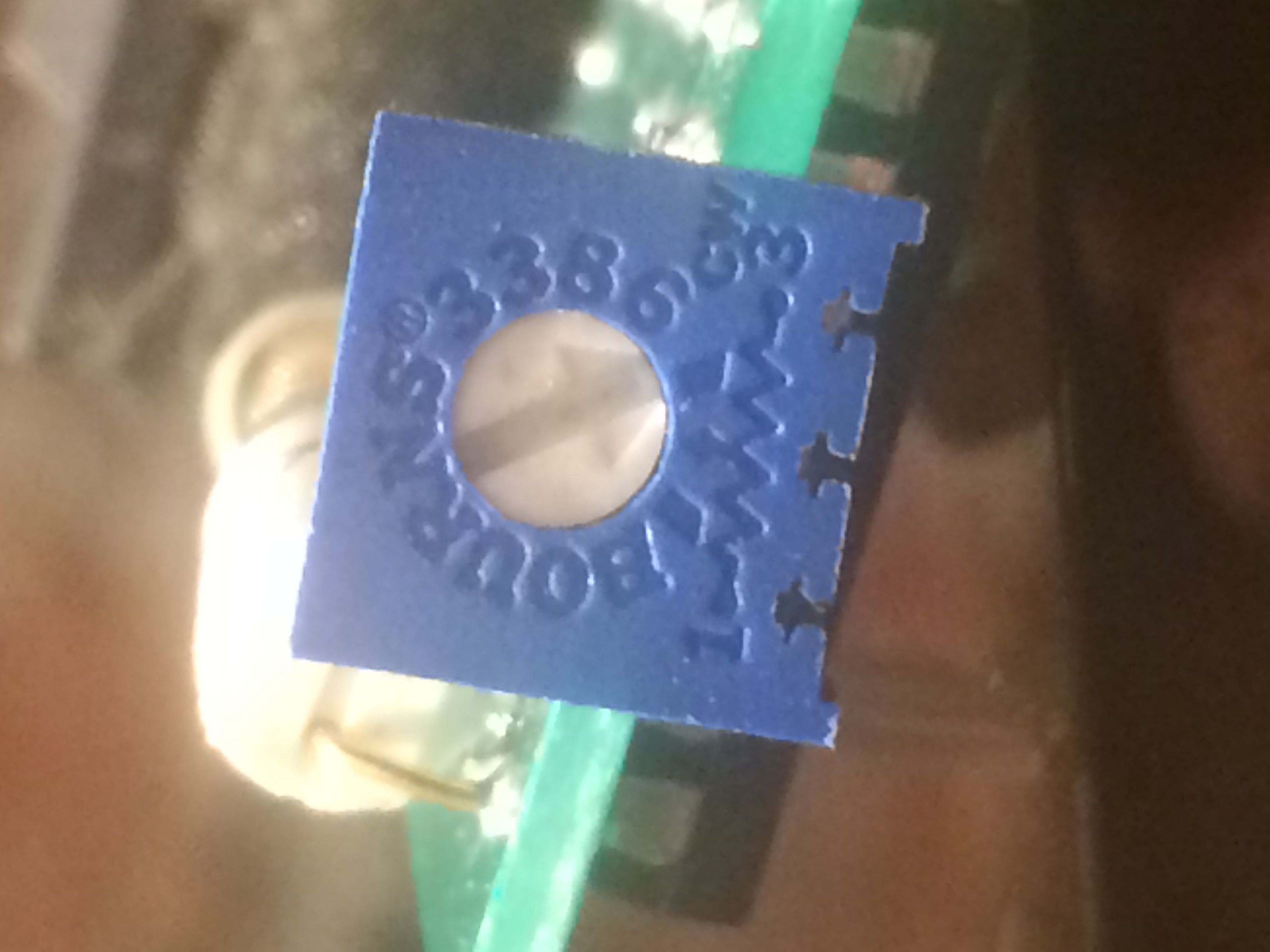

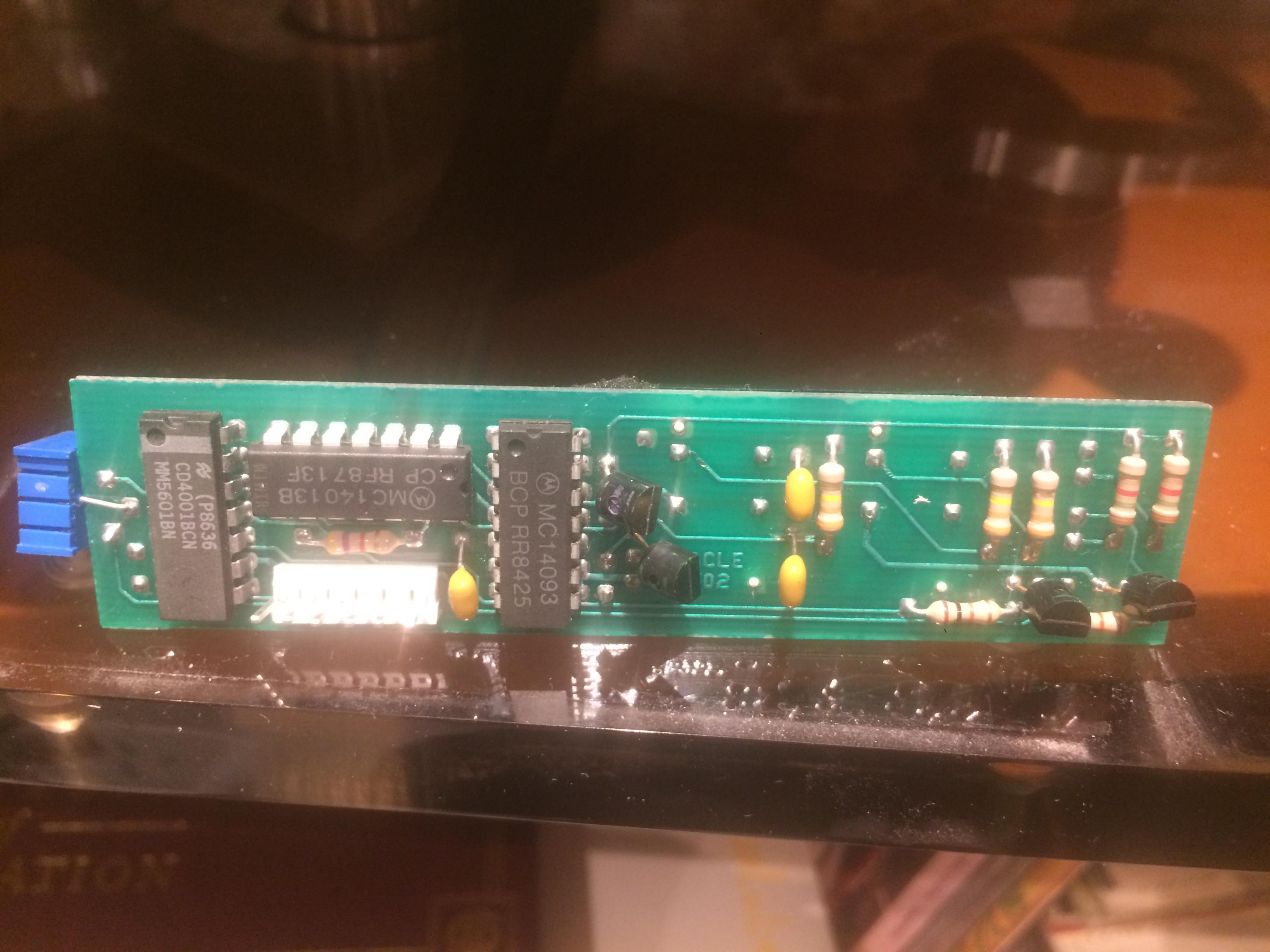

Delphi 3 speed pot meter front panel
Here is the Bourns 3386 2kOhms pot meter located at the front PCB at the panel containing on/off and 33/45 switches. See also https://www.bourns.com/pdfs/3386.pdf .
This is a cermet high quality pot meter. I am unsure about the gain of replacing this. But I wanted to show you the pictures as I have opened the front panel.

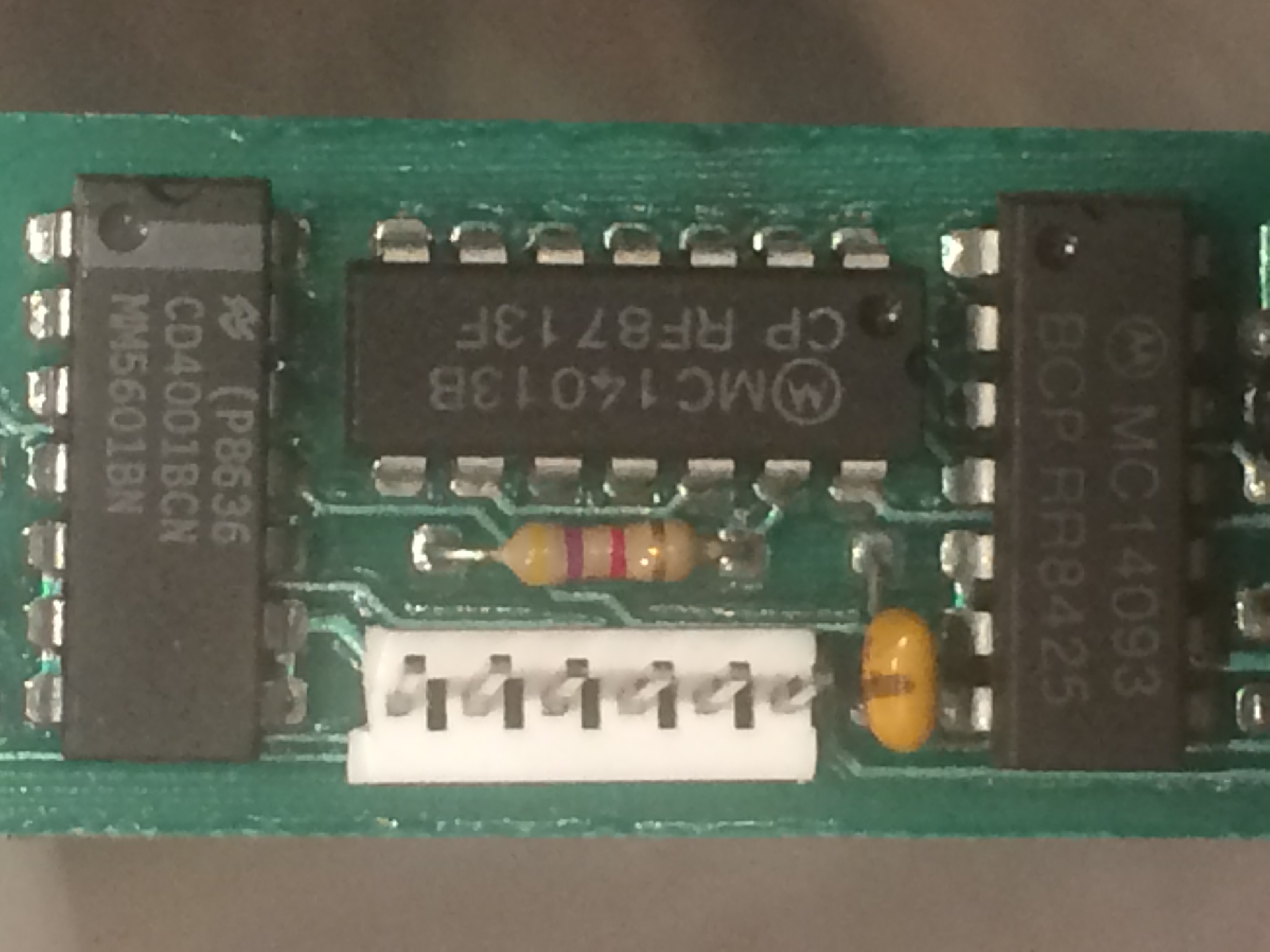

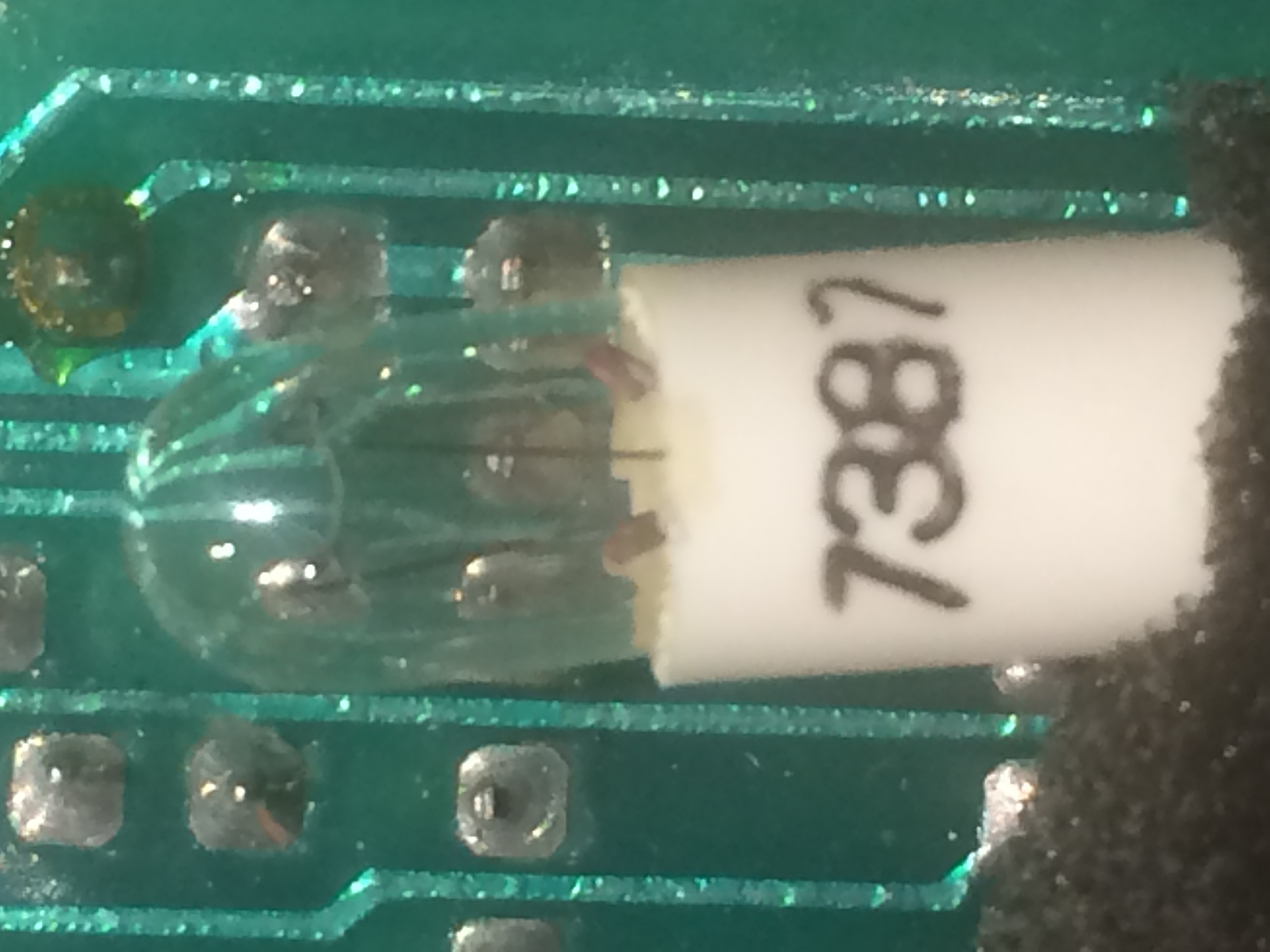

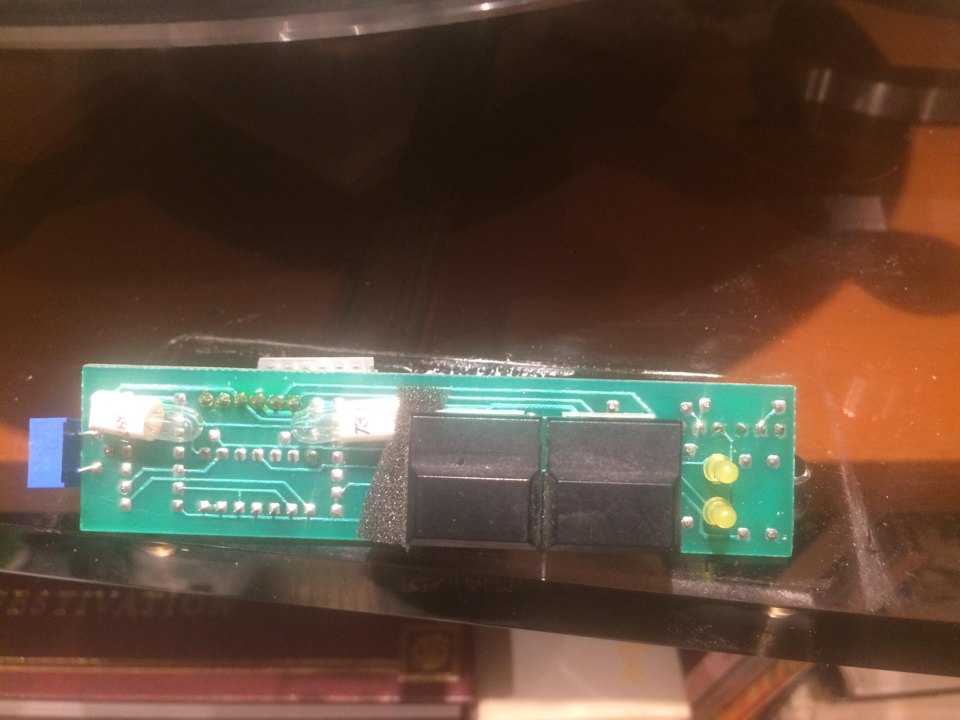

Oracle Delphi 3 front panel PCB etc
Here are the rest of the pictures i took when opening the front panel of my Oracle Delphi Mk 3.
The small lamps are from Chigaco Miniature Lightning model 7387 and can be found at Newark if someone is in need. These provides background light for the Oracle logo.
The LEDs indicating 33 1/3 or 45 is yellow and located to the right off the two buttons (which may hang if the small panels comes to close to the buttons).
The PCB itself is labelled Oracle 8702.

Pot meter and oil
I changed the Bourns pot to a TT Electronics 72 series pot meter, also cermet and also 2kOhms. No change.

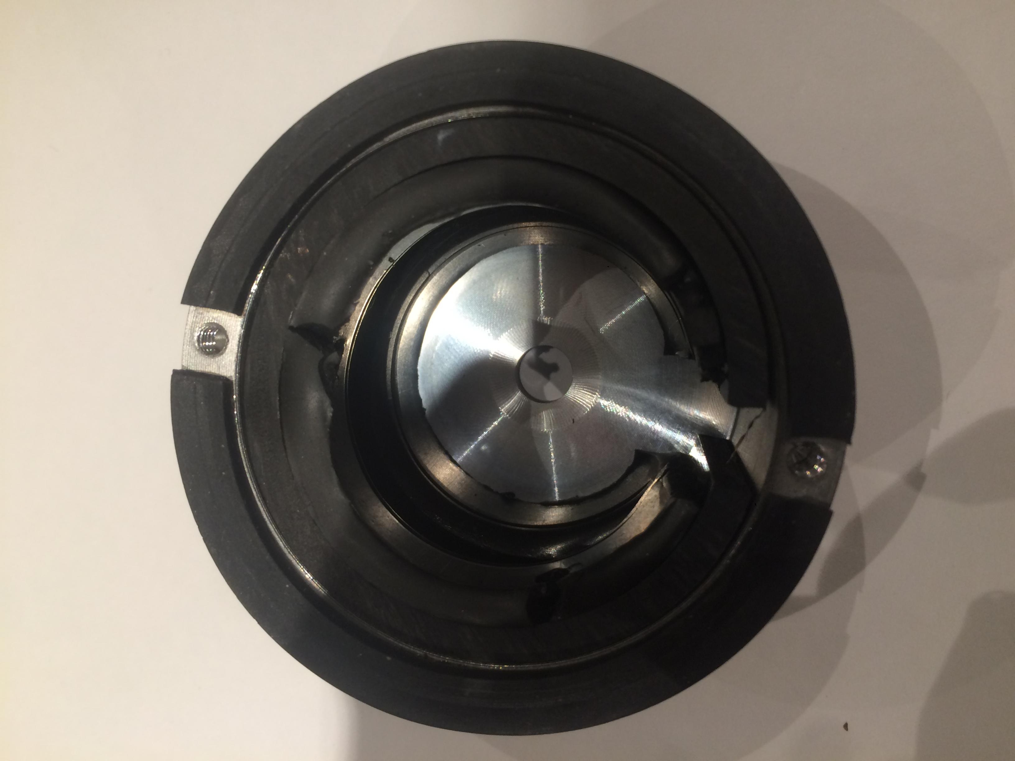

I then again cleaned the platter shaft and the bearing. Made sure it had a sufficient amount of oil. This time only the Liquid Bearings oil, bought on eBay. Checked the friction by holding the bearing with my left hand giving the platter a good spin with the right, and it turned many rounds and for a long time. Reinstalled and started the motor. Just had to turn the speed down, at stable it was, and is. I really hope it will keep its speed correct over time.

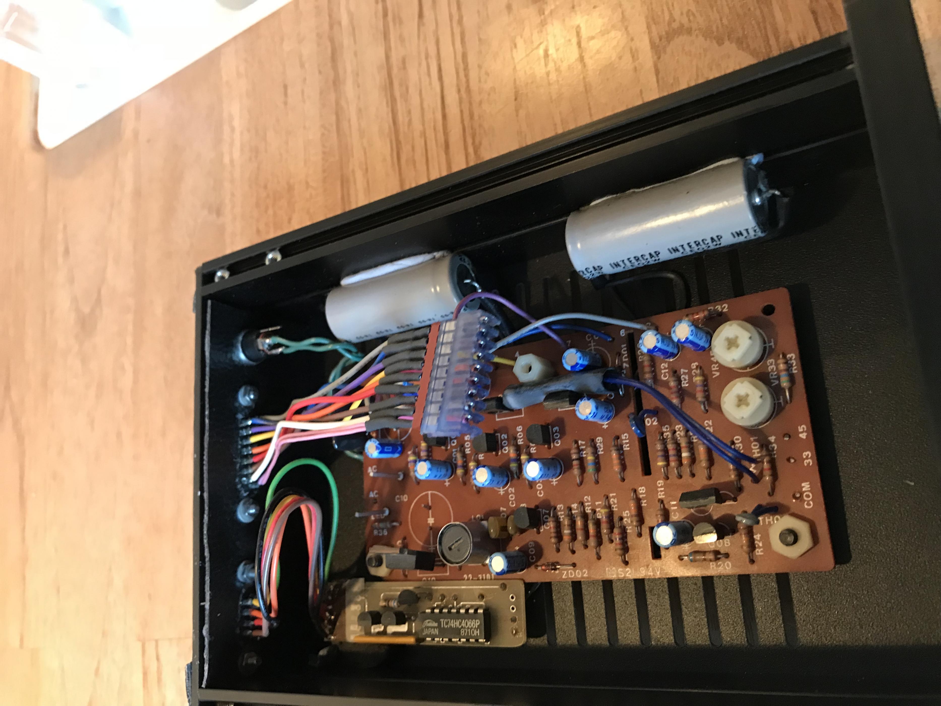

Hi guys,
Bought an mkiii where for some reason a previous owner modified the motor. The motor stands separated from the player and as far as i can tell the original electronics are moved to an external box. The previous owner sold it because of a failing connection between the panel at the front and the external box. I have repaired the connection, replaced the small lamps and everything works. My only problem is that i cannot get the speed adjusted right. All potetiometers has a small impact on the speed but at 33rpm it is always running too fast. At 45 rpm it seems more in line but i have not measured it accurately.
