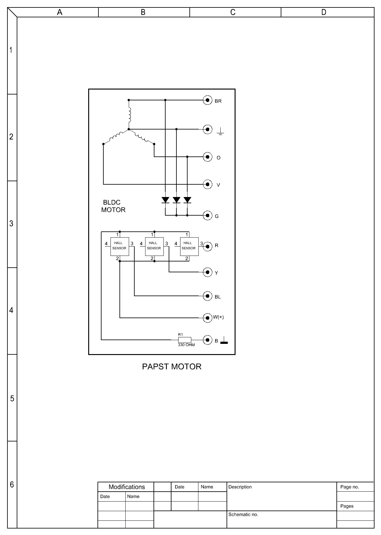

The MK III is a Pabst motor feed from the DC powered motor driver board. There are 2 hex screws for opening the integrated motor / driver board housing.

Madturtle and ticknpop: Thanks for the information. Mine has an AC Pabst "pancake" style motor.

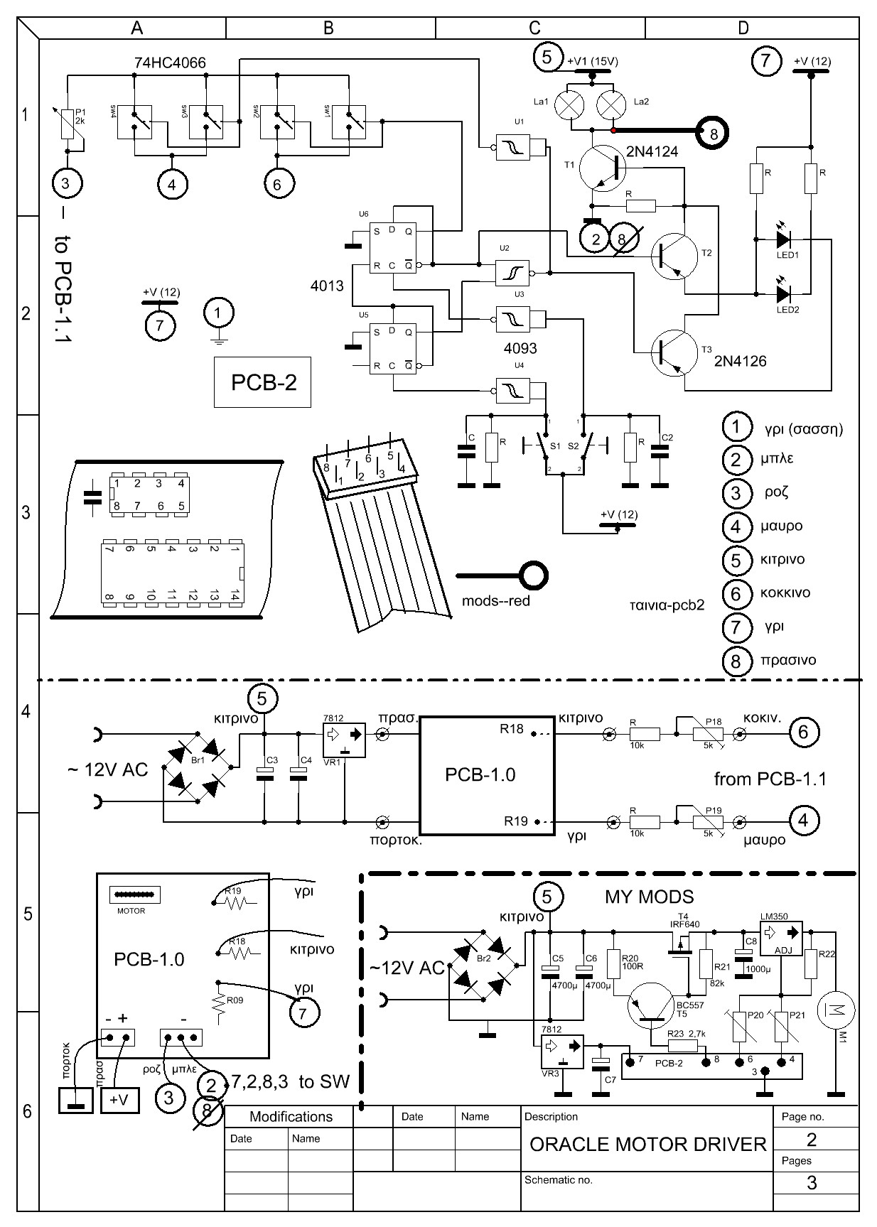

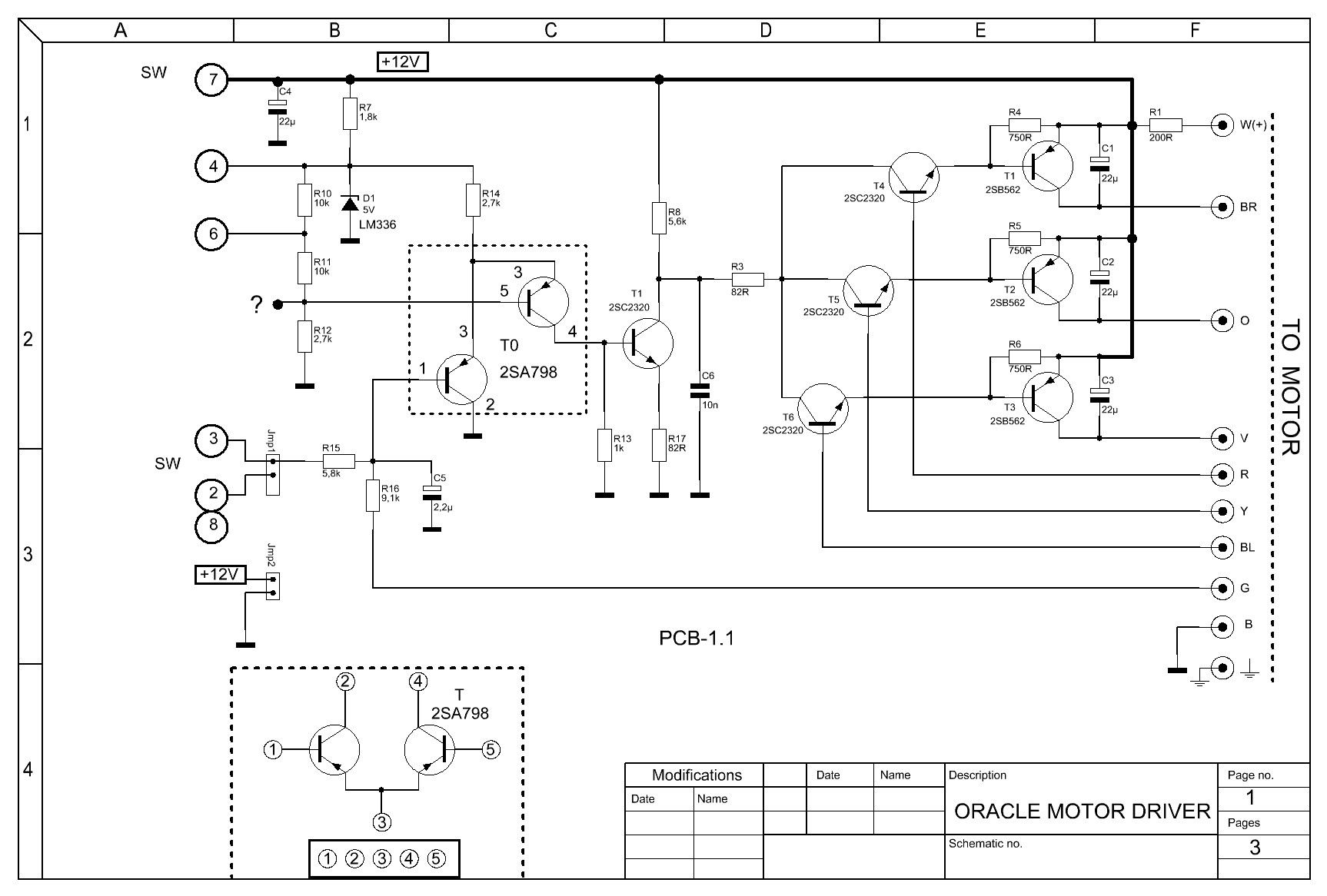

stergios1:Thank you for the circuit diagrams. Anybody need a manual for the Alexandria MkII?
