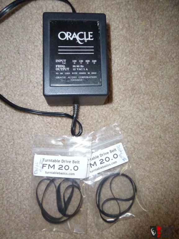

I dug out the Delphi MKIII today and couldn't for the life of me find the original PS. Buggar. So I found another 12VAC walwart @1.0A and fired it up and the motor would just sit there and wiggle back and forth. Gave it a spin and it wouldn't go. Gave it a few more wiggles and away it went. Not sure what it's problem was but it seems okay now. I am going to dig into the internals and find schematics for the guts of the controller and at a minimum, build up a nice heavy AC supply to feed the table, and maybe build up a new controller, depending on how the motor is driven. I will have to find a way to get into the motor casing. I didn't spend enough time on it today.
More later.
Cheers
Ticknpop asked why a 12VAC supply rather than a 27VDC like he has on his MKIII. Very good question. I found several posts and pics indicating that the original was a 12VAC 1.0A supply.
Here is a picture I found for a MKIII, according to the ad.
So who out there has a MKIII, and what is your external PS rated at? Any pics?
Also, has anyone found schematics for the epoxy module under the motor? I am about to tear into mine and thought it would be good to know what I am getting into beforehand.
Cheers

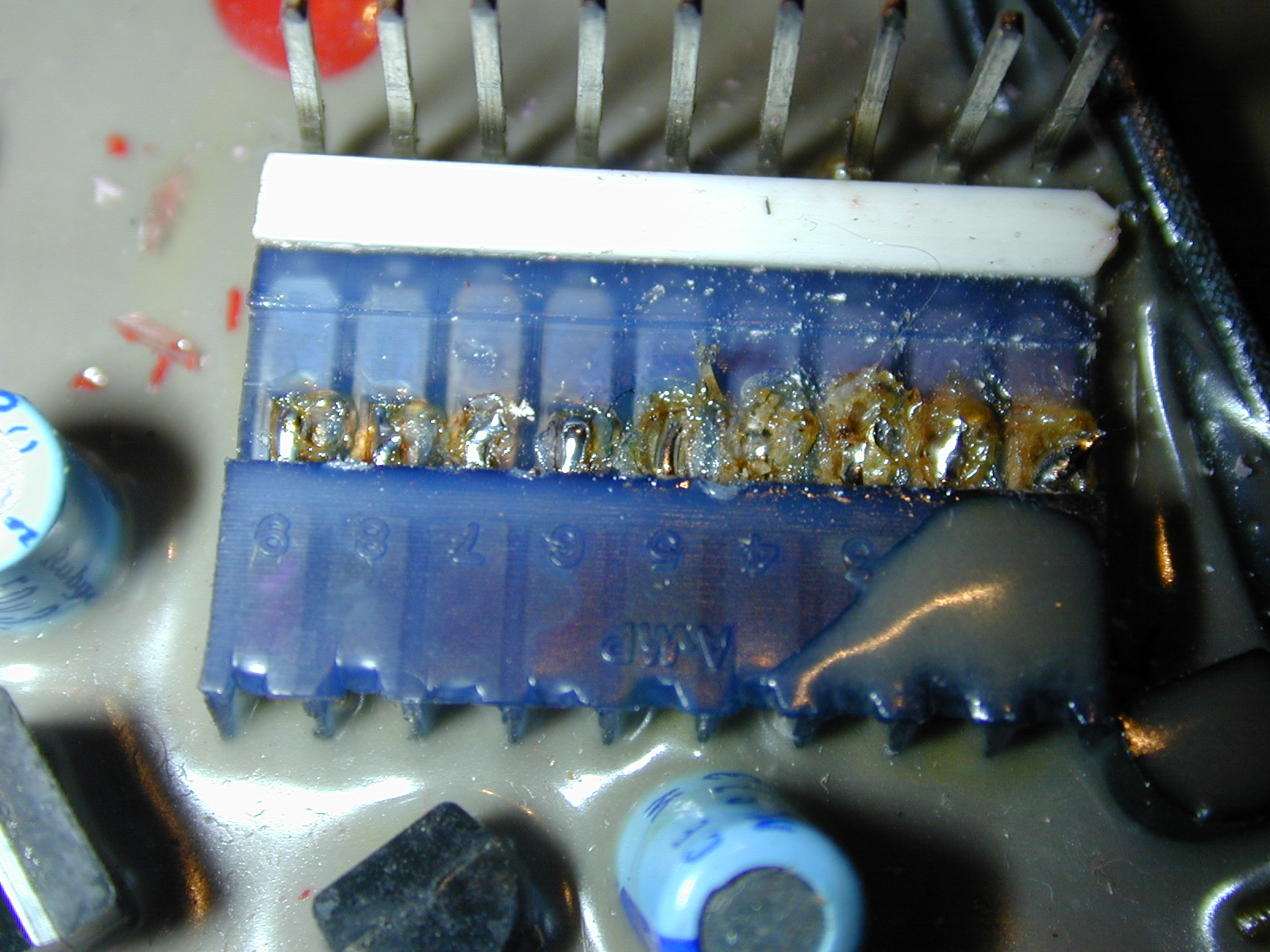

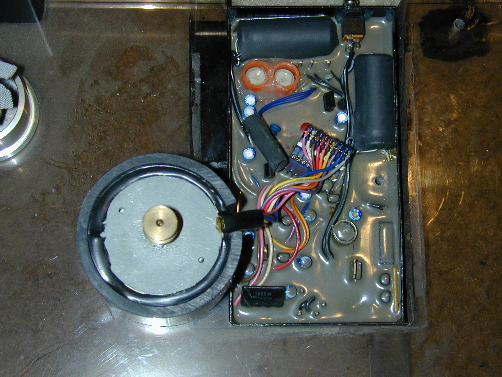

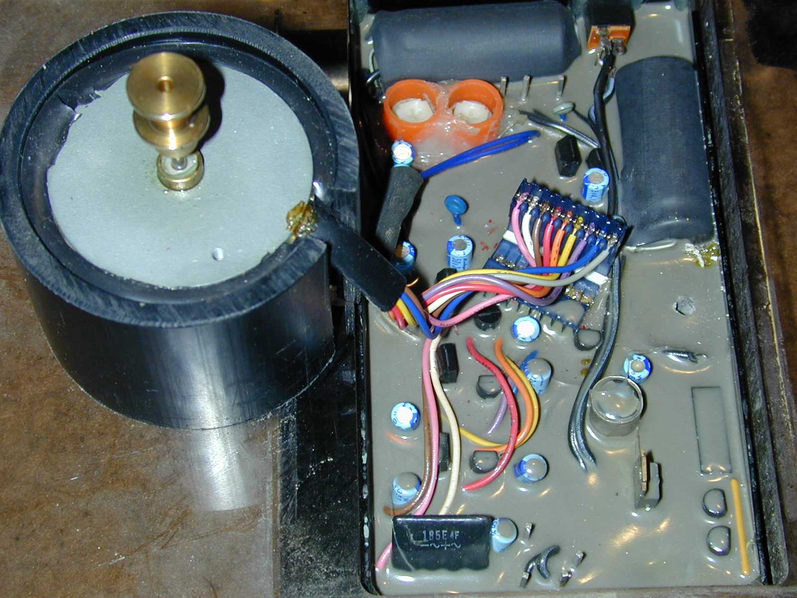

Found the fix for weird speed problems
An update from the front.....
I found the speed problem with my MKIII and wanted to share so maybe some of you out there with similar problems, might be able to fix yours.
Under the power supply cover, there is an epoxy potted module that drives the motor. The motor is connected with an AMP connector and when my motor decided to do the wiggle dance, like it couldn't decide which way to turn, I moved the plug and shazam..it started right up and kept spinning. I cleaned the pins and reseated the wires in the plug, then it stopped working altogether. 😱 So I thought there must be a cold solder joint on the board and proceeded to cut away little chunks of epoxy off the top of the connector and got down to the plastic housing of the connector, and there were already little cut outs for testing, so I put on my SMT soldering tip and reheated each connection. Tried it again and it works 100%!!🙂🙂 Don't try this with a Weller gun, it just won't work. 😀 You need a really fine tip to do this.
Anyway, just thought you would like to know a possible fix for your MKIII speed issues.
Cheers
Paul
