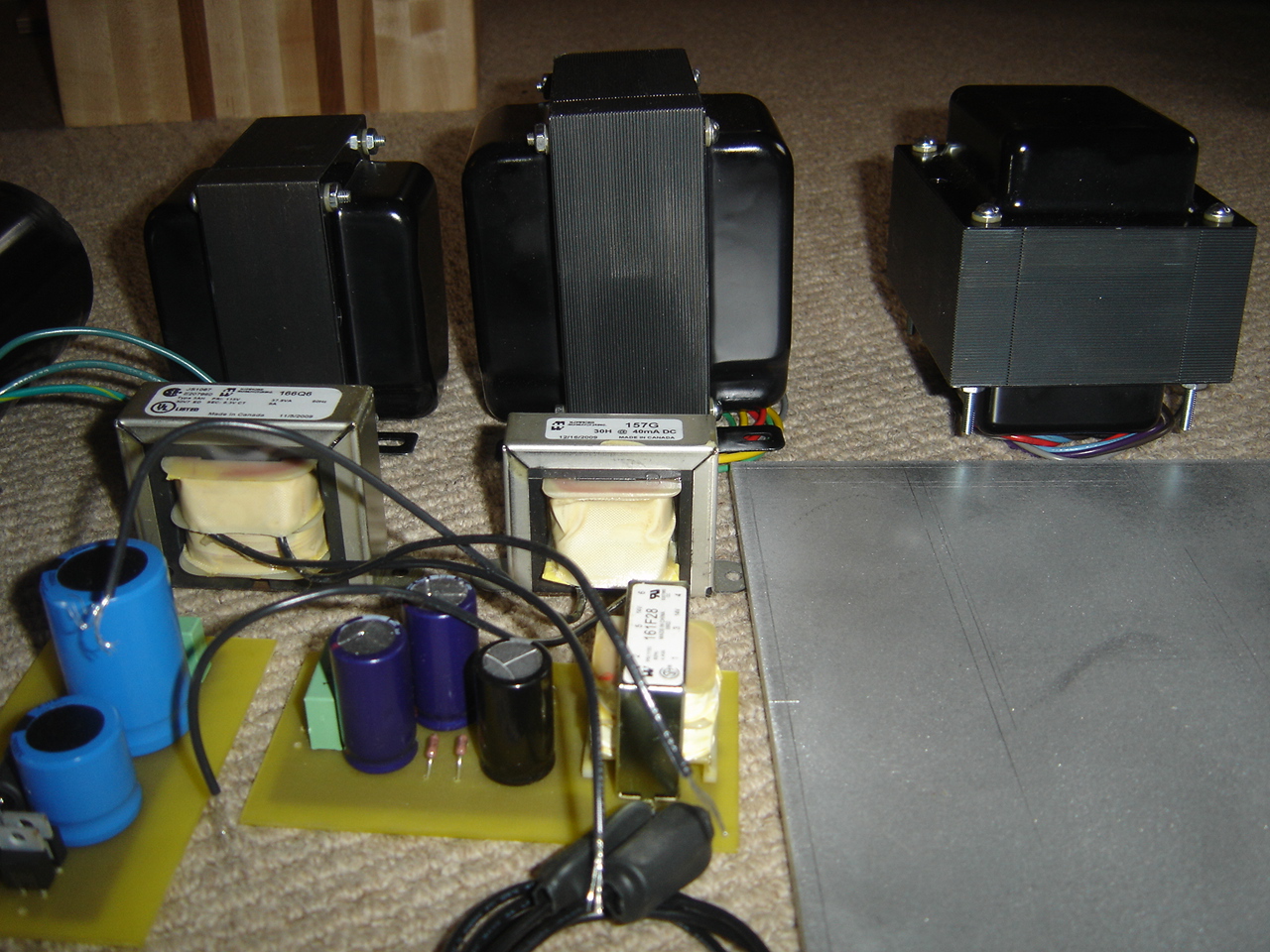

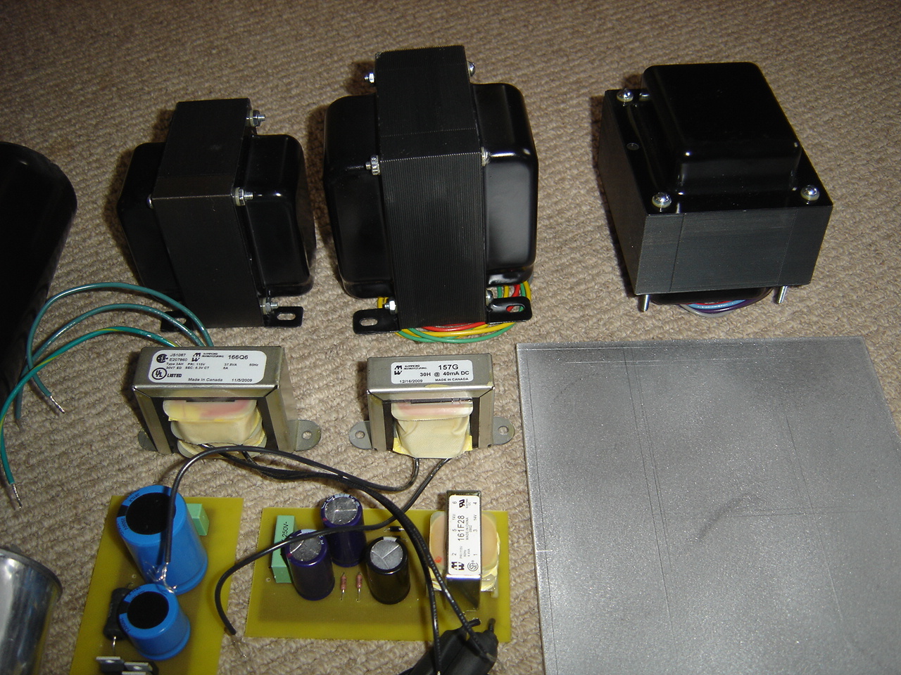

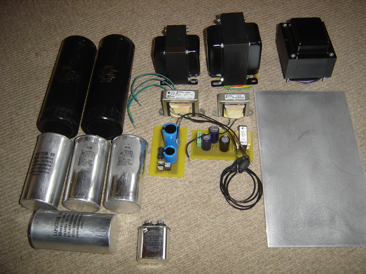

Nice! Is it choke, Output, and power transformer from L-R?
I'm contemplating breadboarding this as a stereo build once I sort out what power transformer in the parts bin is suitable.
Choke, PT and then OPT.
Stereo certainly is possible if you have the iron to support it.

I was jealous to see you had already gotten yours until I got home and saw a box from Jack waiting for me.
These things are MASSIVE. Really massive! They make my ST-70 outputs look like little chokes.

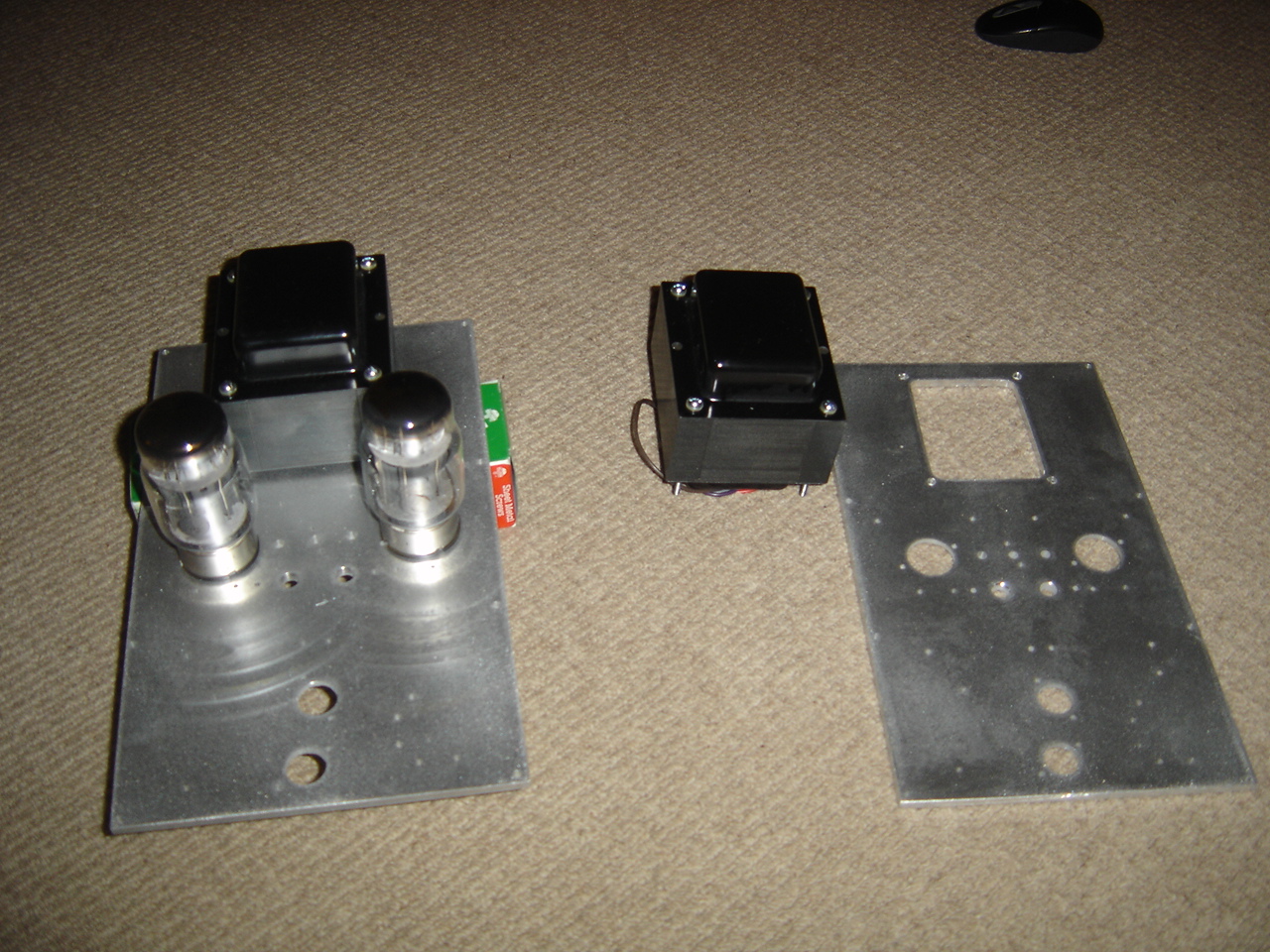

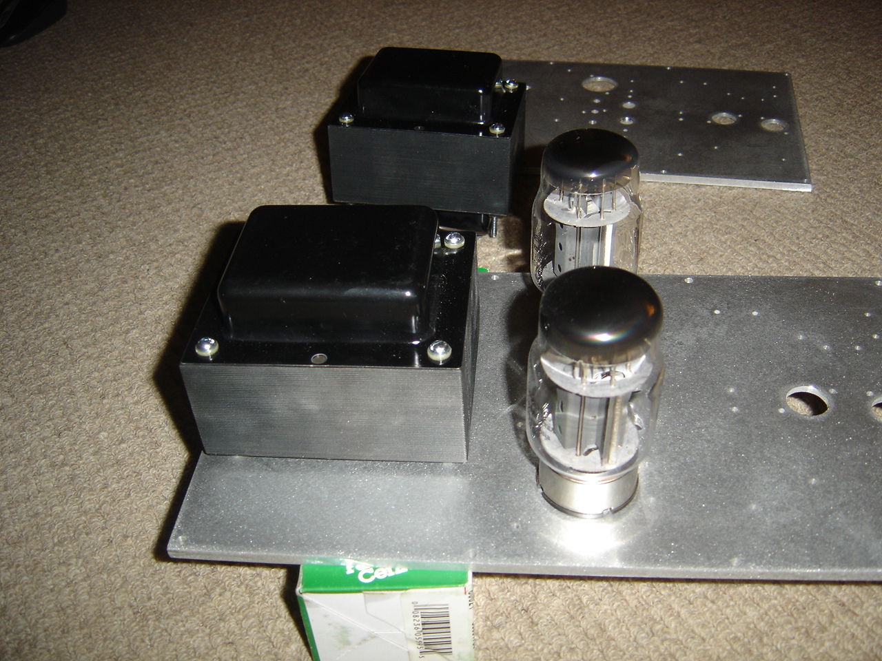

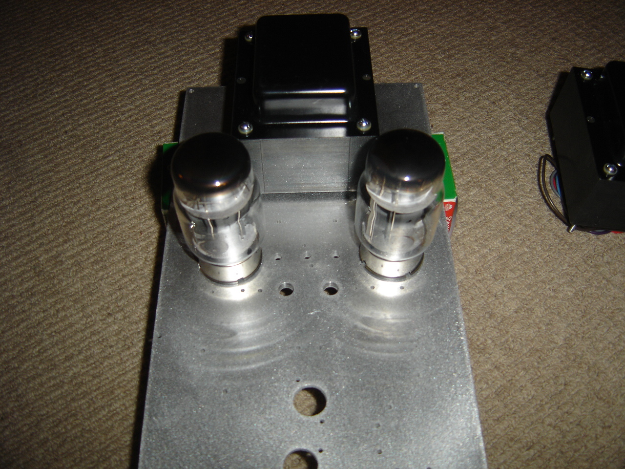

Tubemack, they are quite big and well made. Had to stop working on it tonight as the wife told me I needed to come up for air. But made progress. Have the two amp side top plates done. Will paint tomorrow and hopefully be transfering the components over by Wednesday.

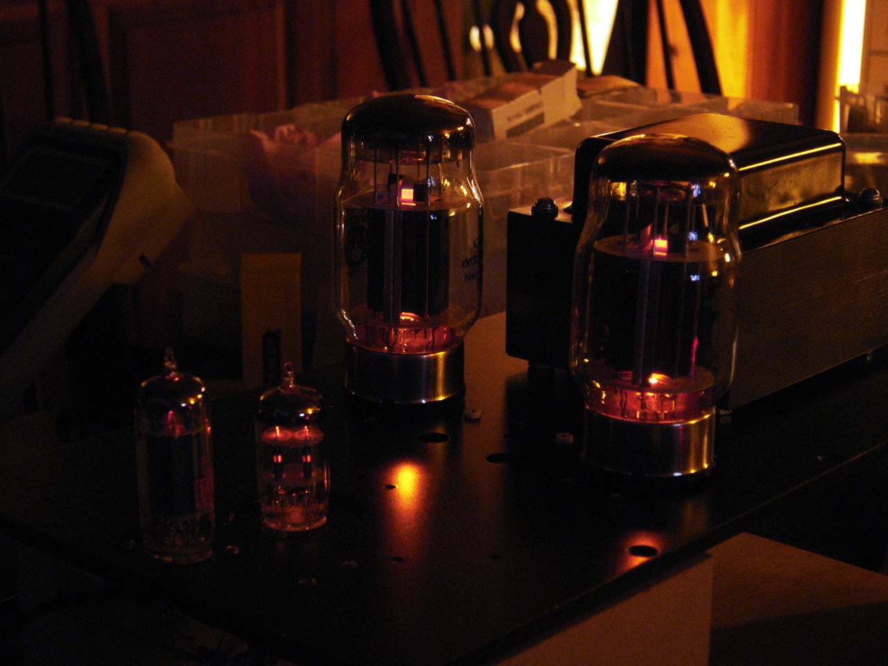

I put some tubes in it for reference. Enjoy
I am also quite envious of that iron. Wow...those are big suckers. They are at the top of my list of iron when I finally build that big AB2 amp...
OPT trannies or OT tubes? The OPT trannies are horizontal mounted. They have extra long bolts that fit through the holes at the four coners of the square cutout. The OT will sit on tube sockets that are mounted from underneath. When I get a little further later this week I'll take some close ups.
Did you get yours horizontal or vertical mounted. From what I can see it is just a different style bellend and longer bolts.
I missread, and confused your PT's and OPT's. My OPT's arrived as verticle models. Are you going with 4 chassis? Separate Power supplies?
No. Two chassis. The power plate and amp plate will be mounted in a single frame. Smaller plates are easier to handle, dampen, and are mechanically decoupled. Not that I expect the PT or choke to buzz. With a center wooden rail it also gives me more mounting space underneath for things like C- filter and B1+ supply. I can also sheild if need be.

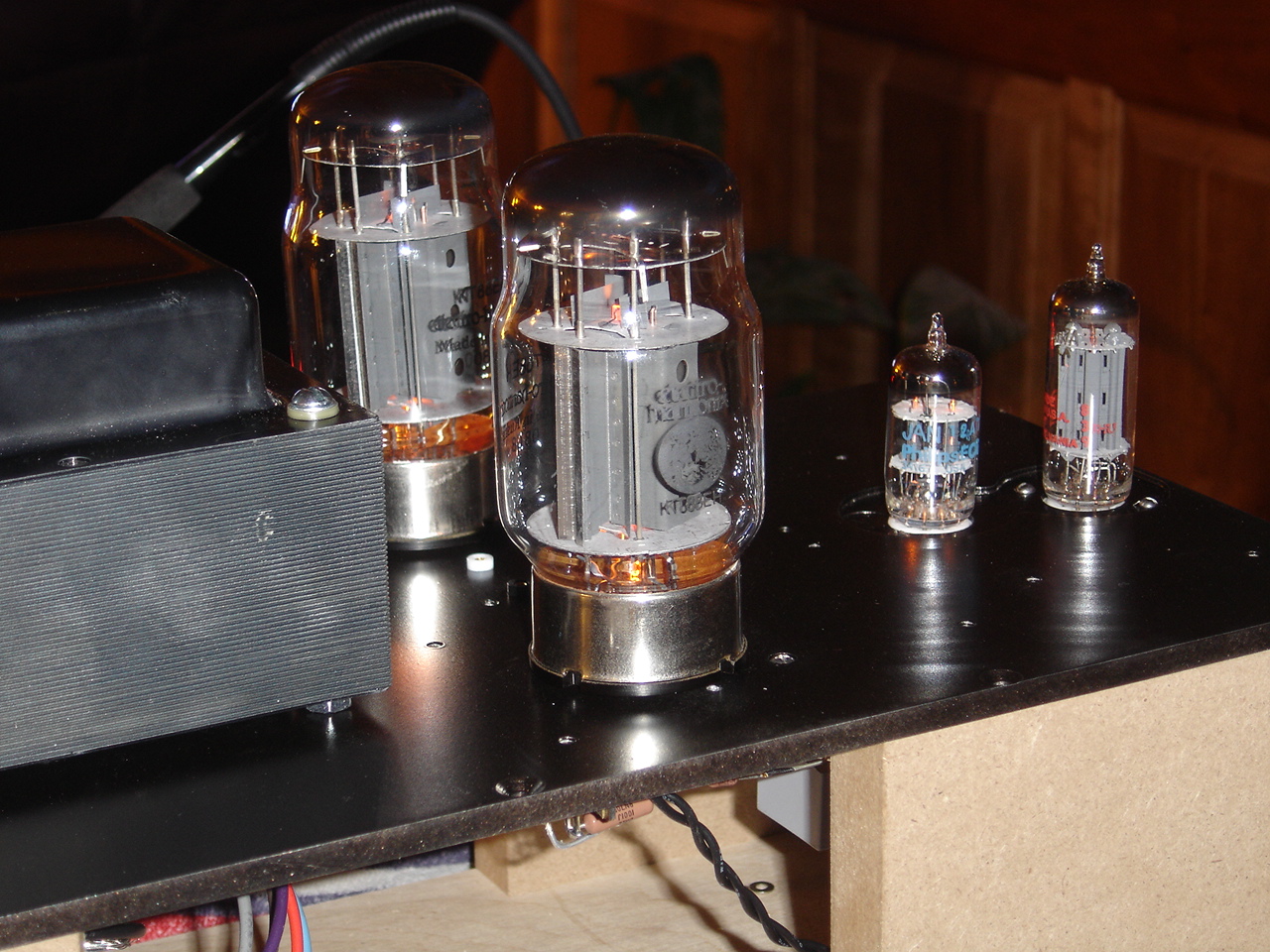

Let there be light!
No HV yet, but the filaments are lit. My filament transformer is too big and to get voltage down to acceptable range I had to put a 3.9R 25W in parallel as I didn't have low enough series resistor in my bin.

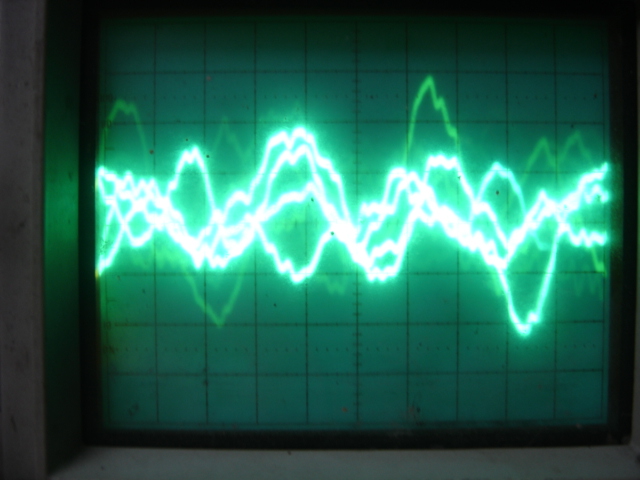

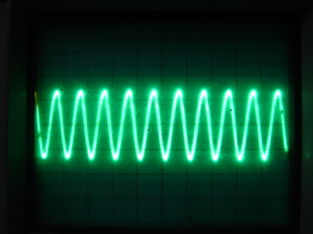

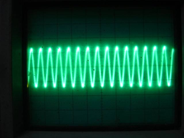

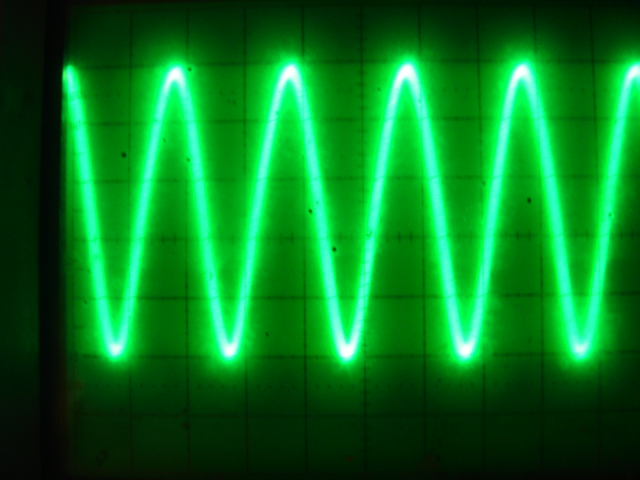

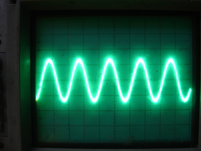

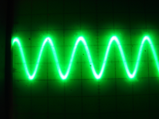

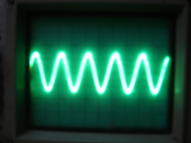

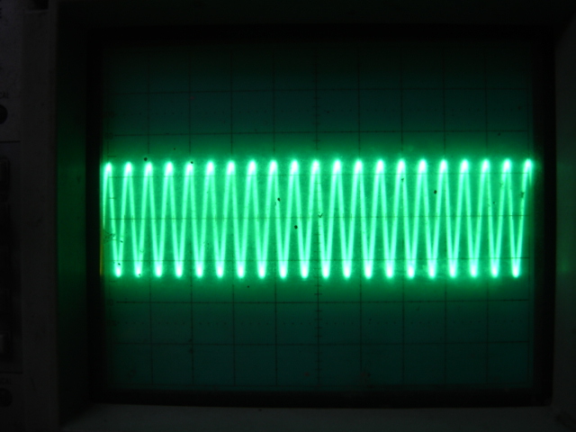

First few photo's of signal at the grid of the kt88.
100,1000,10000,20000,40000,music
Swing on scope is 75Vpeak input signal is 0.2Vrms. Will need a little feedback to keep it from being too sensitive but thats ok as it was designed for it. Will bias up the KT88's tonight and test them under load. Have some running to do first.
FYI The square wave isn't as good. WIll also play with that tonight

I should mention that the above scope pictures were aat the onset of clipping of the driver stage.

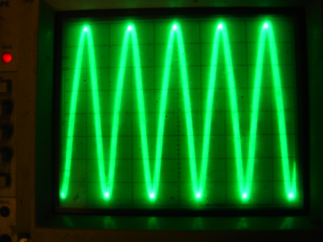

First Measurements
Took some spectrum using 1kHz signal on a 8ohm resistive load.
First is at 100W, Second at 40W, and Third at 10W.
As you can see I have some filament hum at 60Hz. It is barely audible but present. I think alot of that is related to being on a breadboard.
It appears to have a nice spectrum. from 2nd order falling at each incremental harmonic
The square wave isn't as bad as I thought. My source isn't as good as I want so I will work on that tomorrow.
Attached are the spectrum and photo of trace for 100W, 40W, and 10W.
