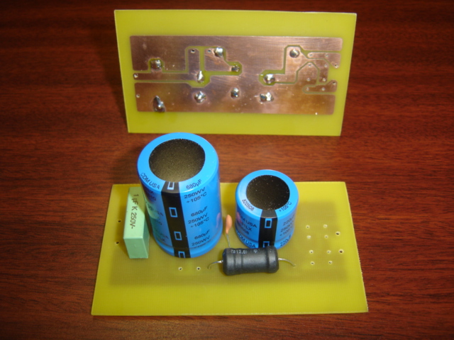

A Simple CRCRC filter addresses the issue of regulated B1+. I can get 90uV ripple with the same xfmr and 220uF-220R-470uF-220R-470uF. at right around 38V with 20mA. That is without even tweeking and using pretty much default values in PSUDII

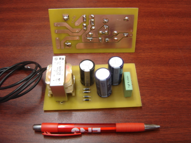

Progress,
Things are starting to move along, The B1+ rail is complete and tested under load. Holds 36V at 25mA. Ripple was 0.07mV. Not too shabby for a CRCRC filter. Voltage is hotter than expected but certainly welcome. The xfmr is a 4.4Va Hammond. The circuit is built per the attached schematic. The C- filter is also under construction. Won't be able to test that until the PT and choke arrive. I put a pen in the pic for scale.

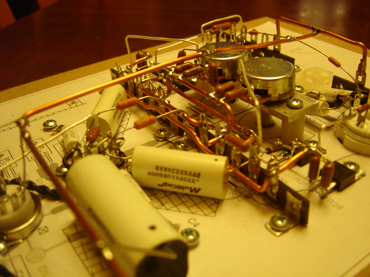

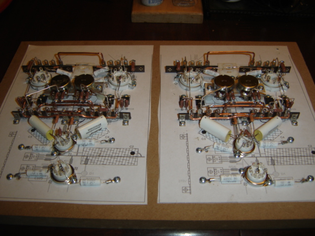

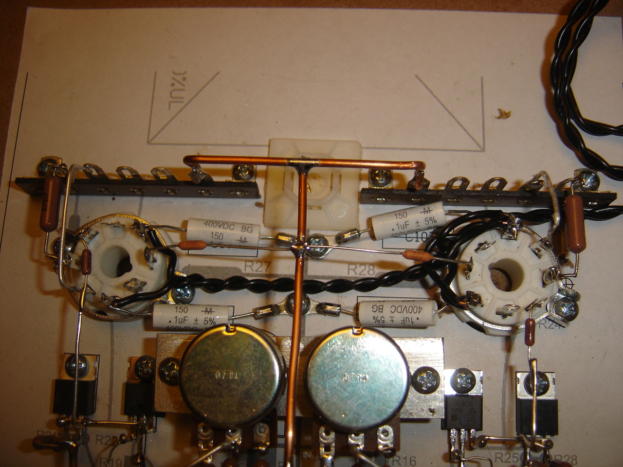

Further Progress
The circuit is starting to take shape. Building both channels on a piece of mdf and will transfer over to the aluminum top plate by unscrewing it and reattaching it. Need to have trannies to finish plate which should be next week. With this method, my hope is that I can keep bith units symetrical and orderly. The FETS tuck nicely between the rails(copper wires) and the kt99 sockets via the top plate. Signal path is kept short and away from other components to minimize stray capacitance.
Very nice. I'd love to see some larger pics to study the detail, as I will soon attempt my first P2P. I've never seen this bare wire method?

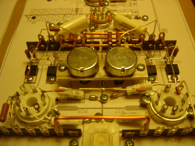

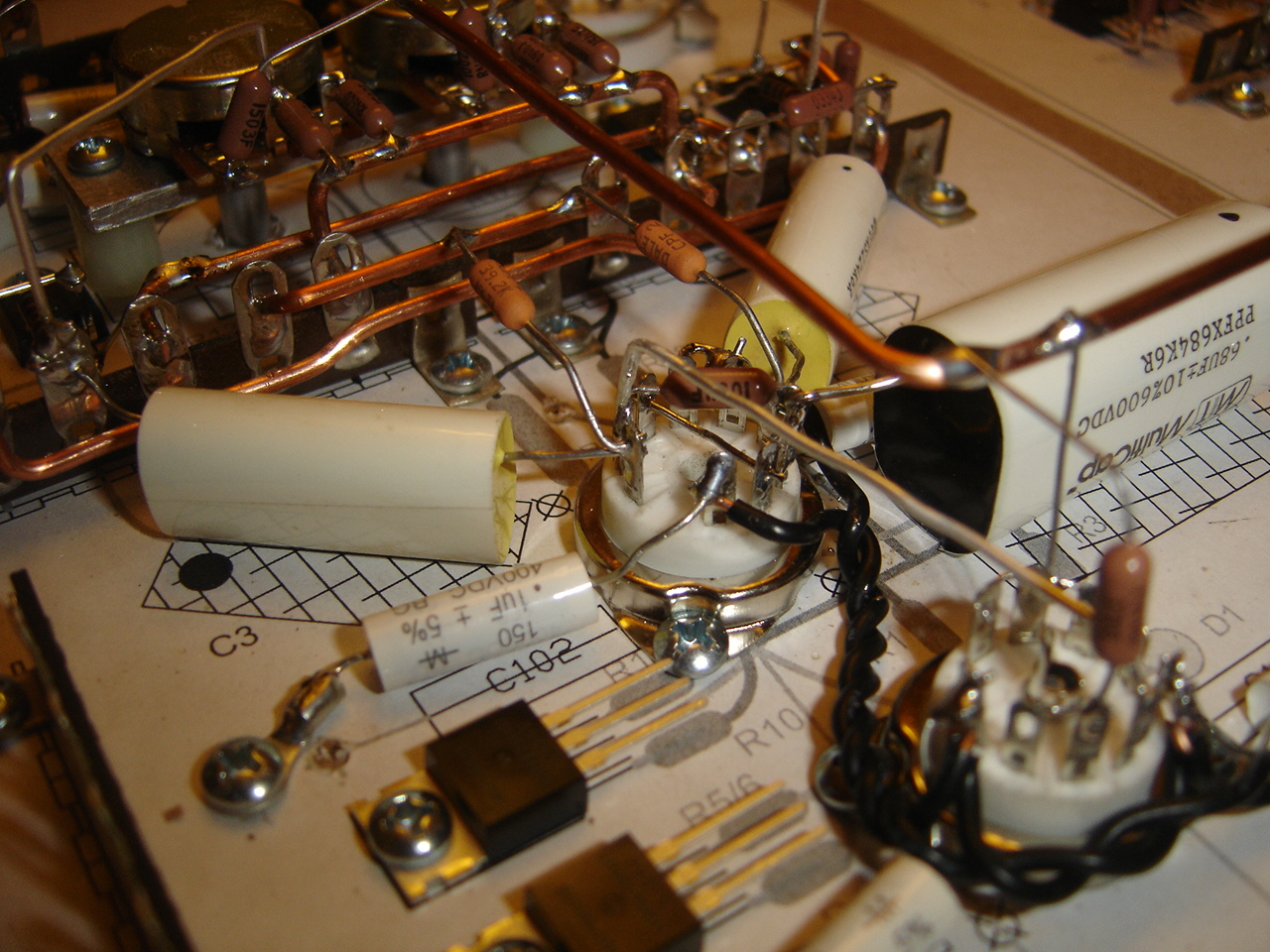

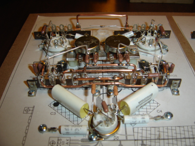

Another Update
Thought I would update. Work progressing with the limited time I have had recently. All the iron is in the mail so should be here this week.

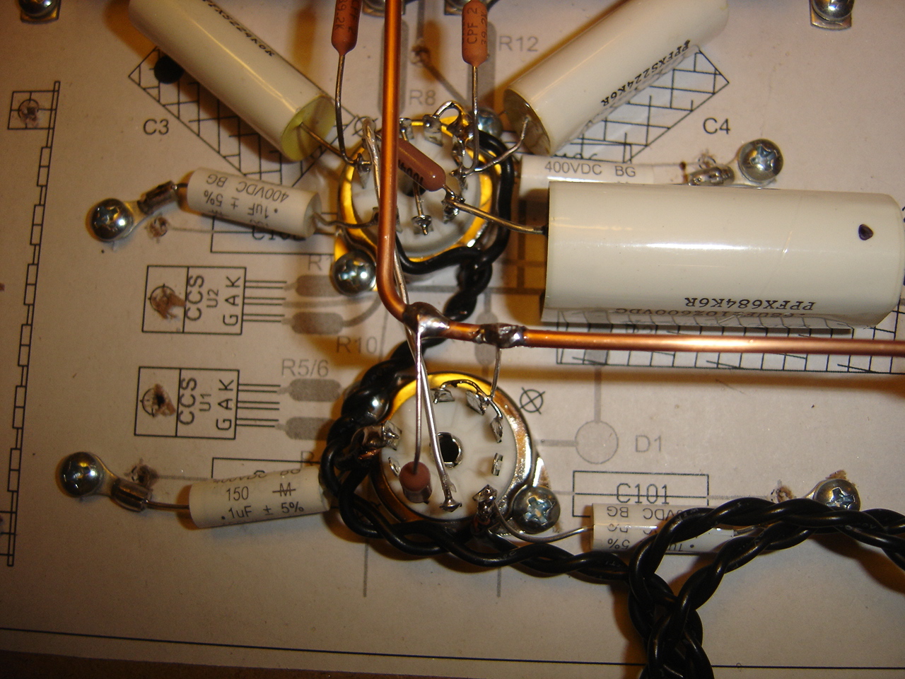

In these photos it shows the heater wiring. Picked up what I could from other thread showing how to run the heater wires. What a PITA as I used 18guage solid core. Please comment if you have suggestions to improve it. All I have left is to run CCS's for LTP and Voltage tube. Hope to have that done in the next few days.
I have been able for the most part to keep to the layout I have drawn. Only a few minor changes in location. Will update that and post once the wiring is complete.
I find it hard to get a good photo that shows the seperation of wires in 3D but they are larger which helps
Or a power substation. Very nice construction btw.Very industrial! Some of those pics look like an oil refinery. 🙂
