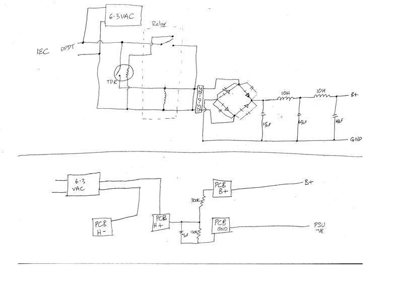

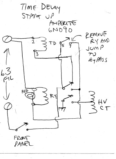

boywonder, I am interested in the delay setup.
Here you go. These are both from other threads/members here. I've breadboarded the second one and it works fine (upper schematic). Disregard the lower schema on the second image. I would go with a 45 sec-1 minute amperite time delay relay to allow the heaters to get toasty before applying B+.
When the TDR closes, it energizes the second relay which powers up B+ and takes the TDR out of the circuit to cool for the next power cycle, so even quick power cycles will have a start-up delay.
Of course this adds a little complexity to the PS but the amperites look pretty cool......
With a common mode choke, Wouldn't the impedance pretty much cancel each other out at the lower frequencies? I asked Electra-print to quote me one and he said a "Common Mode Choke" would only work in the Mhz range. Great for RF but not for ripple.
In my mind I can make it work, but I am confused with his response.
Of course in my mind I can fly without an airplane!!!!!
