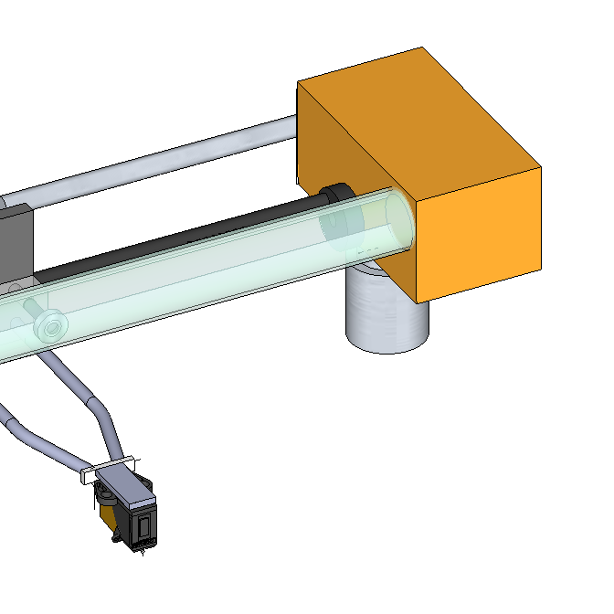

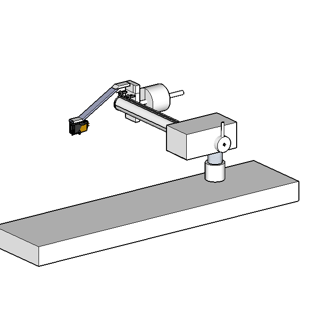

here's a png of the DIY version of the Cantus3 me and Murray started work on last year. This was worked back from a photo, so dims may be wrong. Me and Murray also worked up an external "carriage" type that shows some promise, but may be heavier than the Cantus.

Stew: a stainless steel tube would do just fine, I don't think that glass has any special advantage. Take a look at the Nottingham arm in the pictures above as this is essentially what you describe though the tube the bearing rides upon is small in diametre.
The advantage that is gained by running inside the tube is that of having geometry and gravity work together to automatically reposition the trolley to its intended position in the tube should the cartridge have to track a severe warp.
Bo's primary goal is to translate as much physical motion (at the stylus tip) into electrical energy (signal output) as is possible. This means that you have to have a rigid system to prevent loss. The horizontal trolley is about as close to this as is possible. The vertical motion through the intended bearing sideways play permits arm rotation which must be there to accommodate record warps yields to the design goal only enough to do the job under real world conditions. The system is non resonant and incredibly rigid.

As a highly qualified Mechanical Engineer, I can assure you that using a combination of different materials, (Hardened Steel Balls to Very Hard Glass) has massive benefits in eliminating vibrations, caused by Rolling Friction.
Metal to Metal "Sings". Try a couple of Cymbels!!
And this "Intended bearing sideways play" is just a fairy-tale. The Trolley rotates up the Inside Wall of the Glass Tube to accomandate Record Warps.

Peter: my comments here are given in the context of DIY. Most DIY builders do not have the ability to machine a glass tube. A stainless tube can be machined and polished to a precision inside diametre at any good machine shop or by those with the know how and their own equipment. This would I expect result in satisfactory results. I agree that the combination chosen by Bo is probably offers the best outcome and performance for the reasons you stated.
I had mentioned that the trolley would move up the inside of the tube during sever warps. I was under the impression that it was either Rauna or yourself that spoke about the bearings used and that they have built in play in the race to allow for arm motion. If I am in error then I apologize for misleading readers and stand corrected. I will re read correspondence to see where this impression originated.

look at the statement it is a Cantus (horizontal trolley and bearings)with a tube arm wand which does not sound as good as what Bo does. Discussed this with Bo last year and he went through all sorts of arm wands and said that no matter how he damped a large tube wand the resonance was audible. While Cantus is not so fancy it is a fabulous deal for a great tonearm.
