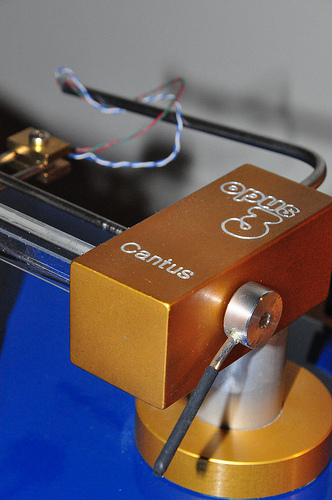

Opus 3 Cantus parallel tracking arm
all these arms permit the tone arm to swing freely. this is exactly the action what Bo wanted to eliminate with the Cantus design.
You do realize the Cantus is a rather radical approach to tonearm design so you are not likely to another one like that, except the Statement TT1 arm by Clearaudio, who has a track record of curiously coincide with someone else's ideas. Surely there's a way to minimize the vertical seesaw action, right? Instead of V-groove bearing, can't we use regular cylindrical shaped bearing? Or even just some form of vertical fluid or magnetic damping in the vertical movement. I'm just trying to think of another way without using a rather delicate glass-tube. After all someone already thought of that idea so I want an alternative.

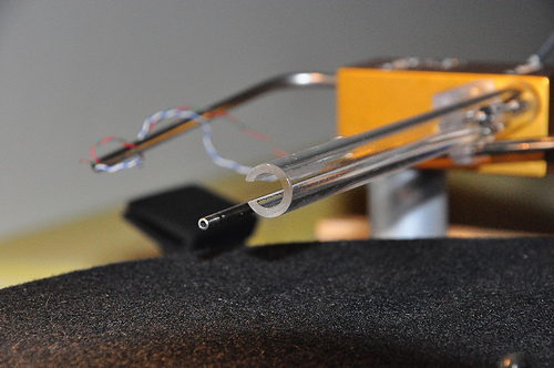

I don't think that Rauna has had any real issues with the glass tube with respect to breakage and they are precision ground. Nothing to say you have to use glass you could machine and hone a metal tube to the same result. You could run two bearings outside of a precision ground tube but then you have to build a covering and when you use the inside of a tube it (the bearing and track) covers itself. Keeping the track clean is important. Designing the arm inside out would seem to be more complex than the way Bo did.
The use of the cylindrical roller bearings use in the current version of the Cantus is what makes the arm so rigid. The added friction in the horizontal plane is minimal and the extra contact points help the arm to better track a straight line. On a flat record the arm cannot rock there is no resonance because the system is non resonant. It is a very clever design. Motion is provided for the arm to track normal warps by means of the bearing races permitting the pivot point to slide enough to let the cartridge track the warp yet have no impact on horizontal motion.
I think instead of V-groove bearing on a knife edge, we can use V-groove on a round rod to get similar stability. But the only thing is that when confronted with a warp record, the bearing will get pushed back instead of forward like the glass-tube. Just a thought.
That's a good idea but again there is no reason that the tube has to be glass. Remember the larger the tube the more rigid it will be. You will still want to cover the assembly. Riding on the outside of a tube does not however provide the inherent ability to centre the trolley if it is pushed off balance by a severe warp whereas the inside of a tubes curvature forces the trolley always back down to centre at the bottom of the tube. All the same I like your idea.
I agree that riding inside a C shape has much better self centering effect, hence geometrically more accurate.
Moray, I want to thank you for providing so much information on this fascinating design, especially quotes from the designer. I am beginning to have a better understanding the designer's intention and at first it was a shock to the system to think frictionless free vertical motion is not always a good thing! It really does make me see tonearms in a different light. It makes me addressing issue that I was not aware of. I applaud him for thinking outside the box.... or glasstube. 🙂 Thanks again.

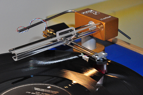

Murray, the longer I look at the Cantus, and the longer I look at the drawing (a rough sketchup) we did last year, the more I am convinced a similar arm could be done, but with exterior rollers rather than internal (I don't know how to cut a slot into a glass tube without destroying it, I have saved a tube for possible use though)

Hi guys
I have'nt read trough the hole tread, but I saw you methioned the Opus3 Cantus
I am using The Cantus arm, on Bo´s Continous TT, and it works great
The glas tube MUST be absolutelly horisontal though
But ones it is set, it runns fantastic for years without further adjustments
Ones in a while I remove the "wagon" and pull a Cotton buddy throug the tube, to remove some dust.
But otherwise no maintenance, what so ever
A friend of mine ones oiled the bearings in his Cantus arm.
Never do that! The bearings must be keept dry to run easy.
Bo is very keen on good customer support, and he often offer seperate parts for the Diy'er. Just sent him a mail through the Rauna website
I ones broke my tube, and had a new one two days later.
