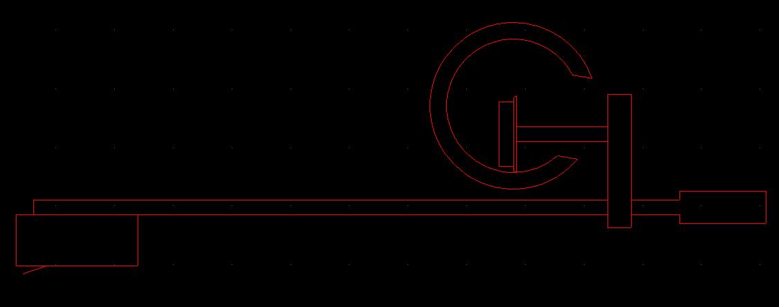

the Cantus looks interesting. I can pretty well backwards engineer it if you like. ...but----three bearings can create a "wobbly leg" effect. If running on a plane (flat surface) then yes 3 is better than 2, but in the tube... I think 2 are better than 3.
stew
Hey Stew...
so the assembly you are suggesting would consist of two ball in cup bearings which are mounted to either end of a rectangular plate, one bearing turned up at one end and the other bearing turned down at the opposite end. And if I follow Andres the bearings would be offset from the centre line of the rectangular plate so one bearing tip on one side of the plate and the other bearing tip on the opposite side of the plate. Two holes in the plate to mount the rods that insert into the tube via the slot.
I suppose you could also mount the bearings in the exact centre of the plate with one bearing on the front side of the plate pointing up and the other bearing on the other side of the plate facing down. But this orientation depends upon perfect balance of weight on the two rods. If you place the bearings at the ends of the plate it ought to be more stable.

I apologize if I am being redundant but I want to point out again the reason Souther/Clearaudio tonearm resting on three rollers , which make a plane, is to lock in for horizontal movement only to ride on the two quartz rails and vertical movement is taken care of at the gimbal bearings below at the hanging mechanism. If one is to use two rollers, it would create a rocking front to back motion, thus the vertical arm movement. My concern with the Cantus arm is that the two rollers are cylindrical and seating on a glass tube would create too much contact points, at least four. Wouldn't it be better to have V-grooved rollers riding on a blade, therefore less contact, less friction and more precise vertical pivot? Just a thought.

Directdriver: it is my understanding from those who I have spoken with who have hands on experience with Cantus that the roller bearing assembly has superb contact with the surface of the glass track and the bearings are considered to be rigid except for their horizontal rolling motion. The bearing race assemblies in the roller bearings have been designed to have a small amount of slack (self damped by lubricant and sealed) which permits the arm enough motion to track record warps. It is this rigidity which accounts for the arms tremendous control and dynamics. The intent is to transfer as much energy from the cartridge (tip motion in the record groove) into electrical energy as is possible. This is achieved by reducing physical motion in the arm to a minimum.
I had though along similar lines to your possible suggestion of the roller on a knife edge. I had envisioned two captive single ball in cup bearings one at either end of a sled assembly that holds the arm. These would be very small and provide both horizontal motion as well as a pivotal axis point for arm motion, a rolling knife edge bearing if you like.
I discussed this with Bo himself and found his comments to be very interesting. Bo told me that as soon as the arm was allowed to freely pivot to provide forward and backward motion to track warps you have also allowed it to resonate at some frequency. You are then loosing energy and adding distortion through that motion. The purpose designed slack which permits the race assembly to move as a whole so the arm can navigate small record warps and which is damped is all that is required to play through a warp while maintaining the concept of keeping the assembly as rigid as possible. Tremendous bass control and dynamics are two of the primary characteristic qualities that owners of the Cantus repeatedly comment on regarding its performance.
Cantus arm
As far as I know early versions did have a ridge on the side edge of the roller bearings upon which the arm could pivot but this is not any longer part of the design on current Cantus arms as the rocking action was not considered desirable. The new version is said to be more stable and perform better as a result. The attached drawing shows the old style bearing assembly. Regards.

Thanks to Moray and Bappe for clarifying things and providing more design details. Now that I saw the drawing, it makes sense to have a flange bearing using the ridge as a rolling knife edge to reduce contact area. Judging from previous pictures I was confuse about that and thought the two ball bearings were flat circumference cylindrical shape that would create too much contact area and, hence, friction. This early version is really not much different conceptually from a V-groove bearing riding on a blade or the reverse, a rolling blade riding on a v-groove track. I am curious about the current version if, as you said, it eliminates the ridge and how it behaves vertically. If having more contact area is a good thing then a U-groove bearing riding on a round shaft would help stability, right? This is a fascinating design and its simplicity makes it very DIY-able for this community. Thanks again for the drawing.
By the way, the tonearm on the obscenely expensive Clearaudio Statement turntable uses, I believe, similar concept. Except the armwand is above the bearings whereas the Cantus is below the bearings. Check pictures and websites.
Directdriver: perhaps you can re read post # 31. The roller bearings in the current version of the Cantus are designs to permit the internal bearing race a small amount of controlled motion. The bearing race can move within the roller assembly without disturbing the horizontal motion of the sled or carriage.
