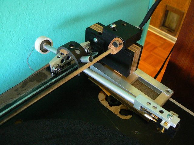

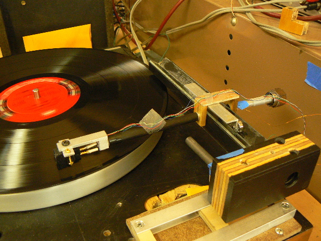

These two arms take advantage a great characteristic of BillG's glasstrack. Since the carriage just about can't torque, it possible to start working toward very light arm designs. The arms roll on hybrid ceramic bearings I got at a local hobby shop. They're great bearing, not very expensive, and I'm not going back to steel. They can be gotten here:
Ball Bearings | Ceramic Ball Bearings | RC Bearings | Tungsten Carbide | Powerpole Connectors | Silicon Nitride by Acer Racing
The first arm is a prototype that was just supposed to be about simplifying construction and maybe taking off a little weight and the first test was supposed to be just a tracking check, but something about the sound got my attention. I put it in my main system and was very pleasantly surprised at what I heard - much more detail, crisper attack, and percussion is a whole new game. It was like a blanket had been lifted. The combination of less weight and the better bearings means the stylus isn't so stressed horizontally and can respond to the groove information like it's supposed to. The prototype weighs about 45 gr.
The lighter arm also means the bearing/stylus distance can increased - these arms are six inch, the longest I've built - and that puts the support track well out of the way of the record, even with the low-slung ones I use.
The second arm is an exercise in form and function design. The black circular part is cut from an ABS pipe. The bearings are mounted 1/2" closer than on the prototype with no problems. They probably could be closer. It weighs 51 gr. and works well but may not sound quite as good as the prototype. My tinitus is giving me fits tonight so I can't trust my hearing. The extra six gr. is a bit above ten per cent more and is probably not insignificant.
I haven't tried the mag guide on either arm. I'm very reluctant to give up on it, but it may not be necessary, now.

Great work! Ceramic bearings was and is to be my very next step. What you describe in terms of sound is exactly what I've observed between my pivoted arms and the linear tracker with the glass track and the good steel bearings. It will be interesting to see/hear if there is any improvement to be had by simply replacing my steel bearings with ceramic ones. It looks like you are using somewhat larger bearings than I have. That will eliminate the problem I solved by cutting a relief in the bearing support rods for the edge of the track. I doubt that it will change anything else, but who knows. What bearing and size do you have and the approximate cost. Nicely done design exercise for number 2. I hope my local hobby shop stocks something suitable. I'm very pleased that you are having success with the glass track idea. The longer I'm with it the more I feel there are advantages to the V over the inside of the tube. This is still unproven, but your observation on torquing of the carriage sure points that way.

Shorter arms should have higher frequency resonance so easier to damp, longer would not be an advantage. Bo told me that he tried many arm configurations and that the small tubes used were the very best. This was how he tested different arm tubes. With a blank record playing he would lower the arm and gradually turn up the gain of his preamp until the system would break into feedback. The stiffer and less resonant the arm the higher he could turn up gain before the system would break into feedback. The two small tubes he used consistently outperformed larger thin walled tubes. Tube damping had little impact on this according to Bo. i hope this is of interest. Best regards Moray James.
BillG - Thanks. My new mantra is "it's the bearings, stupid." The improvement isn't incremental or subtle. The ones in the pictures are 12 mm and cost about $5. I got some 10 mm, too. With the new carriage, I can do a direct switch and I'm curious to see what the difference might be, if any. The glass track is a great rolling surface so with a bit more experimenting along the lines of damping, optimum angle, and so on, I'm convinced for DIY it's the route to take. I've always intended to mount an LT on an Empire TT and I think that's coming up soon.

phivates - Yes, the longer arm means more mass, about .7 gr/inch with this aluminum tube, which means I could shave off about 1 1/2 gr if I went to a 4" bearing/stylus distance and with the corresponding shrinkage at the CW/stub end, I could get this arm down to about 48 gr. Barring some other consideration, that's probably going to happen.
JRKO - You can go with the long arm and disregard the extra mass or get rid of it elsewhere, but check out Moray James' report above about resonances. Whatever you do, keep the wingnut.
