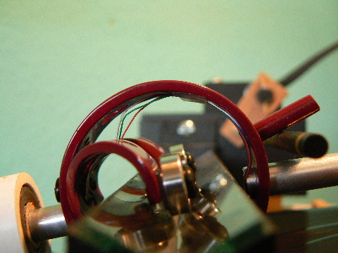

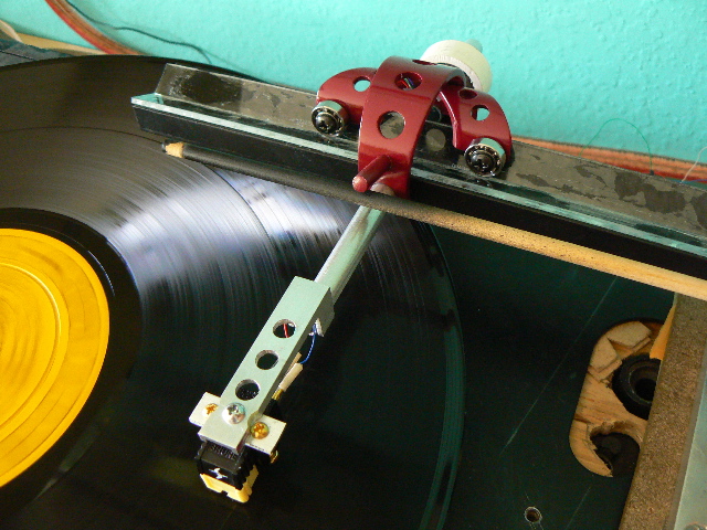

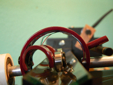

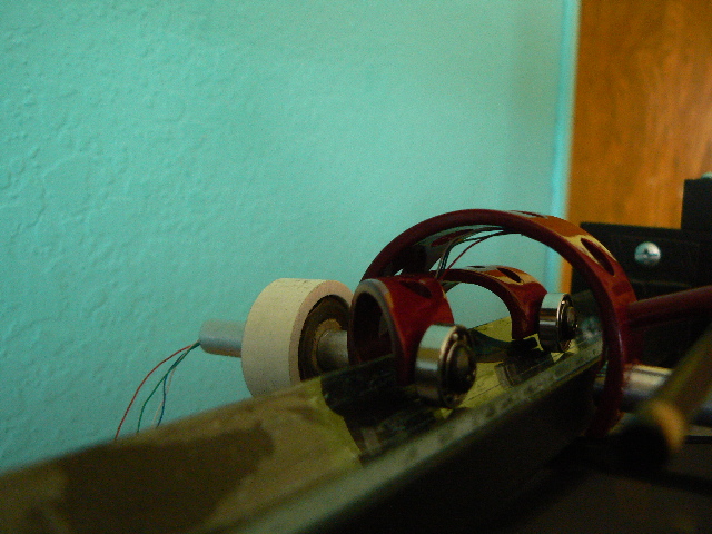

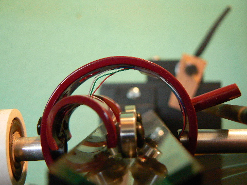

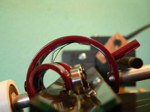

Thank you Moray and phivates for the kind words about the arm.
The Sketch Up learning curve was a bit steep for me and my working drawings are mostly crude reminders of what I've been thinking about - the one for the latest arm is literally on the back of an envelope - but I have thought about compiling the photos. I'm a sculptor, and although I haven't done much of that recently, it seems to come out sideways in my audio designs. Before I discovered Norman bel Geddes or figured out Raymond Lowey designed something other than the '53 Studebaker, my life took a couple of turns that put industrial/package design out of reach. I've always regretted that.
I think the 90 degree question deserves investigation. Ceramic bearings seem to alleviate a lot of the friction problem, but that still leaves inertial forces. I've never had much luck at trying to vector this thing out.
I don't like to hear needle talk or to hear sound from any source in the arm with a stethoscope so I've used brute force methods - neoprene, heat shrink - to tame that sometimes. I'm not sure about the consequences to the music.
Questions from an LT skeptic friend made me take the pictures. The bearing does seem to slide rather than pivot on the back corner. In a 90 degree V, a really bad warp might make the back side of the bearing scrape a bit, but that would be extreme and momentary. A more open V keeps that from happening at all.

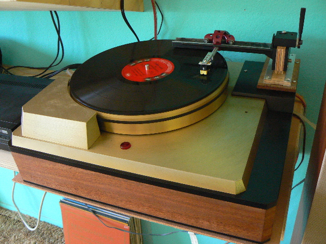

Hi Bill,
I've been hiding in my shop again. I've wanted to mount an LT on an Empire for a long time and finally got it done. Seems to work pretty well. Bass has taken on a new solidity. I just did a stethoscope check - it's silent.
The LT is running on the "clutch" bearings, now. I can't detect any difference one way or the other.
About two weeks ago, it was cold, grey, and rainy here, too cold even to work in the shop, so I got some paper and pencils to do some scaled up drawings of bearings in V troughs to see what I could find out about warp response. The back corner drops and the front corner climbs, but depending on the V angle, the drop/climb ratio can change from quite different at 90 degrees to equal at about 140 degrees. Another interesting thing is that there is a point on the bearing that remains stable, the bearing effectively rotates around it, and it rises from low in a 90 degree V to higher at more open angles. At about 140 degrees it equals the width of the bearing so with a 4x10x5 bearing, the stable point equals the axle center. Pictures would really help so I'll see if I can work something up in Paint.
Life has been scratching at the door again so I'm going to have to set the LT pursuit aside for a while. I'll still want to see what other folks have been up to.

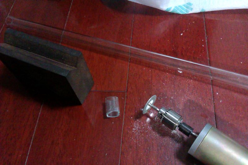

Eaglebear,
Thanks for posting the photos of your glass cutting technique. That's very nice work and will be helpful to builders who want to clone the original Cantus more closely with a tube instead of, for instance, a trough.
What kind of glass tube did you use and where did you source it? And would you go into more detail about the tool you used? I'm not familiar with a "bellow tool." Are those diamond cutting wheels?

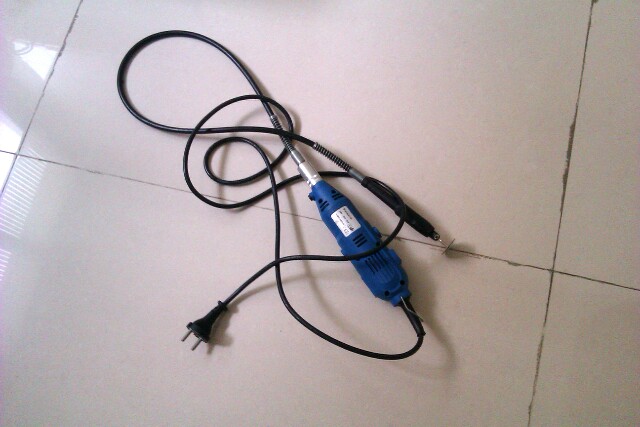

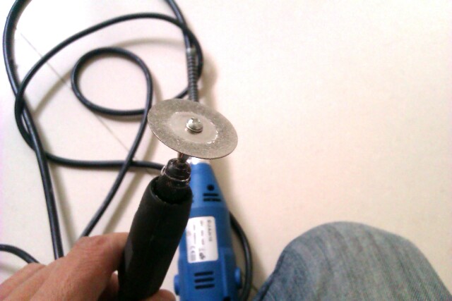

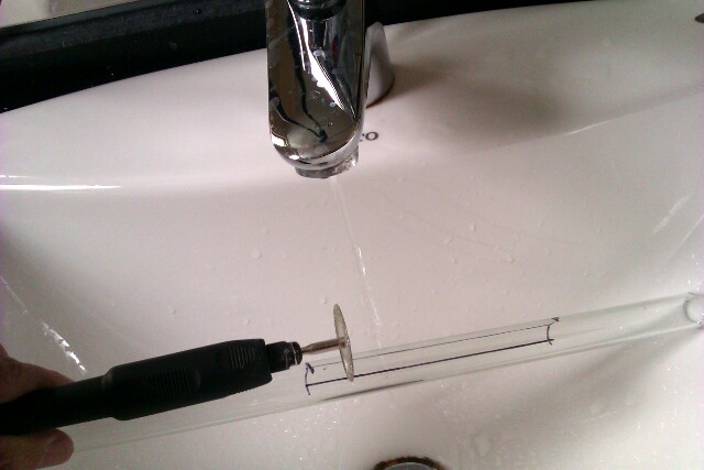

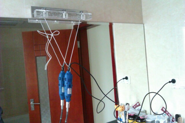

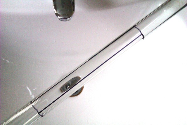

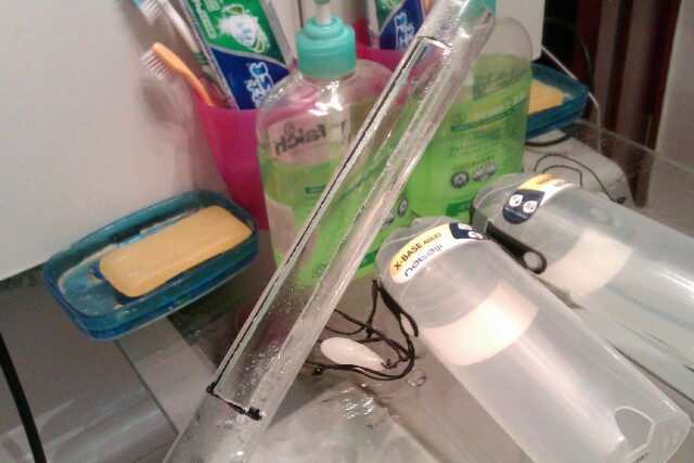

hi,dtut
The tube is a piece of glass tube for liquidometer,I got it from Chemical instrument store.Here are some pics for detail process
1\marking the cutting line by marker pen
2\The cutting tool(electric hand-held grinder & diamond cutting piece )
3\I cut the tube in bathroom,hanging-up the grinder and cutting under the tap
