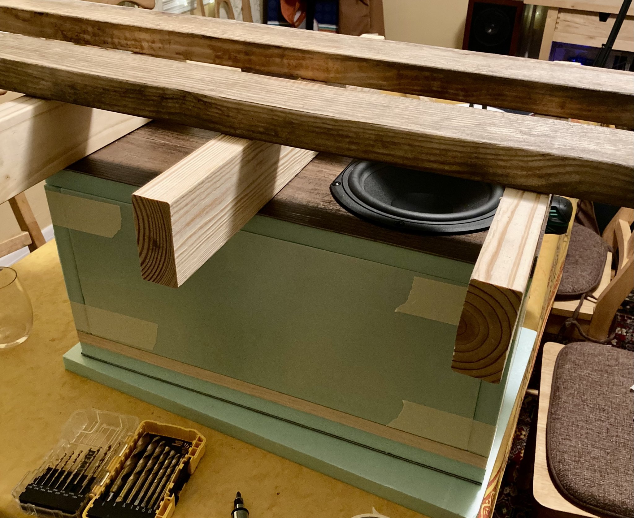

Box gluing progress.
I made a frame of 1.5 x .75” pine glued to the back for a removable screwed-on back panel. Hoping the caulk I’m using will hold well enough to survive a few attachment/removal/reattachment cycles.
I am quickly learning my cabinet making limitations. This box is not square. Off by a sixteenth here and there. It adds up. 😀

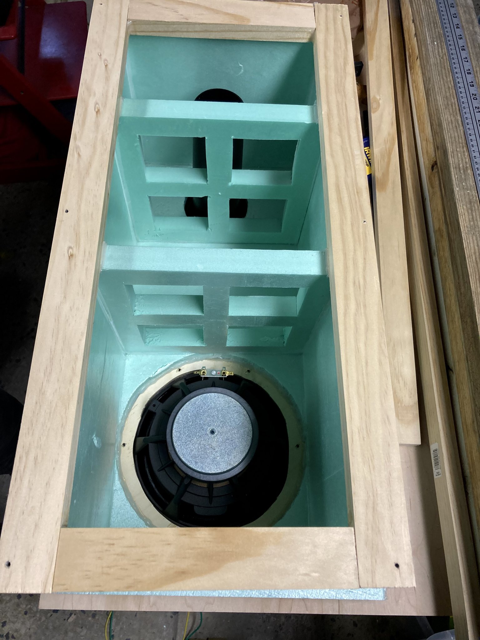

There is promise. I got the major construction of the bass box functional.
The removable back works well. I installed a PE 2.5” flared port.
I played around with borrowing the Manzanita crossover (this iteration is crossed at around 900Hz) plus some resistors to get music to the woofer and a DE360-8 on top. I know this is way less than ideal or scientific, but I am optimistic I can get this ironed out properly. The box works and sounds pretty good. I know I have lots of bracing and dampening to do, but I like what I’ve heard so far. This can be a versatile low end section for a number of 2- or 3-way systems. 😎

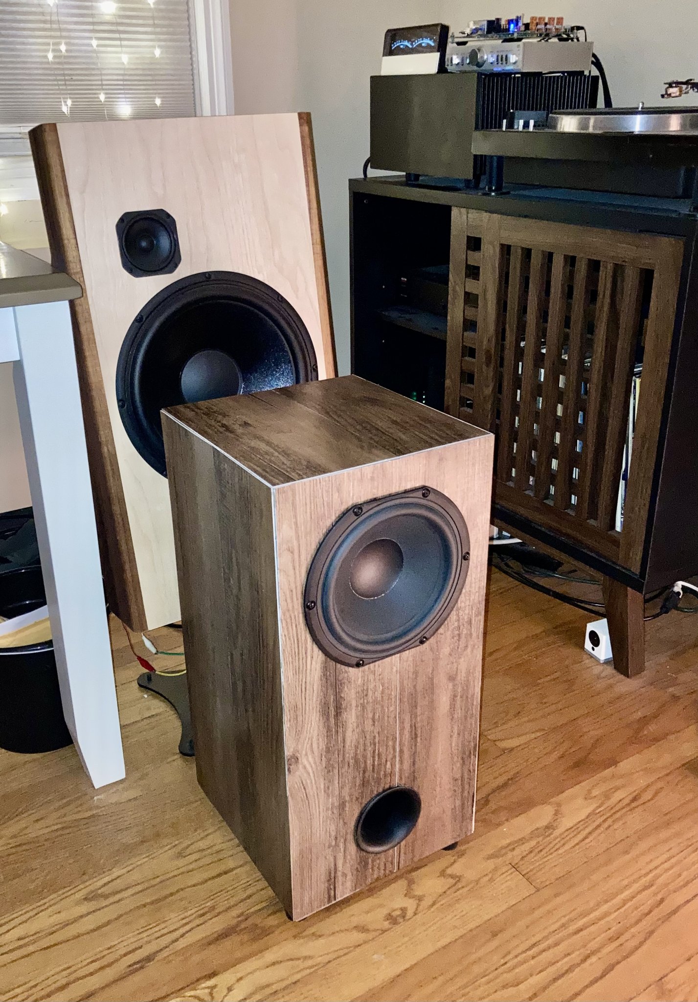

Cabinet 1 of 4+ finished! 🙂
This XPS-plus-vinyl-flooring-skin is slightly lively, but sounds pretty good. I think the window braces may have helped a bit, but they’re not exactly rigid. Having everything glued up secure certainly is better than the previous test with just front and back skins glued on.
I bought noico to line the insides, but thought I’d move forward without it for now. I expect I’ll get to measuring and playing with DSP with the top mid-high cabinets (still planning on trying the Focal-B&C combo first) before finding out how much difference noico/stuffing will make.
Even though this cabinet is obviously flawed, I am quite happy with how it turned out. It’s my first medium sized speaker from scratch. 😀

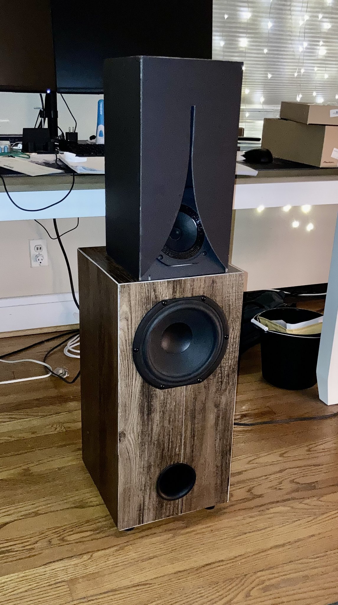

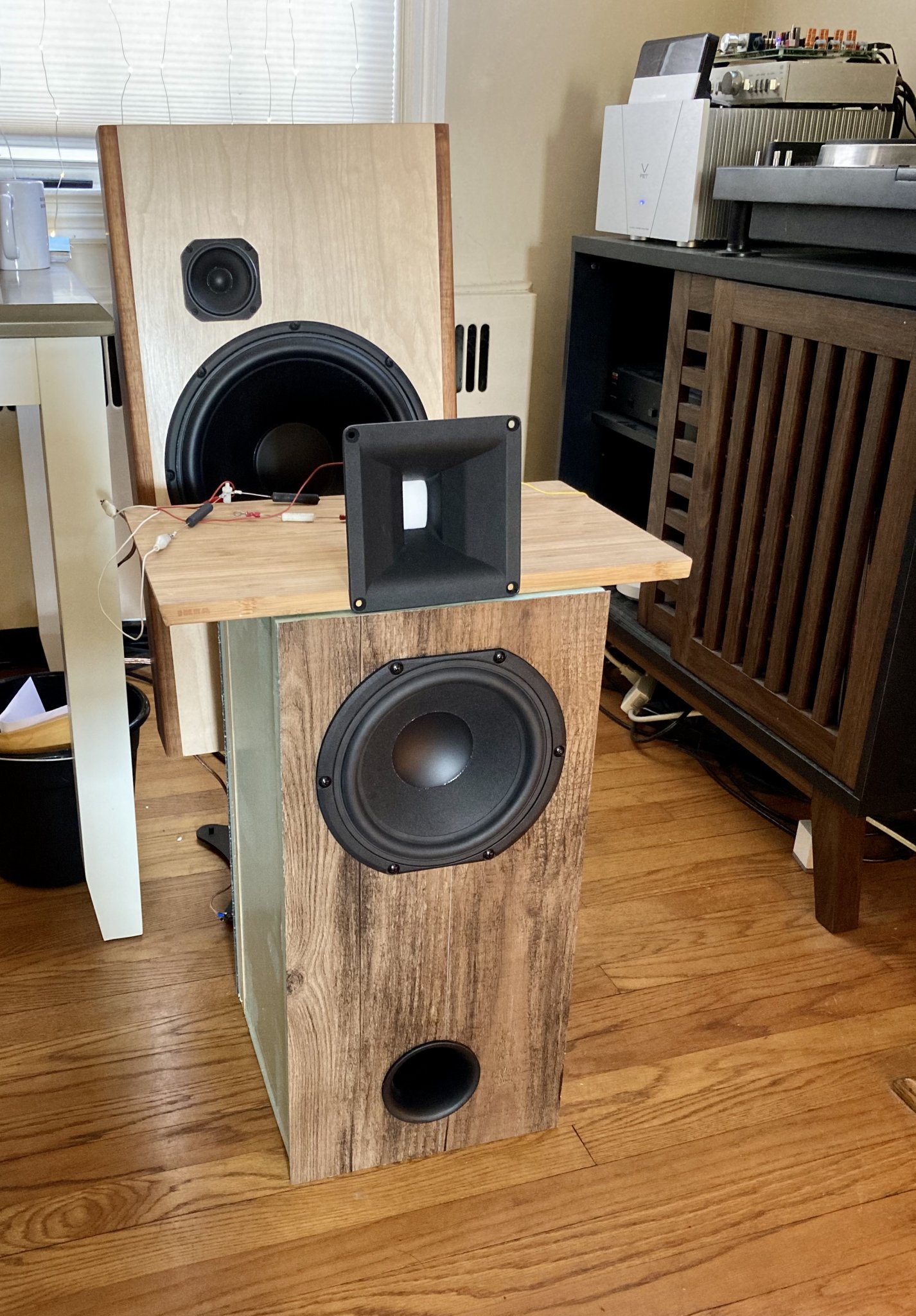

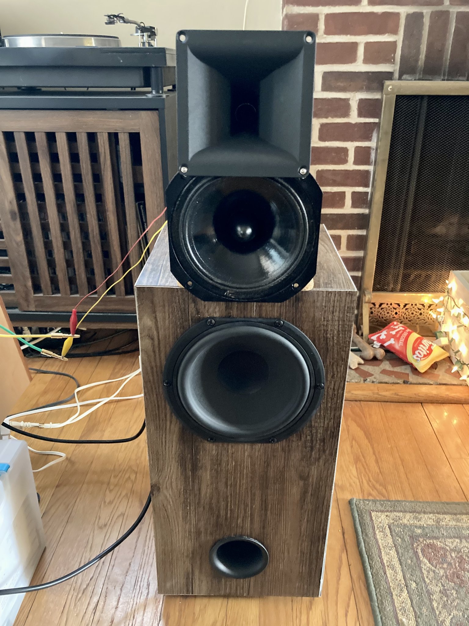

This is good silly fun.
Put my Audax Karlsonator on top. First order passive crossover at about 385 Hz. Padded the Audax down with a couple resistors. Left signal to top, right signal to bottom. Sounds way better than it deserves to. 😎

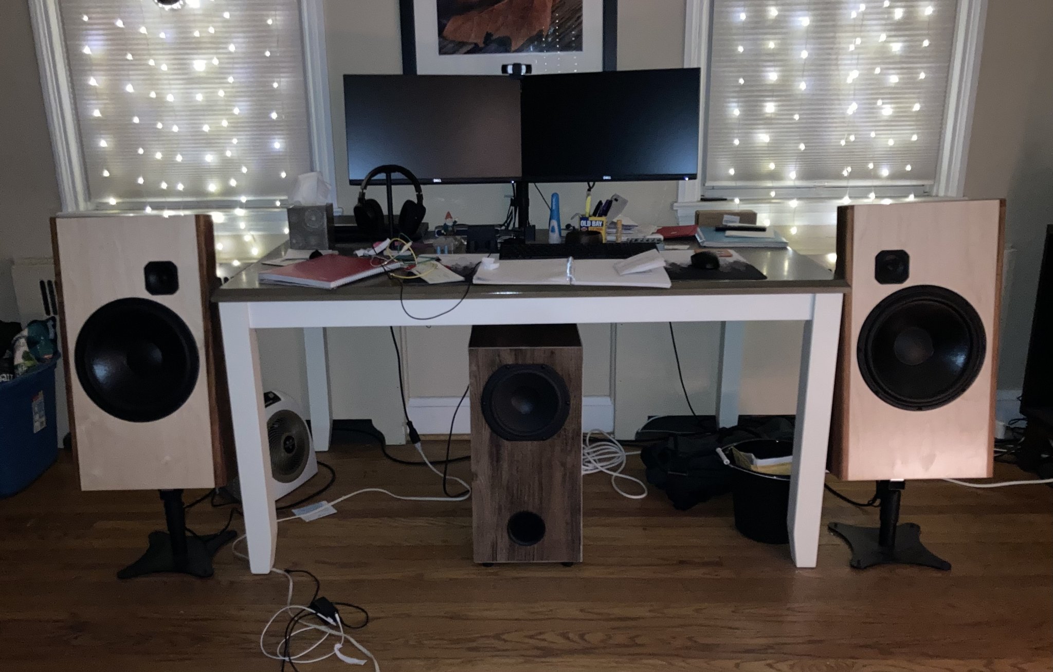

Proof of concept is advancing.
I’m using Tfive’s PulseAudio Crossover Rack (Raspberry pi 4 and Bullseye OS), an ESI Gigaport EX, and three little class D amps. 4th order LR at 300 and 3K Hz.
It sounds really really good, despite cheapie amps and a bit of noise on the CD from the DAC. Hopefully I’ll get measurements over the weekend and maybe play with analog crossover parts.
Fun!
