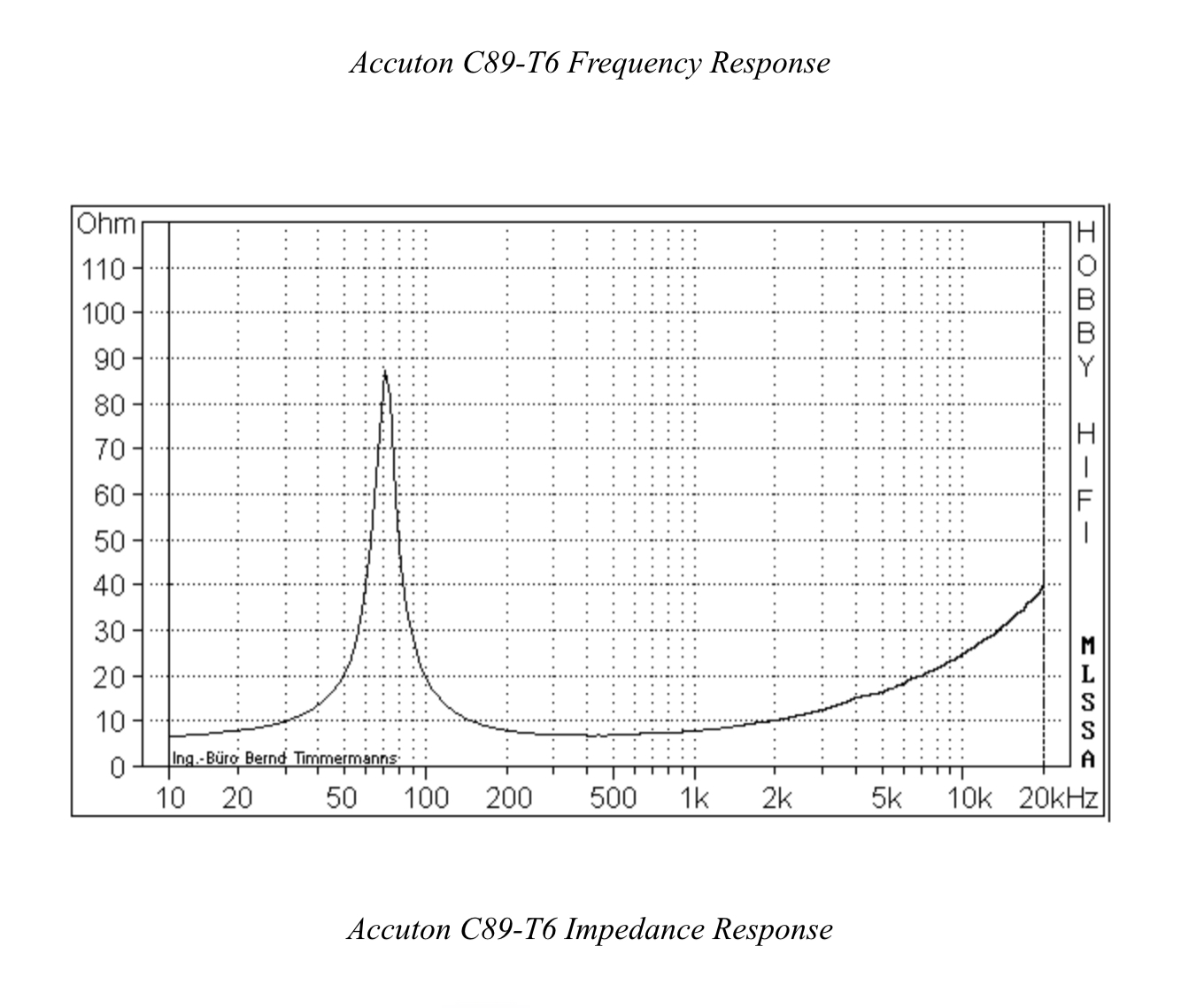

  1. Where can I get data sheets for these older Accutons? I was only able to find an archive pdf of an old Madisound catalog with them listed (attached pics below).

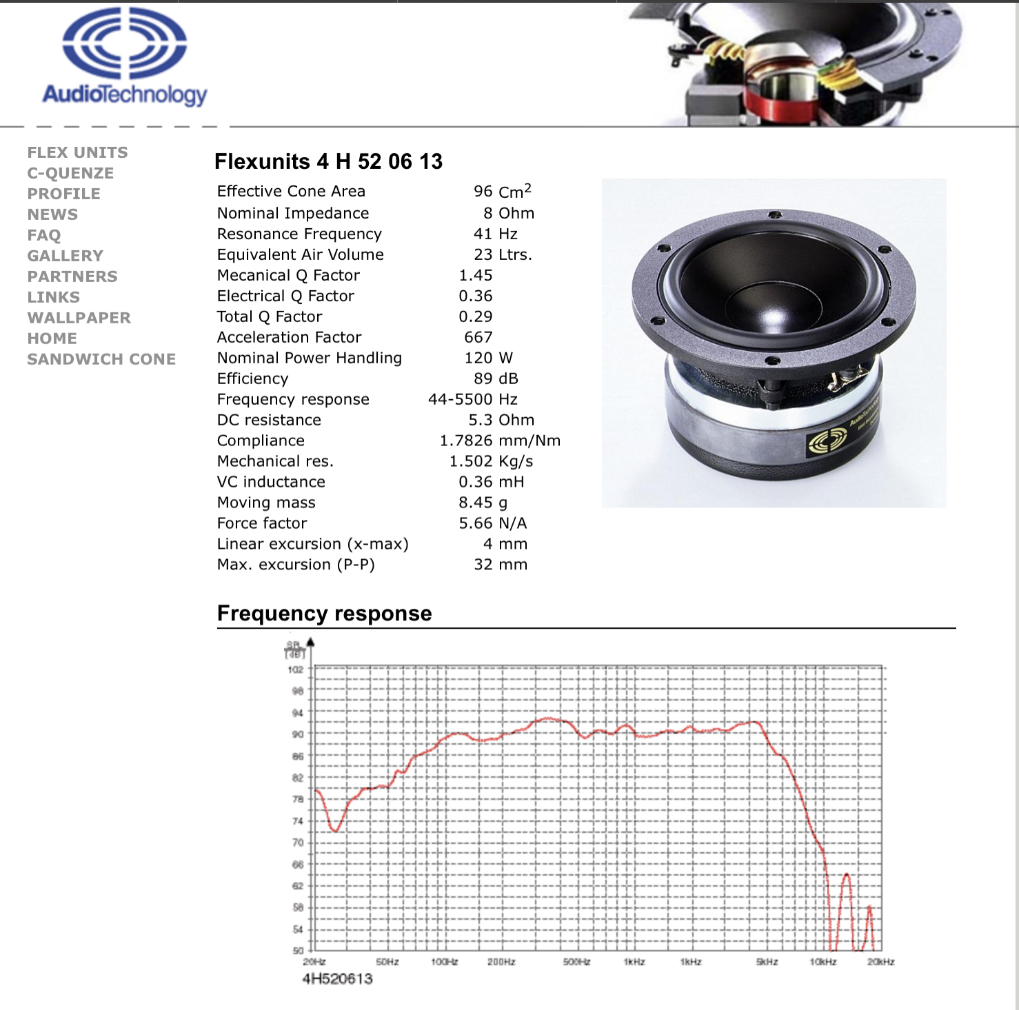

  2. Is anyone familiar with Audiotechnology drivers enough to know the difference between their 5” models?

With the Accutons, it looks like I could cross them at 3k and add a notch or two to the mid breakups.

I will contact audiotechnology to see if I can get data on the other mids.
Joined 2008
The unknown mids are likely an early version of this driver:
Flexunits 4 H 52 06 13
Looks quite capable as a midbass for a small monitor speaker. Possible transmission line loading for low end extension?
I also found impedance curves for the Accutons in the way back machine. They look pretty benign. Multiple accounts here and elsewhere say a notch is a good idea @~3.8k for the tweeter. But it looks like it could be crossed lower…

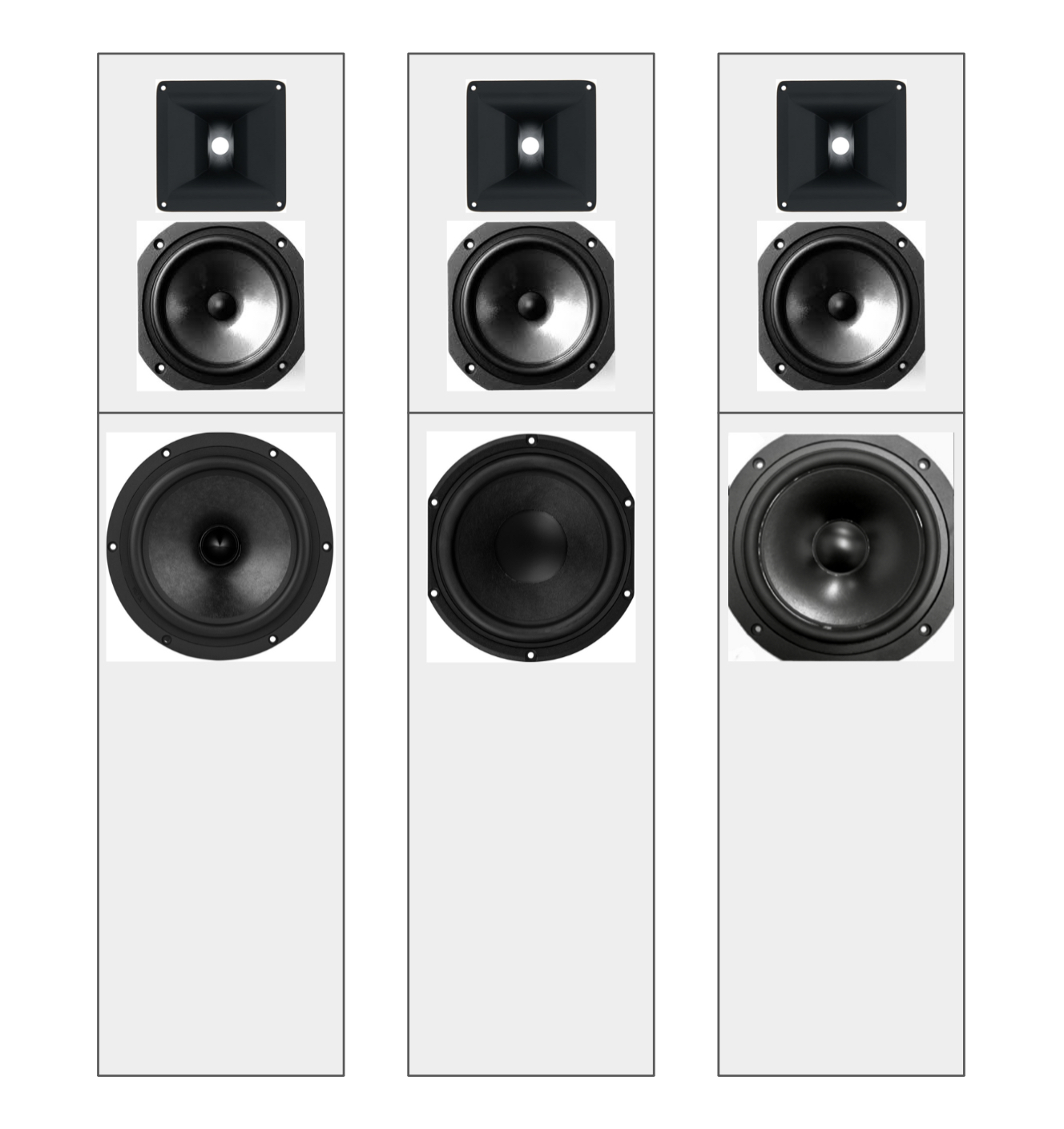

Bumping this open-ended thread with my latest idea.
B&C DE360 on ME20 Waveguides https://www.parts-express.com/pedocs/specs/294-6042--bc-de360-spec-sheet.pdf
Focal Audiom 7 A2 https://site.diy-loudspeakers.com/...t_focal_drivers/FOCAL_MIDRANGE_AUDIOM_7A2.pdf

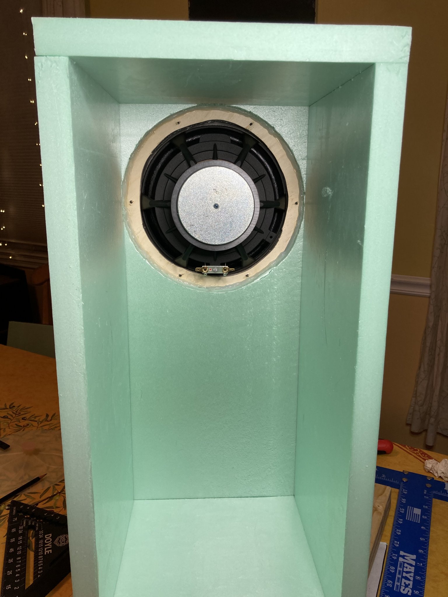

For bass, I’m considering
Peerless P830869 https://www.parts-express.com/pedocs/specs/264-1098--tymphany-hds-p830869-spec-sheet.pdf
Or
Dayton RS225P-8 https://www.parts-express.com/pedoc...rs225p-8a-reference-series-specifications.pdf
Any opinions on choosing between those woofers?
I expect to cross the woofer-mid at ~300 and the mid-tweet at ~3K. I like the idea of highlighting this fancy mid for as much of the spectrum as possible. I could call them 3^3. :D
I’d like to figure out a TL for the woofer (like xrk’s RS225 FAST), but that will likely take a while, so I’ll shoot for a prototype ported box at first. Separate box for the mid. Prototyping will be with XPS, possibly skinned with thin ply or HDF. And I can use the woofer box with prototyping of those other fancy drivers at the beginning of this thread!
Any pointers to keep in mind? I’m going to reacquaint myself with Xsim and maybe figure out that recent TL software…
August will be speaker month. :cool:

Continuing with doing everything possible without actually acting on it…
I think I like the looks of the RS225P better than the Peerless in my expertly rendered concept. :p
I believe the Peerless could go lower, sealed or ported, however.

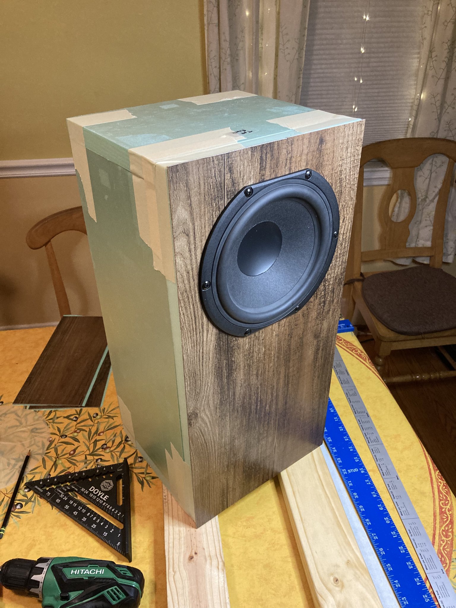

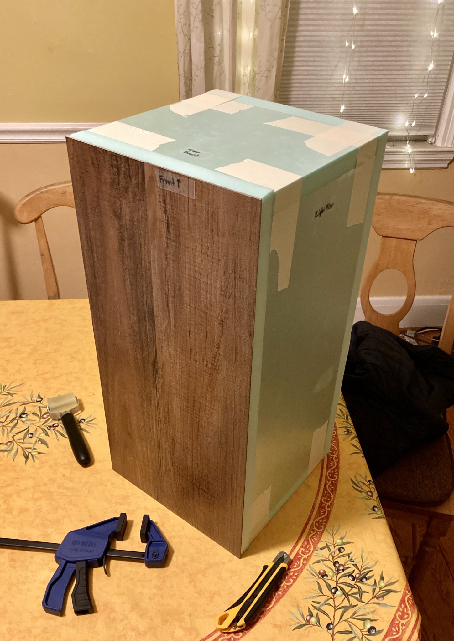

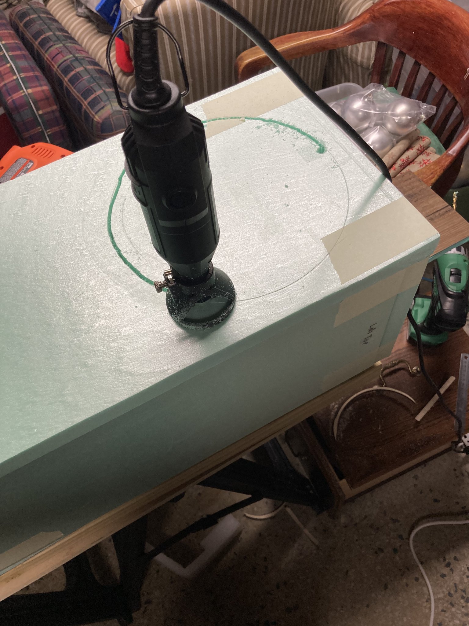

Constrained layers of silliness. I don’t know if this is going to work, but I’m going to try.
My cuts are awful, yet hidden. :D
