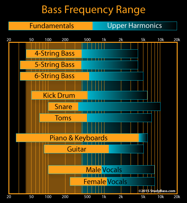

There is a nice chart showing frequency ranges for drums and instruments, from this page:
Bass Frequency Range | StudyBass
I couldn't embed it directly, so I attached it. Despite the "kick in the chest" sensation, the chart lists the kick drum range starting at 50Hz.
I believe you need a very large (e.g. Kodo) drum to generate very low frequencies.
I also poked around some recording/mixing posts from pro audio sites, and some people actually highpass the kick drum between 40Hz and 70Hz to get rid of infrasonic stuff they don't want in the recording! See:
