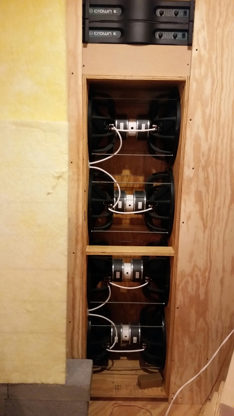

And then there is infinite baffle, in (through) wall, subs that can go incredibly low with very little effort.
8xAE-IB-15. Takes it down so low, it's only limited by what the room size can reproduce. The front wave NEVER meets the back wave.
