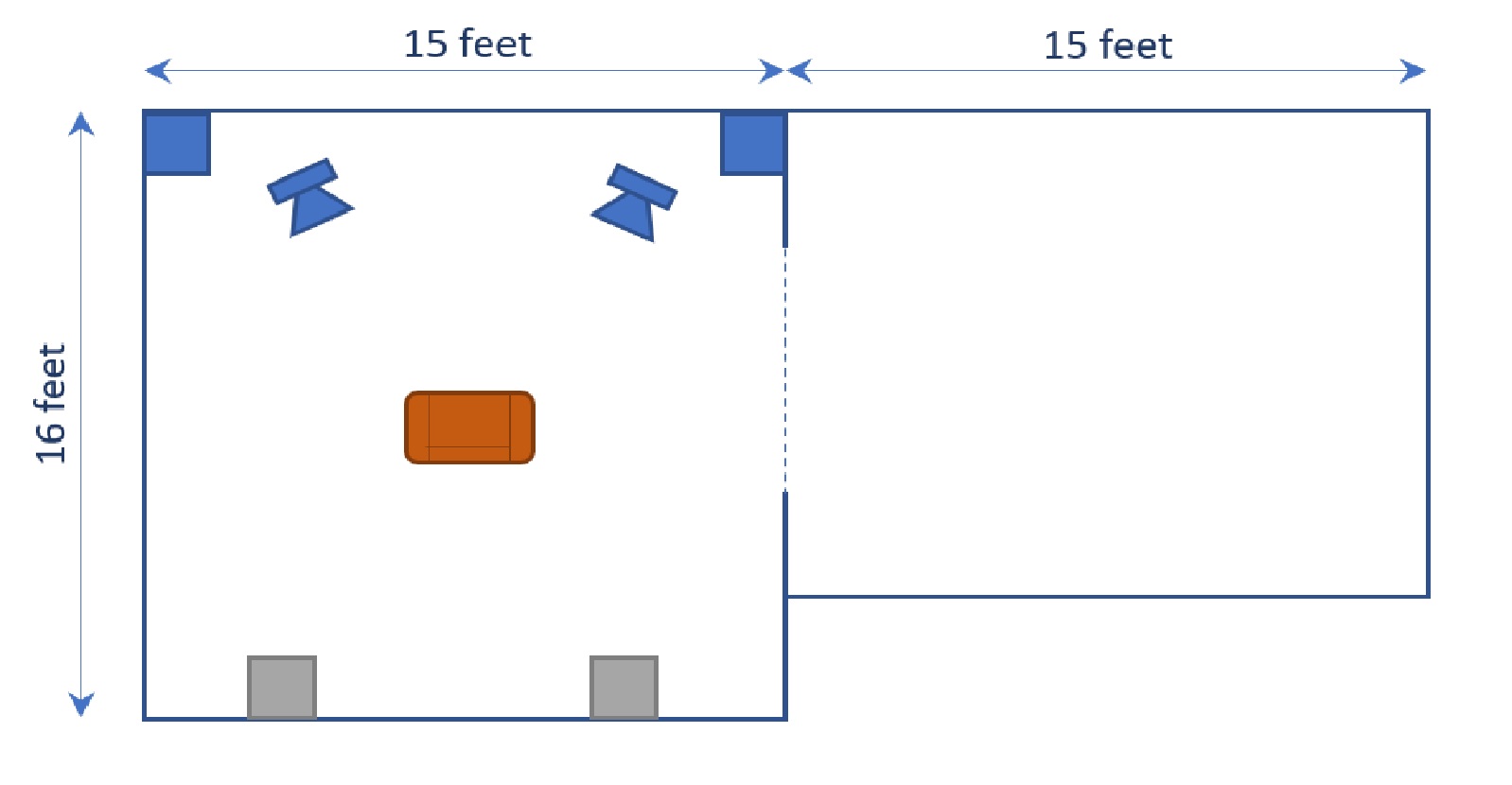

Wouldn't there be equal amounts of constructive and destructive interference?
You might be thinking of room resonances, or of a dipole in an infinite space. It's important to consider how a dipole generates sound and how the dimensions of the room can limit the low frequency response. Let me give some background on that:
A dipole is a velocity source, which is very different from a monopole (a pressure source). In a dipole, the front of the cone is pushing air while the back is pulling it. The air is flowing/sloshing back and forth in the room between the front and rear "sources" and this air "movement" generates sound that we can hear. I do not know the exact physics of it, however, for a dipole to create a wave of a certain wavelength, that wavelength or a good portion of it must "fit inside" the room dimensions. So, for example, the wavelength of a 20Hz tone is almost 60 feet long, 30Hz is about 38 feet long, 40Hz is about 29 feet long, etc. Do you have that much listening room at your disposal? If not, I would advise against trying to deploy a dipole subwoofer, or at least that a consideration of the room size should be used to determine how low the dipole sub can be expected to operate. Unlike a monopole sub, making a "bigger dipole" will not improve the situation because it is limited by the room itself.
One way to get around this is to place a large dipole subwoofer very near you, so that you are within the nearfield of one side of it and farther away from the other one. For example, you could set up a U-frame with the "Front" driver right behind your listening chair, and the "rear" line of the U-frame extending away from you. But you will still need a certain amount of space behind the listening chair for this to work properly.
Yes, my Dipole HT sub's in-phase output (from it's front vent's) is about 2 feet from the front row listener's heads and the out-of-phase output (from it's rear vents) is about 3 feet from the rear row listener's heads (..this is when the seats are typically reclined).

I find that you can get closer to the tactility of monopole subs if the dipole subs are positioned near field i.e. within a metre of the listening position or closer. There is no room pressurization but your body will feel the pressure of the air movement more viscerally due to the close proximity.

There is no way that you are going to get the infrasonic "tactile" response of a large monopole (e.g. closed box) subwoofer when using a dipole sub. The monopole can pressurize the room and the dipole cannot. Case closed!
A dipole subwoofer is only going to get you down "so far". That CAN be 30Hz, or even 20Hz, if you have a really large room. But never lower than that, and often a dipole starts to poop out at higher frequencies in medium and smaller sized rooms, or when not designed or EQ'd properly for the application.
Since even relatively large monopole subs can operate up to almost 100Hz nicely, why not take advantage of that fact to anchor the bottom end, and then cross over to the dipole in the 80Hz-100Hz range? This will work best for "most" DIYers IMHO.
You can even operate the dipole and the monopole sub together over some band to get a cardioid (NOTE that they must be operating at the same SPL over that band for form a cardioid). So for example, you could operate the closed box sub up to 120Hz and the dipole down to 60Hz, and between 60Hz and 120Hz you get a cardioid pattern. By using a flexible and capable active crossover, you can try out various options by changing crossover frequencies and so on.
The other advantage that a monopole sub has over a dipole one at low frequencies is that, for the same on-axis SPL, the total radiated acoustic power is 4.77dB higher for the monopole, e.g. it will seem "louder". Once you get below 30Hz you need all the output you can get to make up for the dropoff in hearing sensitivity.

Thanks for that. I was thinking of the waves reflecting around the room. As you say it's the difference between a velocity source and a pressure source in a room, I'm not sure how that works though.You might be thinking of room resonances, or of a dipole in an infinite space. It's important to consider how a dipole generates sound and how the dimensions of the room can limit the low frequency response. Let me give some background on that:

Are you able to do some basic tests with scrap baffles and such in your lounge room?
I have had good open baffle systems and if I had no cost constraints, WAF constraints or neighbor issues (I live in an apartment) I would run pair per side 12" servo subs to around 40hz-60hz with room correction for the subs. Crossed to 15" pro audio woofer. But big dipole woofers work well too if you have the space for lots of large woofers in your room. I have tried both ways when I lived in a house.
Hey frangus. Thanks for the interest in helping!
I do have a dipole system except for the subs, including 18" baffleless midbasses that get to 65Hz. I was thinking about your same lines, but after considering several inputs from knowledgeable dipole users such as Charlie and Danny Richie (GR Research), the room I have and the constraints (WAF, furniture, etc) I am steering towards adding a couple of sealed servo 15" and a MiniDSP to set up a distributed bass array.
If I had less constraints I would probably turn around the setup firing into the 10m length and try OB subs as you mention, and maybe use the existing sealed subs to supplement the lowest octave.
But have to work with what I can do, and it's really not bad at all!! Dipole midbass from an 18" is pretty good, and so is midrange and treble. Glad I tried them!! Also glad I tried MTM with 8" mids and a large tweeter, despite common wisdom suggesting lobbing would be awful, but it isn't.
