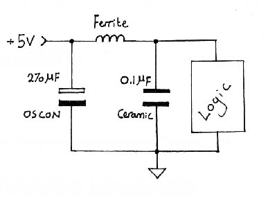

My latest idea about digital supply decoupling.
Here is my latest idea about digital supply decoupling
- A 0.1uF ceramic capacitor provides localised decoupling.
- A ferrite bead reduces RFI in the supply line.
- OcCon electrolytic provides low frequency decoupling.
- The tendancy of ceramic capacitor and the OsCon to self-resonate is reduced by placing the ferrite bead between them.
See attached file...
Any comments?
Is this good practice?

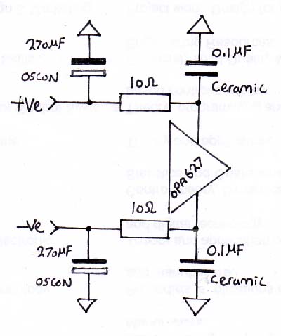

My idea for the analogue supply...
Here is my 'idea' for the analogue supply of my op-amp. Resistors dampen the tendancy of the ceramic capacitors to resonate with the OsCons.
Should I use ferrites in the supply lines too?
Re: My idea for the analogue supply...
Oli said:Here is my 'idea' for the analogue supply of my op-amp. Resistors dampen the tendancy of the ceramic capacitors to resonate with the OsCons.
Does this not increase PS impedance? Why need OSCONs for analogue PS, and why place Rs behind low esr cap. Just examine the PS to see if it rings or not!
Fair comment
Fair comment.
I could attempt to parallel the ceramic and the Os-Con first and see if it rings.
Again I would still use a ferrite in the digital supply to reduce noise induced in the supply lines by the logic.
and resistors in the supply line of the op-amp to reduce the frequency of circulating RF currents to within the power supply rejection limit of the op-amp.
Does this seem a better arrangement?
Any idea about ferrites in the op-amp supply?

You could start from the simplest base. Use separate PSs, implememnt good practice on digital supplies. Buils lowest noise and lowest impedance analogue PS. Measure these with a wide band ac volt meter (10 uV full scale minimum,>1 MHz) and also look at the trace using avery wide band scope. You can easily be deceived by a 20 MHz scope!

Re: My latest idea about digital supply decoupling.
Forget about good practices. Put the caps in the circuit and listen. I will not touch OsCons, as those were the worst sounding caps I tried. BG N type were much better in digital and analog decoupling. I'm using small values at the moment (4.7U) and even those sound much better than all the other caps I tested.
That is exactly my experience. But you have to dip them into snake oil three nights before the full moon.
