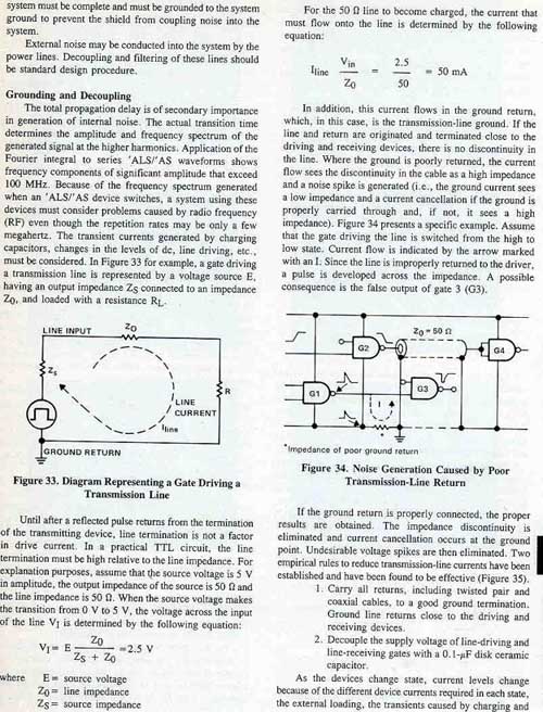

The sizes of resistor in the data lines and clock line must matter:
I was going to make a big deal about the pulse width a 100Mhz, but suddenly I remembered the output of Elso Kwak's clock looks nothing like a square wave- any resistor in the data line may distort the waveform and induce jitter. Agree? No resistor in clock line?
How can you calculate the correct resistor for a given frequency? (or is it more a rule of thumb?)
In particular I am concerned with the Sdata, Sclk, Bclk lines. Will 100R do?

Elso,
Your correct the ALS according to the TI data book is good for 100MHz clock max, and I bet that really pushing it.
ALS logic
Huh,
then there is a big difference in max. permissible clock speed between Fairchild and TI.
I looked it up in the TI datasheet. The 100MHz is for the AS part. The ALS part has the same fmax as the Fairchild part.

Re: Personally I will not discount any reasonable ground scheme
Hi Oli
The value is the tradeoff: It defines the slope of the clock / data signal:
- higher slope means (in general) smaller chance of induced jitter
- lower slope means less current generated (also in groundplane)
Less RF current also means lower jitter
I findvalues between 22 ohm and 330 ohm in practice. Audible difference appear, so it might take a while to tweak them
succes

Guido,
Cheers for the info.
I feared it would be one of those 'listen to it' choices!
Thinking back to your ground plane theory, I intend to use a number of different power supplies to isolate analogue, digital, PLL and reclocker circuitry.
Q. Do I connect the grounds from these supplies at a single point on the plane?
Q. The idea is to allow return currents to flow to ground, but to avoid 'series type' grounding i.e. digital ground connections between PLL ground and ground supply terminals. This would lead to undesireable potential differences. Ideally each type of circuitry should in in line-of-sight of the ground. Is my understanding correct?

Re: Cheers for the info.
Hi Oli,
Q1: I'd say:
" connect the grounds from these supplies closest to the chip(s) they supply "
However, it depends if you add series beads and / or resistors in the supply lines. If you do that (reccomended) the RF supply currents will be greatly reduced, and so are the ground currents. In that case, it does not matter that much where to connect the grounds of the various supplies involved.
Q2: Understood correctly
cheers

Frank,
I am not sure what you stating here, however to decouple HS logic can take multiple caps including a .1 and .01 and even smaller depending on ringing frequency
Of course there are other thing we can to to improve this.

Oli,
You could but I would use smaller value from the application notes. A value from 50 to 100 ohm will work ok. Also, don't use a Metalfilm reisitor, they are sprial cut with a laser which causes some inductance, which is not good. Use a carbon film in this application.
Carbon film?
Okay, I'll try a lower value of resistor.... say 100R
Metal film inductive?
In your view is higher thermal noise of carbon film less of an issue?
