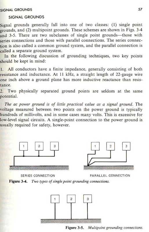

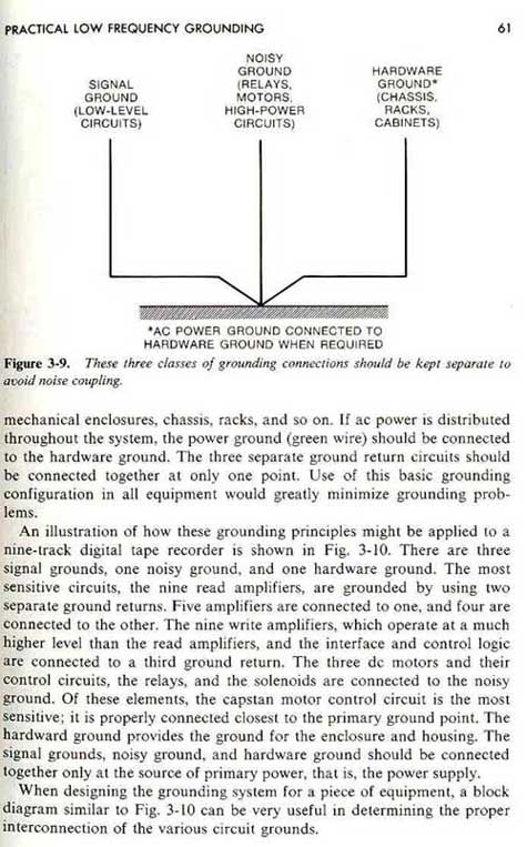

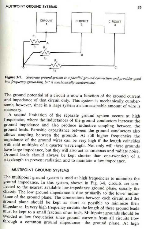

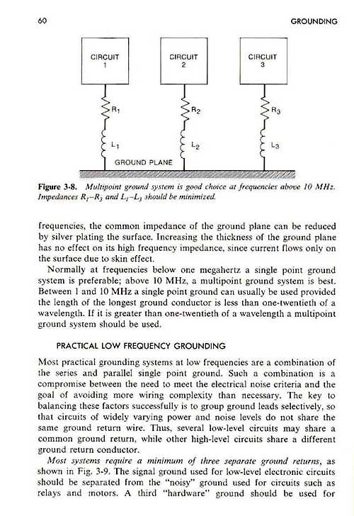

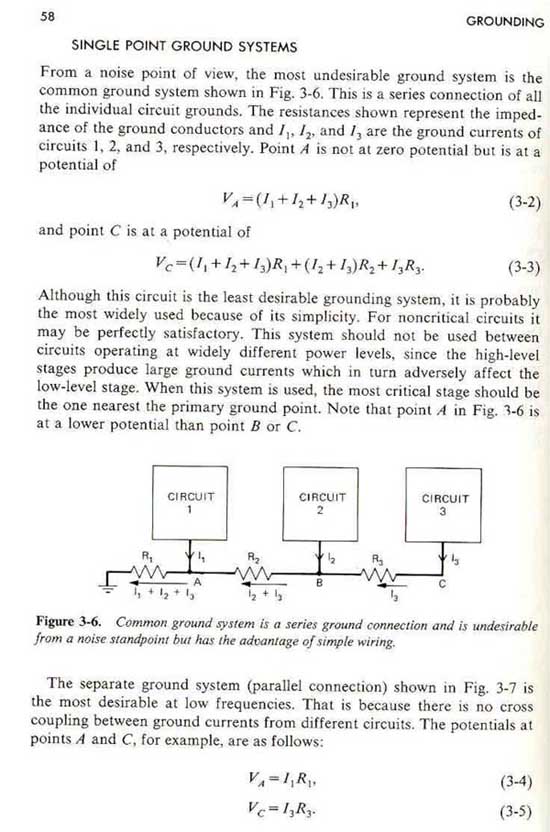

If you have to use one ground plane, it should be continuous. Havening the plane on the bottom connected via feed through is ok, but the plane has to be a continuous plane.
Still the optimum way of connecting mixed signal with precision converters is to use multiple continuous ground planes.
This information is from Noise Reduction Techniques in Electronic System by OTT, Bell Labs ,ISBN 0-471-65726-3 and is considered the bible on noise reductions methods.😉
From my interpretation of the references shown in the last few postings, it would appear that in my application that using separate ground planes and hooking them up at a point of my choosing (the "star point") is preferable.
I guess Guido will disagree
