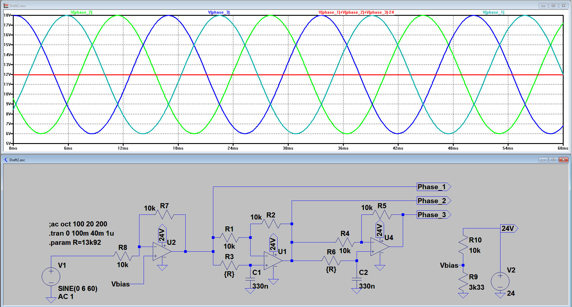

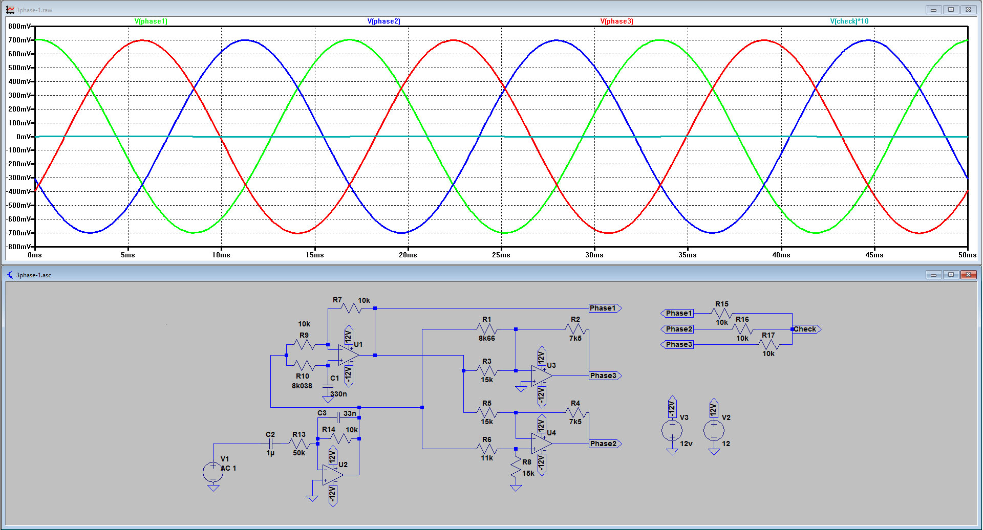

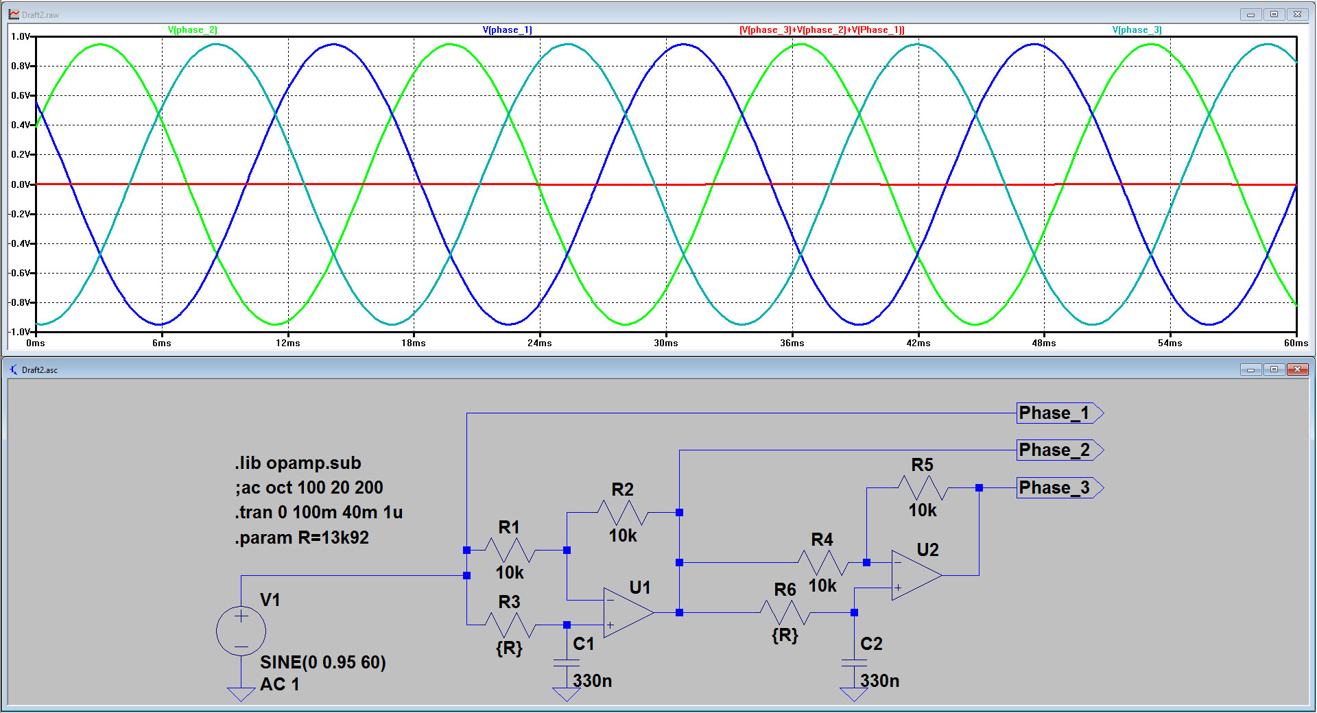

So If you have one Sinewave generator, I stick to my earlier circuit diagram in posting #151. So for a 3 phase motor you will need a dual opamp. For a two phase motor just one opamp will do.
Here is the simulation for a 3 phase version, including the addition of the three signals showing that their phase is correct.
Hans
You are right about the opamp supply. What you need is a +/-15 Volt supply to cope with the output of the generator.. If you look at the third page of the spec sheet you will see pin 4 is marked Vcc- and pin 8 is marked Vcc+ in the table right below the pinout on the same page it says pin 8 positive supply, and pin 4 negative supply. On the 4th page of the spec sheet table 7.3 gives the recommended voltage at 5-15 volts positive and negative. I just figured that it would be appropriate to use a 12V supply because I thought they'd be readily available, could be wrong about that though, as I haven't found a suitable supply yet. I learned a painful lesson by buying a single rail positive supply for my amps that I used in the first iteration of this project, they required a 50V dual rail supply, 50V+ and 50V-.

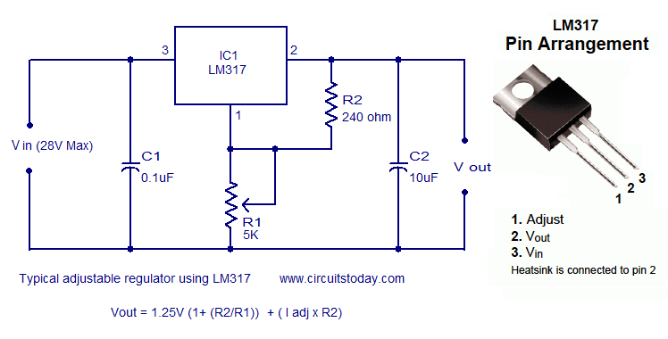

Don't know if this fits, but th tle2426 can be used to split a single supply into a +/- supply. It may not have the current requirements, but my phono stage uses it to supply some lm4562's opamps.

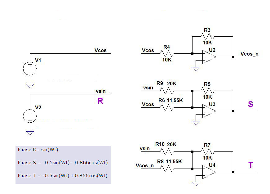

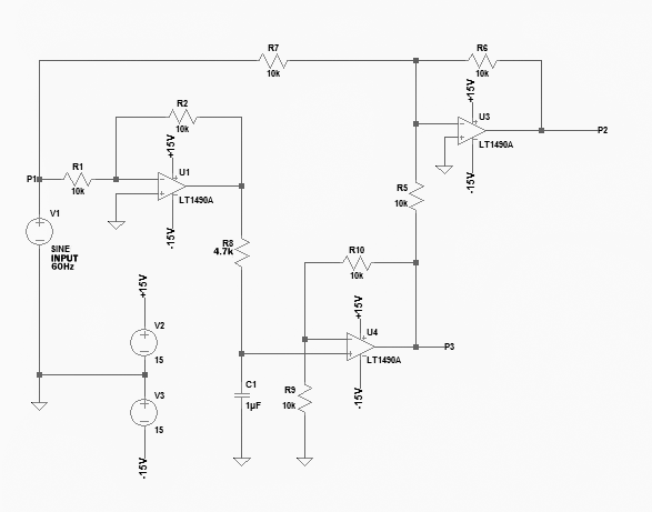

You can do quadrature to 3 phase with 2 opamps (plus one for a virtual ground):

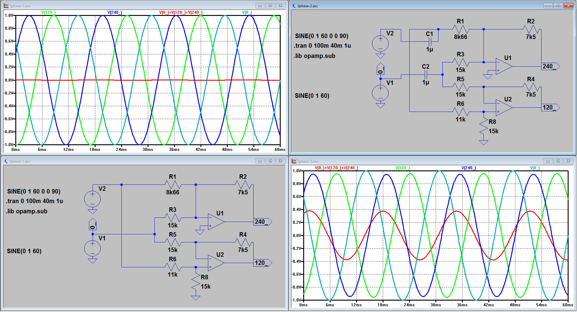

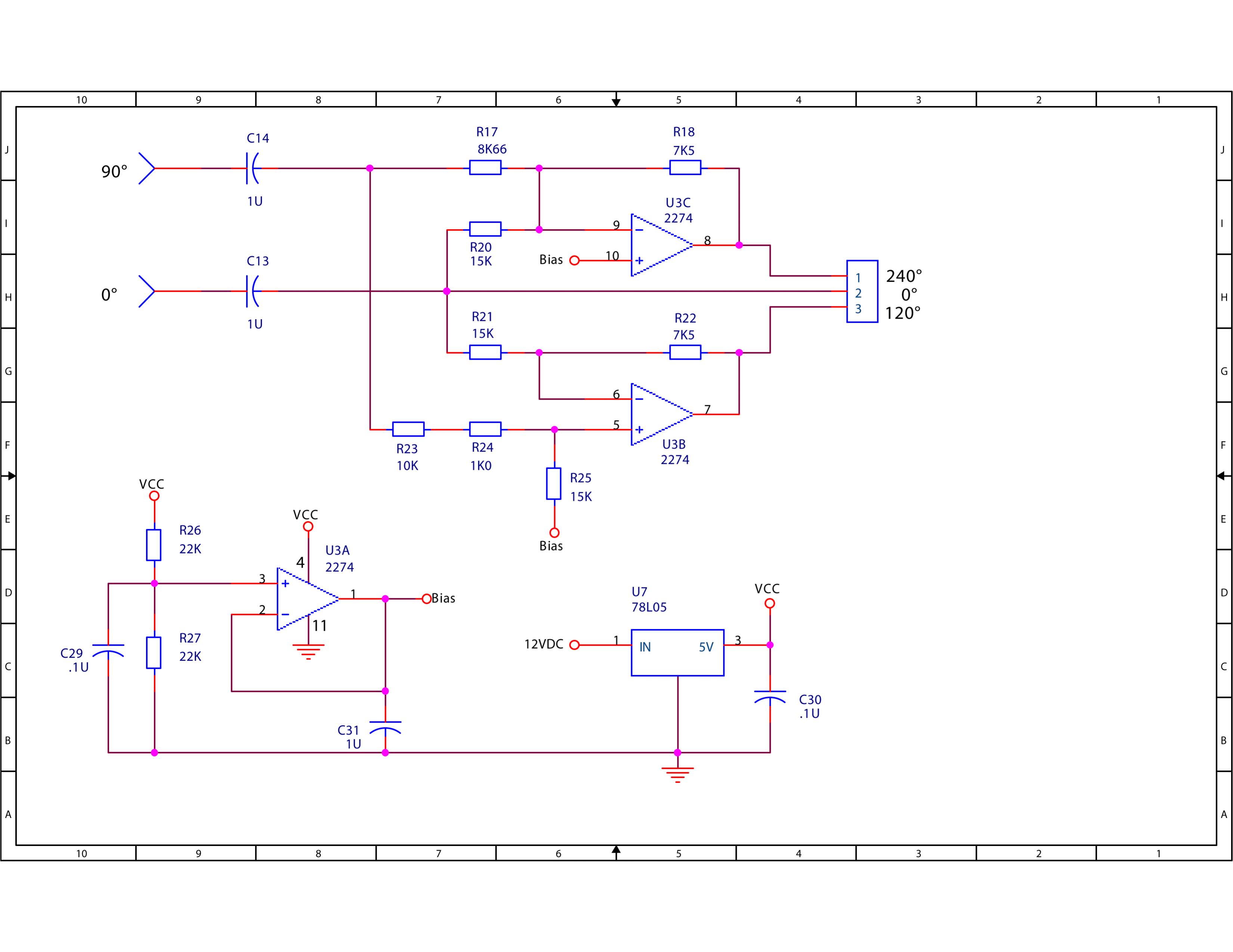

Hi Ralph,
I like your design with a sine and a cosine as the input signals, but you will need an extra opamp for the 90 degree phase shift, just to make the 33 1/3 to 45 RPM adjustment with one resistor instead of with two resistors, but it will work fine.
What I like less is to drive the 2 opamps generating 120 and 240 degrees with a capacitor. This will ruin the phases.
Just to illustrate, see the simulation below, with and without caps.
Look at the red line where the 3 phases are added. This should be a flat line.
Playing with different values does not make it any better.
So to my opinion, there should be no caps in the signal line.
But I followed your idea to using a single supply, in this case the same 24 Volt as used for the main amps steering the trafo's.
This will result in having to use an extra opamp, but also in 3 caps to drive the 3 amplifiers (not shown here), but these caps are highly uncritical in value and accuracy as long as they can pass the 60Hz without attenuation.
Because I do not know the input impedance of the main amps, I cannot give a value.
Hans
The input caps just need to be larger. You can see the amplitude of V120 and V240 are lower than V0, so the caps are attenuating the signal as well as shifting its phase.
Unfortunately it is not that simple, as I said I played around quite a bit but could not get it right.
That is what I did with the single phase input, but with a sine and a cosine to start with, you will need yet another opamp giving a total of 5 opamps, where I only needed 3.The caps are necessary unless the DC offset of the signal generator is also VCC/2.
Hans

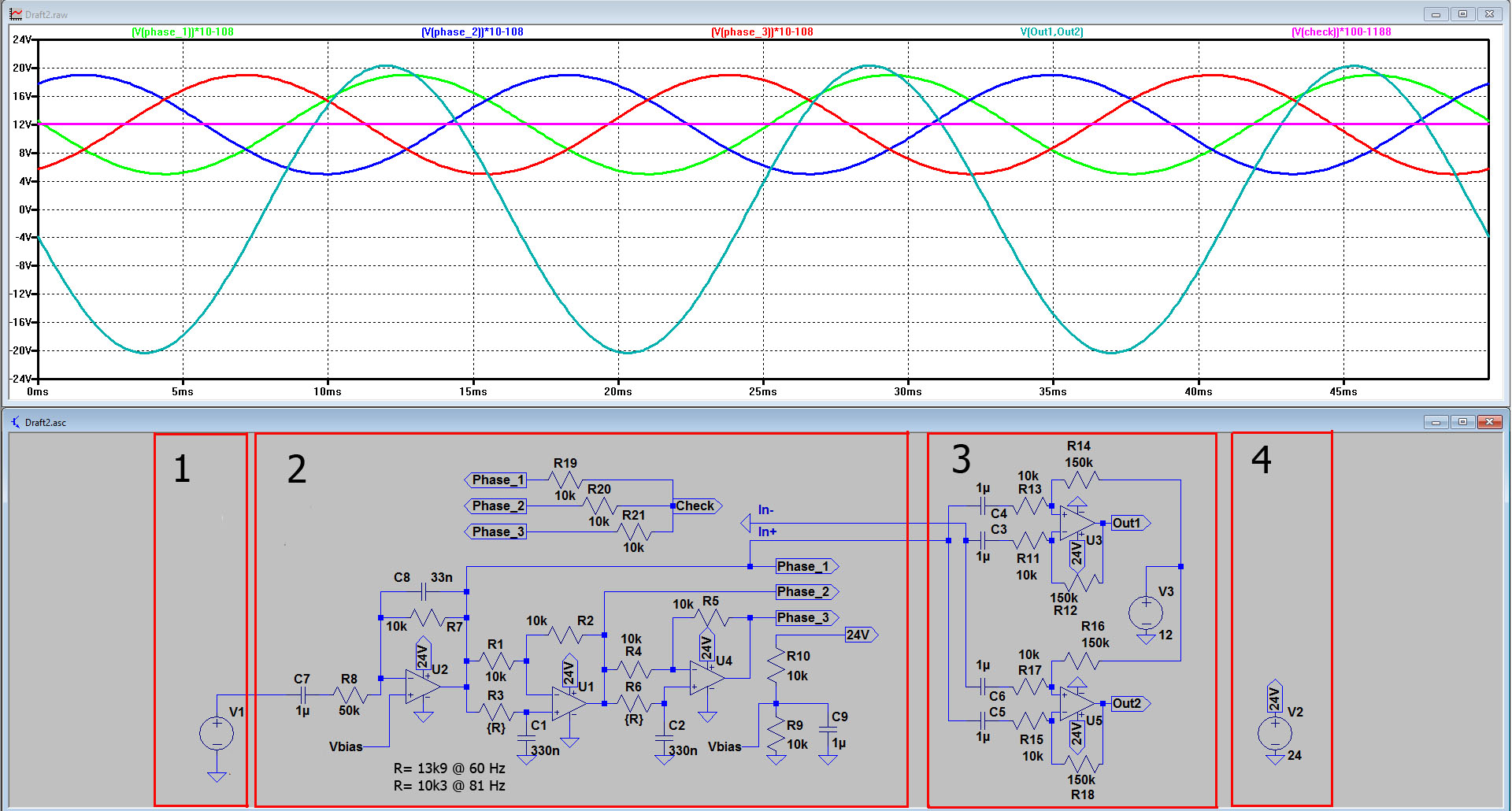

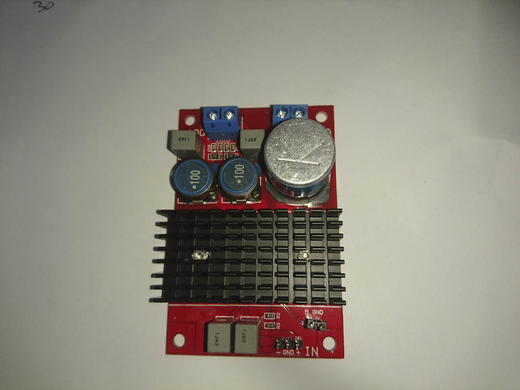

Hi Hans, the little 100W class D amps I have are AC coupled, they have a balanced input, and each side has a 1uF 63V cap. If you're using them single ended (as I am) then the -ve input is shorted to gnd. You can see the input caps at the bottom of the picture
Ralph kindly made the important info available regarding the input circuit of the Main Amps that he is using.
They are perfectly suited to steering the trafo's.
Since these amps have ac coupled inputs, the phase signals offered at their inputs can have a DC component without any consequence.
For that reason, the opamps in the phase splitter can be fed with a single supply, in this case I have used the same 24 Volt that is used for feeding the Main Amps.
In this way no extra hardware is needed for supplying the phase splitter.
The Main Amp has a gain of ca. 30 dB. Maximum output with 24 Volt supply will be 15 Veff because the Amp has in fact two active outputs working an antiphase.
This corresponds with 30dB gain to an input voltage of 0.5 Veff.
0.5 Volt is on the low side as an input for the Phase Splitter. Therefore I have given the Splitter a Gain of 1/5, resulting in a maximum input of 2.5Veff.
The opamp at the Splitters input doing this attenuation, has a cap on its feedback resistor, effectively serving as a low pass filter, thereby eliminating the need to place filters before every Main Amp.
Because it is not known whether the used Sinewave generator has a DC component, I have inserted a 1uF cap at the input of the phase splitter to block DC from the generator.
I will present two possible circuit diagrams, one with a minimal amount of components, but with 2 RC combinations to set 33 1/3 or 45 RPM.
The other circuit diagram proposed by Ralph has just one RC combination to be changed when switching RPM. Everybody can choose what fits best to his taste.
Below you will find the first variation, the other circuit diagram will follow shortly.
The four blocks you see are resp. for 1) the Sinewave Generator, 2) the Phase Splitter, 3) the simulation of one main amp with its balanced inputs and balanced outputs and 4) the 24 Volt power supply for supplying both Main Amps and the Phase Splitter.
The only voltage for the Phase Splitter that should be stable is Vbias with C9 to filter the supply voltage.
Opamps have a high voltage supply rejection ratio and are O.K. without filtering.
What still should be added is a 100nF ceramic cap directly at the supply pins of the opamps, not shown in this circuit diagram.
The upper figure shows the three phases, DC shifted by 12 Volt to put them in the middle of the voltage supply. I have magnified these waveforms in the figure by a factor 10, to make them easier to see.
At the same time I have added 3 resistors, R19-R21 that serves as an adder of the 3 phases.
This "Check" signal can be measured with a simple multimeter and should give a reading that is at the most 10 mVeff with 2.5 Veff input signal.
If not, the RC combinations R3/C1 and R6/C2 are not accurate enough and will need further adjustment.
In the figure I have magnified this signal a factor 100 to prove the correctness of the 3 phases in amplitude and in phase.
You also see the signal between the output pins Out1 and Out2 of the main amp being neatly symmetrical around zero Volt, showing that all DC has been removed.
Hans
And here is the circuit diagram for the second version with only one RC combination to be switched when going from 33 1/3 to 45 RPM.
There is one thing very strange about this diagram.
The moment I apply a bias to opamp U3 and U4, phase2 and phase 3 are no longer correct in amplitude and in phase, and I found it almost impossible to get it right.
However when all signals are centred around zero volt, everything is O.K.
That is why for this circuit I used +/- 12 Volt.
The +12 Volt can be taken from the 24 Volt, but the -12 Volt has to come from an external source.
I havent attached a Main Amp, because that brings nothing news,
The rest should speak for itself.
Hans
Hans
