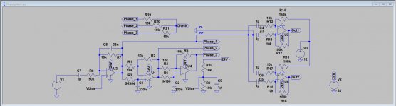

Only posting #180 used a separate -12V power supply, but you must forget this version, it was superseded in posting #192 by only using the Main Amp supply.
So in all cases, you only need a power supply for the Main Amps, that one will also supply the phase splitter.
And you can use either #179 or #192.
But I am adding another idea to make #179 even more universal.
You can use it for 3 phases like shown in #179. When switching from 33 1/3 to 45 RPM you will have to change two resistors R3 and R6, with values as mentioned in the circuit diagram.
However when using it for 2 Phase Motors, with the right resistor values for R3 and R6, you can use output Phase_2 for 81Hz and output Phase_3 for 60Hz. So when switching from 33 1/3 to 45 you don't have to switch resistors, all you have to do is to take the other output.
Once adjusted, you will never have to touch the RC networks again.
That makes this circuit very universal in its application, switch nothing with 2 phase motors and switch 2 resistors with 3 phase motors when changing RPM.
See the correct values below for 2 Phase motors for 60Hz and 81Hz.

Hi Ralph,
If there is any confusion, let me repeat that just one power supply is needed, the one feeding the main amps.
This power supply will also supply the phase splitter.
So whatever has been mentioned about +/-12 or +/- 15 Volt, that can all be scrapped, because the Main amps have AC inputs and don't care about DC from the phase splitter.
That is why I have also inserted schematically one Main Amp in #179, to show that its output is free from DC, despite the fact that the phase splitter has 12V DC on its outputs.

Now you have two Phase Splitter versions to choose from:
One version with 3 Opamps and 2 RC combinations to select RPM. (posting #179)
A second version with 5 Opamps and 1 RC combination.
Both will work just as well, so it's up to you.
Hans

No, with #192 you have to switch one resistor, use 5 op amps and a a number of 0.1% resistors.Hans, If I understand this quote from post 192 that with this circuit I can build a splitter that will handle both a 60hz and 81hz signal from the generator, without switching resistors in the splitter, only downside is 5 op amps instead of three? If so, this is the solution I'd like to take. BTW, I am only interested in the 3 phase version of the splitter.
With #179 you have 2 resistors to be switched, use 3 op amps and no precision resistors.
Hans
Hans, can you see any reason why the #192 circuit needs 0.1% resistors, but the #179 doesn't.
Is this still the case if #192 is run with a split supply?
Is there any chance of getting a copy of your LTSpice files for further investigation.
Ralph

The reason for 0.1% resistors is quite simple.
To start with, the sine and cosine have to be very accurate in their phase shift of 90 degrees.
Then those two signals have to be added and subtracted.
All errors in this proces are adding up and will have relatively large effects on both the Amplitude and on the Phase of the generated phase signals.
A 3 phase motor will run optimally when the sum of the 3 phases is zero.
With errors, to be measured with the 3 resistors adding the 3 phases, any signal other than zero will act as an extra signal on top of the 3 phases.
It is this extra signal that will cause rumble when being too large.
Trimming will be quite difficult because all factors are interrelated.
That's why you need 0.1% resistors for the adder to start with.
All you have to trim in that case is just the RC combination.
Showing the sensitivity, going with R6 from 10k98 to 11k already let the error signal increase a factor 100, from 1 uV to 100 uV with a 0.7 V Phase signal !!
An error in the phase shifter of #179, will never have an effect on the amplitude since the used phase shifters have a gain of 0 dB, independent of frequency.
And there are only 2 RC combinations to be trimmed to get the error signal to practically zero.
So to conclude, going from 2 RC combinations to only one, has its price.
Hans

Hi Hans
Started building post 179. On schematic there is no reference to V bias which feeds the filter then the op amps vcc+ and also the in + #3 pin on the 1st op amp.
I am assuming this is 24 volts coming from the power supply for the amps.
Thanks Hans
Tom
Thanks Hans
Tom
That's it, the use of sockets for op-amps is always a good idea. Over here, on this side of the pond we call the strip board "veroboard", after the originating manufacturer.
You can buy a tool for cutting the strips but I use a new 1/8" drill bit in a spare chuck. If you're not used to using stripboard do be careful as it's possible to leave whiskers of copper which, if you are unlucky, can let the magic smoke out 🙁
The "vbias" should be half of the supply, created by either a capacitor decoupled resistor divider, or an op-amp circuit. Examples of each are shown in lower right corner of #179 and #192.
Tom if you are referring to the op amp (U2) in the post 179 schematic (furthest to left of box2) pin 3 (op amp 1 in +) goes to the bias supply. The bias supply schematic is right below the phase outputs to the lower right of box 2. It feeds from the 24V supply, and just divides the voltage by 2 (12V out), decouples, and further filters the 24V supply. vcc+ (pin 8) goes directly to the 24V supply and Vcc- (pin 4) goes to ground. I hope this helps, and I understand what you are asking.
