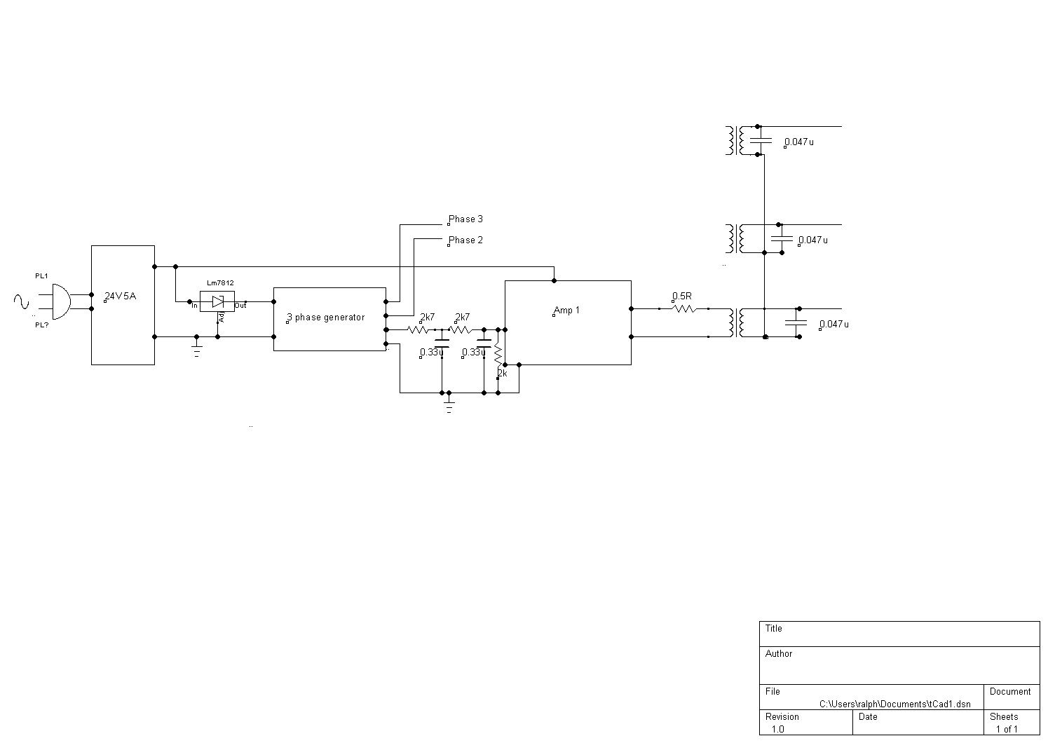

Got the amps Friday and the rest of the stuff we be here this week. Looking over your pictures and schematic was trying to figure out how you hooked up the input. The only information I could find on the web about these amps was on there web site.
It seems like you have to run the signal to both the + and - terminal and gnd to gnd. I am guessing you bridged it at the board. The divider and low pass filter you show in your schematic looks like you can take the voltage from two spots and is this a 4 order low pass filter.(2 caps 2 resistors per input channel).
From the looks of the last picture you are not feeding the signal thru the 1st resistor but it is hard to see from the pictures. If you could do a hook up schematic on how you did it, it would be great.

Hi Tom,
Sorry about the picture, it was taken between the 12 and 24V setups.
To setup the amps for single ended inputs simply short out the -ve and gnd connections ( I just bent the pins together and added solder).
Hopefully the diagram attached will cover most of the questions; I'm using it for 3 phase with my Papst delta wound motor, but it could just as easily be used as a 2 phase setup (with the correct transformers) or even as a single phase generator where the incoming mains is dirty, or where a variable frequency supply would allow a turntable designed for US to be used in Europe.

Hi Ralph
They a picture is worth a 1,000 words but in this case it is a schematic. Nice software!!! Got lucky the Chinese stuff got here quick.

P.S. A small comment on Ralphs circuit diagram: The used 0.33uF capacitors will usually have a tolerance of 20%.
This will substantially affect the careful adjusted phase angle between the phases. A much smaller capacity would be better, under the assumption that sample frequency by which the frequency is generated is much higher.
Hi Hans,
I'm sorry,I should have mentioned this.
I was lucky enough to have a selection of Polyester caps to hand, which I matched to better than 2%.
If you match the caps as closely as possible; and also use low tolerance resistors, 1 or 2%, then the variation in phase shift should be small.
If you reduce the capacitors to 0.033u, even with 20% components any variation of phase shift between sections should be small enough to be ignored (1~3 deg.).
One easy way of measuring this is to use one of the signal generator outputs and feed it to all three low pass sections in parallel. Measure the voltages between the outputs of the LP filters . Assuming the resistors are well matched the difference between the outputs should drop close to 0 when the capacitors match.
