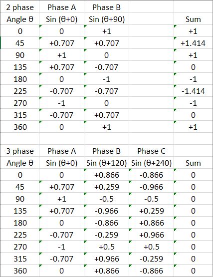

3 phase motor for turntables? I think you are onto something.
Electric power plants use 3 phase generators, and the workhorse standard for large electric motors in industry is 3 phase. Among other reasons for using 3 phase power, motors wound for balanced 3 phase will vibrate less than a 2 phase motor. 3 phases spaced 120 electrical degrees apart sum to a constant. 2 phases spaced 90 electrical degrees apart do not, and so there will be cyclical torque variation as the rotor spins. To illustrate, I attached a tabulation of the voltage sequence for each system through 1 cycle.
In a balanced 3 phase system the mechanical torque on the motor shaft is constant. In a 2 phase system there will be torque pulsation on the motor shaft, even if the sine wave is pure and the phases are separated by exactly 90 degrees.
Ray K
Ray K

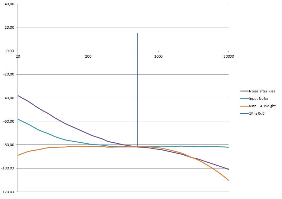

There is always a way to improve things, but at what cost and what will be the gain.
I could have bought a very expensive VPI direct drive, which probably has a BLDC 3 phase motor, the most sophisticated motor I can imagine, but I have to live with what I have.
The question is however, is it good enough to do the job ?
And the answer to my opinionis is a firm yes , when driven with a stable 2 phase steering.
My argumentation to come to this is the following:
The theoretical maximum SNR of an LP after Riaa correction is ca. 66dB-A.
I played a silent groove on a Feickert test LP and recorded the noise.
Then I played a 1kHz tone recorded at 0dB from the same test LP.
I transferred both spectra to Excel and calculated the A-weighted noise, which turned out to be -48dBr-A.
The 0db 1kHz reference measured at 16dBr +/-1dB, corrected for the scallopping loss of the Hann window, being between 0 and 2dB.
That resulted in a SNR of 64dB-A +/-1dB, very very close to the theoretical max.
So I don't see how a better motor could possibly improve on this.
Of course the noise of my phono preamp was much lower, not to interact with the measured figures.
In the figure above, I have also include the noise after doing an inverse Riaa, this being the shape of the noise as directly coming from the Cart.
Above 1kHz, noise is flat. As from 200Hz going down, noise increases with approx. 20dB/decade, but without any indication of rumble.
So to conclude, I think the used motor driven by two perfect phases is adequate for the job.
Hans
P.S. I forgot to tell that the recordings were made without any rumble filter.

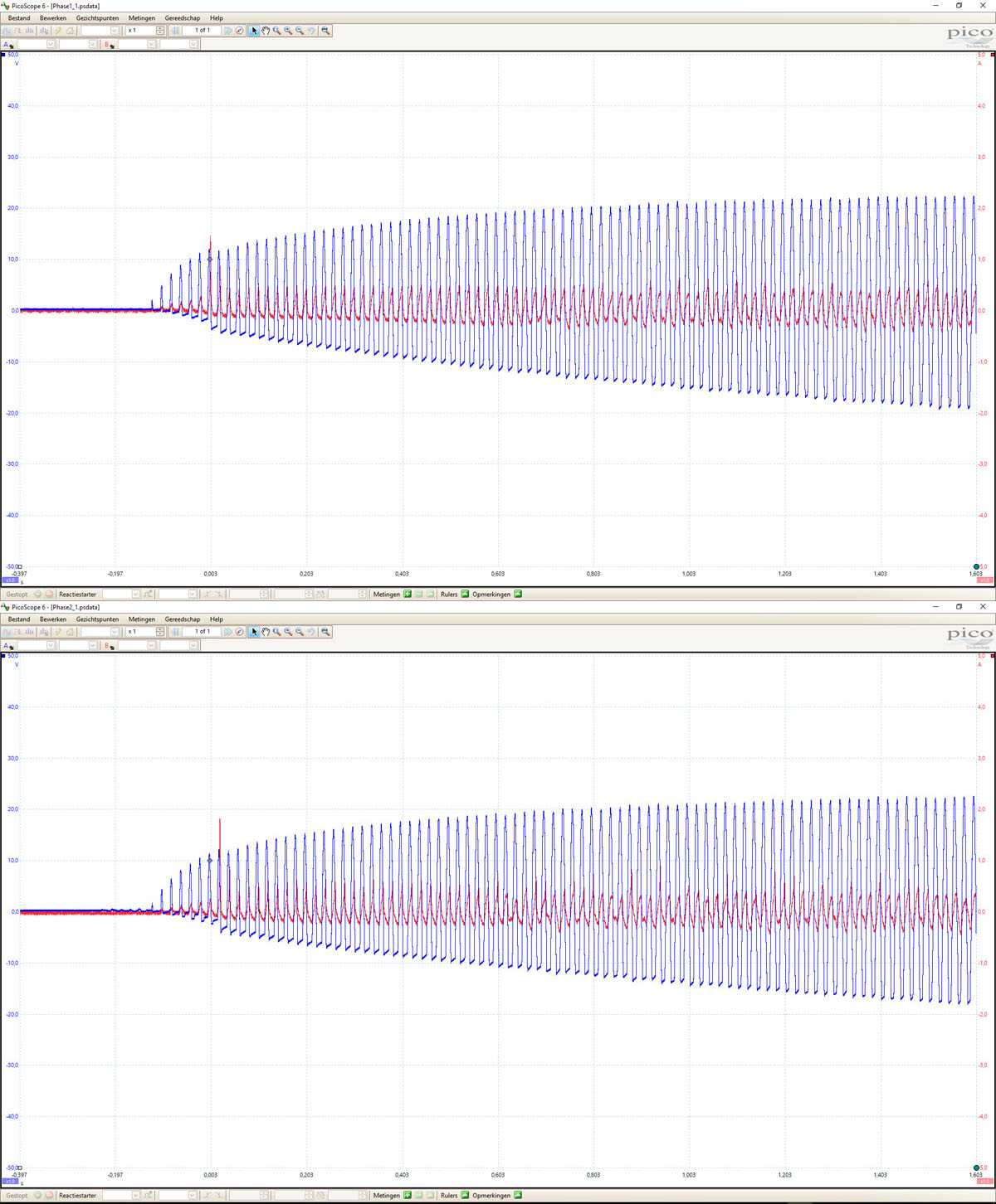

O.K. I promised to measure the current supplied by the amplifier and to publish the results.
In my situation, the oscilator and the phase splitter are running 24/7.
When starting the turntable, I use the switch on the motor housing of the VPI to switch on the amplifiers.
As I am using a Quad 303 for the purpose, where it should be mentioned that this amp has no +/- supply, but only one supply.
To drive a speaker, a large electrolytic cap is in the output to do the necessary level shifting.
But at start up, this cap has to be loaded first to half the power supply.
That is why you see clipped signals to start with in the image above of both phases. Blue is voltage produced by the amp and red is the current that is flowing.
The voltage gradually ramps up to ca.16volt rms, and the current has one large peak in both phases, but still below 2Amp.
After this peak, current goes quite rapidly to a stable situation of 240mA rms.
Not regarding a possible phase shift between voltage and current, power is now 16V x 0.24A = 3.84 Watt per phase, or a stable 2x 3.84Watt for the stereo amp when the turntable is running, with single peaks of below 2x 2Amp at start up.
This kind of power can be supplied by every stereo amp on the market !

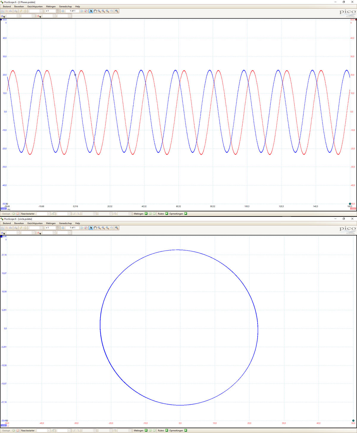

Since my current gear is more sophisticated, I made a fresh recording of the voltages of the two phases when the turntable is running stable, to show the quality of the signals.
Also did I record a Lissajou figure made of both signals, showing a perfect circle.
Hans

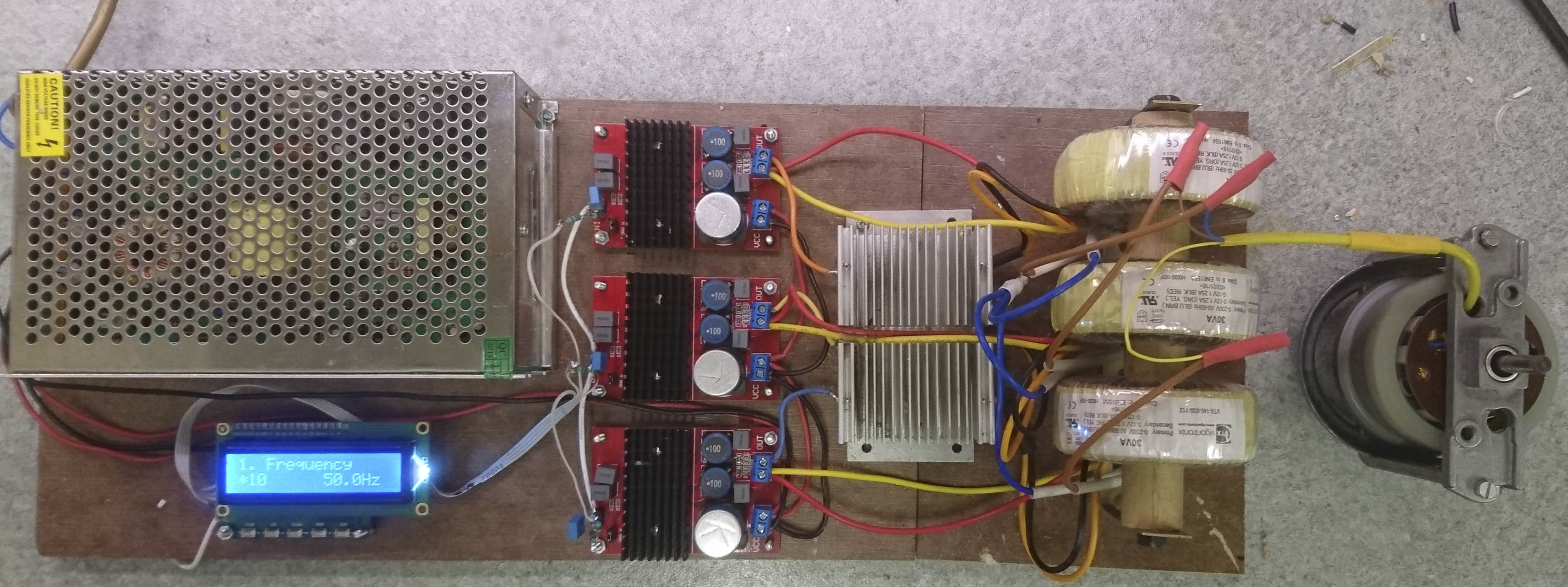

Here's a picture of the first 'rough cut' of the 3 phase setup for my thorens td124.
I'm using the items specified in my earlier post (#28). The extra components are :-
3 x 10W 1.0 ohm resistors in series with the outputof each amp; these are fixed to a heatsink taken from an old pentium processor.
3 x 30VA 12V ~ 230V toroidal transformers. (these are needed to drive my
larger Papst motor, smaller transformers would be ok for a smaller motor.
1 x 12V 120VA SMPS power supply, again a smaller psu would be fine for a smaller motor.
The only mod so far is to add a couple of resistors to reduce the input voltage to each amp and a capacitor across the input of each amplifier to reduce any noise/hash from the generator/psu.
I also include a picture taken from my portable scope, of the voltage across the 1 ohm resistor, showing the lack of noise/distortion( sorry about the v poor quality of this second picture)

Hi Tom,
I included the 1 ohm resistors because the amplifiers are specc'd for a minimum load of 2 ohms. I'm only using a 12v power supply so I worked out that an extra 1ohm in series with the transformer should do the trick in limiting the startup current. I actually bought a few spare amplifiers just in case I guessed wrong 🙂
I've been running the setup in the picture for a few days almost non-stop. The amps run almost cold, the transformers are at about 45 degC, in fact its only the heatsink over the resistors that get at all hot, and that's easily fixed by the addition of a 12v computer fan reattached to the heatsink.
The motors (I have 2 different Papst motors) run almost completely silently, only a very slight 'woosh' of the air moved by the external rotor gives any indication they are moving.
