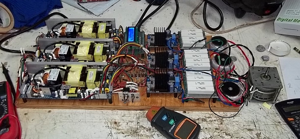

Hi folks, just now became aware of this thread. I have been working on a 3 phase VFD for several months now, and have a working drive running a Papst motor, salvaged off an old Rek-O-Kut TT. It's nothing fancy, no feedback loop or anything like that.
It is based off of stuff I mostly bought on ebay, and uses the $40 3 phase signal generator mentioned earlier in this thread. It ended up costing me about $150 to build. It uses the brute force approach, and wastes a lot of power, but power is cheap these days, with class D amps and dual rail power supplies. I'm calling it Jethro, after the character Jethro Bodine in the old Beverly Hillbillies TV show. It's a simple brute, and also an example of "hillbilly engineering" , so think it fits. It uses the signal generator, 3 class D amps, three dual rail power supplies, and three torroid filament transformers, and a bunch of monkey coffin power resistors. Basically about 450 watts of potential driving a 30 watt motor. 🙂
As usual, I put the cart before the horse, and got fascinated with the motor before I actually built the TT. At this point I can't really totally evaluate the project, as I'm getting some slightly inconsistent results, while testing the motor unloaded. At this point I don't know if the inconsistencies are real, and if they are real, is the potential problem the signal generator, the motor, or the cheap tachometer I'm using to measure the speed.
I must warn everyone that I am completely self taught, and know very little about solid state circuitry. However I was an IBEW electrician (retired), and I am a somewhat accomplished tube amp builder and designer (self taught as well). I don't have a lot of technical knowledge, or sophisticated equipment, but that's never stopped me. Bear with me, and keep it in relatively simple terms please.
At this point, all I know is the motor runs smoother than on regular single phase and the faking capacitor, and has a LOT more torque. The precision instrument I used to determine this is my right index finger. It does change motor speed with frequency. Exactly how accurate the speed is, I'm not sure of, and will probably have to wait for the completion of the TT project, which unfortunately could take quite a while. At this point it seems very very close, but we are definitely NOT playing horse shoes or hand grenades, with TT drives accuracy is paramount.
Over the last few months I've been posting this on the Vinyl Asylum. I have been reluctant to post the construction details, and a bill of materials, since I didn't want people to waste time and money on a project that might not be ready for prime time. However, this forum is composed of more adventurous souls. If anyone might be interested in this, and may want to help develop it, or at least get some ideas. I'd be glad to share the method of my madness, and sources for materials, just let me know. I would also welcome any constructive comments or observations.
Here's a photo of Jethro in all his unsophisticated glory. BTW the amps and supplies seem to be very stable at the frequencies and voltages to run the platter between 33.33 and 45 rpm (~1800-2432 RPM on the motor). I'm not real interested in 78, probably a good thing as that motor would really be flying at that RPM.
You guys need to start putting these things on metal boxes at some point... they're a pollutant of your audio system.
Ya I know... mine isn't even built yet.
I hear ya
This was a PITA to build, so just planning on building a metal box around it and adding some quiet computer fans for cooling. I'm not going to take a lot of pains to make it real pretty, as I don't have the WAF to deal with, besides I like the mad scientist look. The power supplies have a low voltage section that will work for the fans. I will also place it some distance from sensitive equipment. I know it transmits a lot of noise, I can really hear it if I get it closer than 10 feet from my shop radio.
twystd
twystd

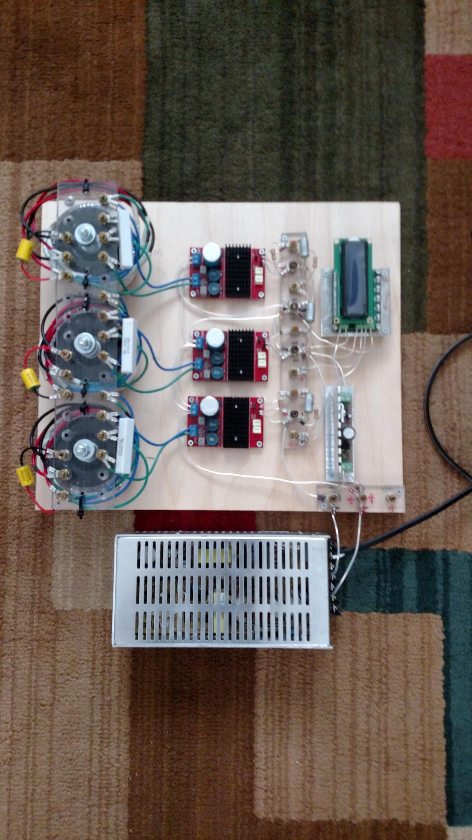

Hey Guys
Got the power supply up and running. Built it like Ralph's schematic but with only one low pass filter and 3 ohm load resistors after amps.
I do not have a 3 phase motor yet so only using 2 phases at 90 degrees. Butttttttttt!!!!! Get this. I hooked it up to the turntable and the thing starts up at 60 hz it is running to fast so I go to frequency gen and adjust it down .1 hz at a time. Now for the problem at 58.9 58.8 and 58.7 it runs at 33.476 rpm at 58.6 58.5 and 58.4 it runs at 33.204 rpm. It is like it knows I want 33.333 and wants nothing to do with it. HOW CAN that happen???? This is beyond my pay grade. I am using a Phoenix Roadrunner so I can watch the rpm as I go. The controller is holding the rpm stable just not at the speed I need.
I can make another pulley or machine down the current one but something has to be wrong for there to be a large gap at 33.333 rpm.

This against all odds. a synchrone motor has no alternative but to follow the frequency of the signal that is offered under the condition:
1) the phase between the different signals is correct
2) The voltage is adequate and is a sinewave
3) the phases have roughly the same voltage.
Your picture of a job well done shows 3 phases, but your motor has only 2 Phases, is that correct?
Why are you using 3 Ohm resistors, have you tried without or with a lower value, because quite a voltage drop will develop over this resistor.
In that light, what is the voltage when measured on the motor and are the phases equal in voltage?
Do you have a scope to measure the signals on the motor and are they neat sinewaves?
Just a number of questions.
Succes,
Hans
