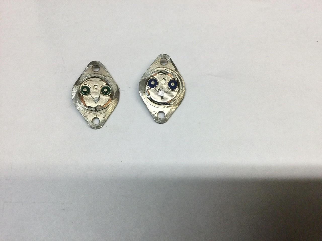

They grew out of the 2N3055/MJ2955. “What did you expect? What did you reasonably expect??” Certainly not MORE gain, considering that hFE varies inversely as Vceo within a given lot. I’ve had some actual Motorola 2N3055s that zenered north of 200V. Gain of maybe 25 at an amp. Gonna be hell on your drivers if you run 4 ohm loads. Last batch of MJ15016 I had ran around hFE of 7 at 7 amps. That’s an amp of base current. Even your favorite sustained beta drivers are going to be falling off up that high. Not to mention getting hot.
MJ15003/4 grew out of the 2N5631/6031.
Another huge issue was the beta difference between the MJ15015 and MJ15016. I didn't know they came from the 2N3055 process, but it figures. I didn't pay much attention to them. To my mind, 2N3055 is a linear power supply pass transistor. That's it.
The 2N5631 - MJ15003 and compliments are no surprise I guess, they were all very good transistors.
There is just as much beta difference between 3055 and 2955. The profile vs. current isn’t even close either. Mid-80’s vintage Motorola, 2955 vs. 15016. Neither looks especially impressive.
