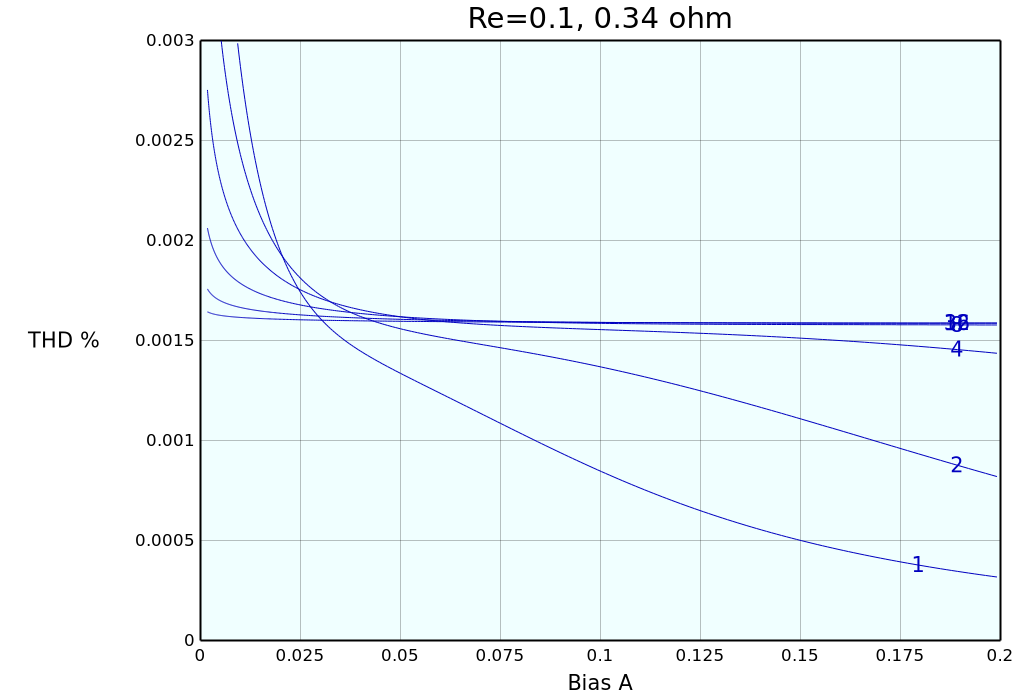

@PMA - I realized that making the simulator lopsided would be easier than straightening the amplifier.
I adjusted the parameters to match your 23mV measurements in post #47. I found that I could replicate the distortion spectrum through the fifth harmonic by using 0.1 ohm and 0.34 ohm emitter resistors. This mimics NPN/PNP Hfe mismatch times source impedance in the amplifier.
And the optimum bias is... more is better.
The curves are for different peak amplitudes in volts.
I feel good about the simple model (this model has negative feedback).

This is very positive. The distortion being due to Ebers-Moll is confirmed and I did not have to buy an expensive analyzer. 🙂

Ebers-Moll is obviously correct, but there are so many other factors and assumptions made in simulations. A simulator is much more useful in an integrated IC, like an op amp. Outside of that you have too many factors to take into account.

I am okay with getting the first-order effect right and designing in a manner that minimizes all other effects. Audio is just an old hobby and I already have enough amplifiers. 🙂
ETA: Here is another check. The simulator needed a loop gain of 700 to produce the right absolute values. @PMA - What was the actual loop gain?
