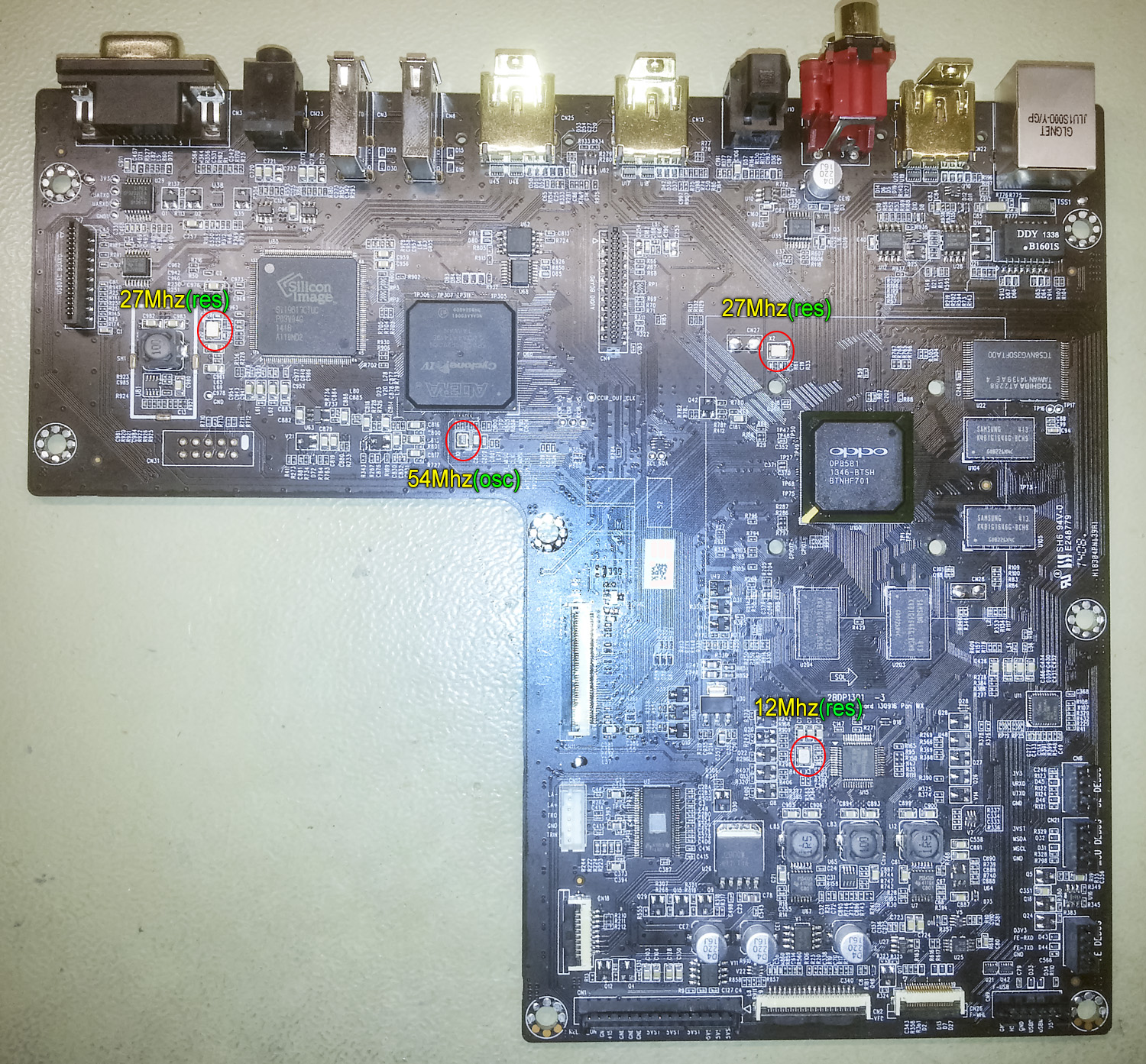

I plan to install dual clock module, and my 105 is 98% for music playback, so instead of Marvell's clock update I want to update the BD-Drive resonator.
Do you know if they are the same frq?
Unfortunately, I did not see any BD-Drive clock update report here. Any tips and hints will be appreciated.
BTW, after study a mainboard picture (this one is 105D, but should be same to 105 layout around SoC), I could not find other clock than main system clock.
There is no any clock for BD-drive in 105 (like in 203/205), as all data coming from drive it are processed by main processor. So the only clocks for 105 (digital board) are 20Mhz for Marvell chip and 27Mhz for main processor (12Mhz is for USB chip).
