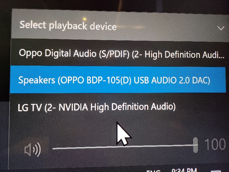

I encountered an USB DAC malfunction on mu Oppo 105d unit after an unexpected incident. I plugged my Asus laptop to wall socket, which was in contact with Oppo through USB A-B cable. Normally turned the power on on laptop and it booted in Win10. When I started music player, I noticed that there was no sound and recognition of OPPO USB 2.0 in Audio output list. As I later inspected, my external HDD was not recognized and was flashing strange, but it is ok, as I tried it on another PC. Well all 3 of 4 USB ports on my laptop where dead. Only mouse could work normal. Like amperage was fallen on all ports.
I than connected Oppo using other USB cable to the other computer Win 10 (supporting native USB 2.0 driver) with Oppo USB DAC input and it also did not recognized the unit or played the sound.
Coaxial and optical inputs on Oppo work prefect, but only USB DAC input do not work.

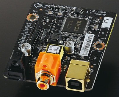

Sorry for my delayed jumping in here for an replay. If the price for the USB board it seems enough convenient to you, then you should accept any opportunity in getting an replacement for this board. Indeed, it seems the USB interface it was damaged somehow. This interface is not especially protected and it is quite fragile. The replacement board it should be exactly the same, as the interface with the Oppo main board is particular only to this model. If you have not found yet an solution in the mean time, then you can try this option (former Oppo service agreed centre for EU): oppodigital@heimkinoklohs.de Maybe they could help you.

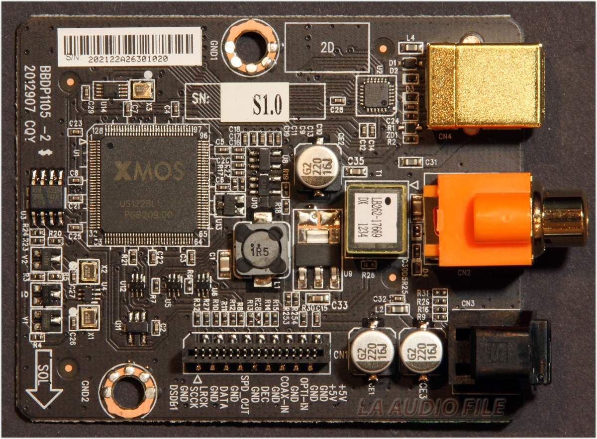

I took the board out of the device for visual inspection and there is nothing wrong with the little smd stuff. My friend suspects the main XMOS chip, assuming the usb input is directly connected to it.

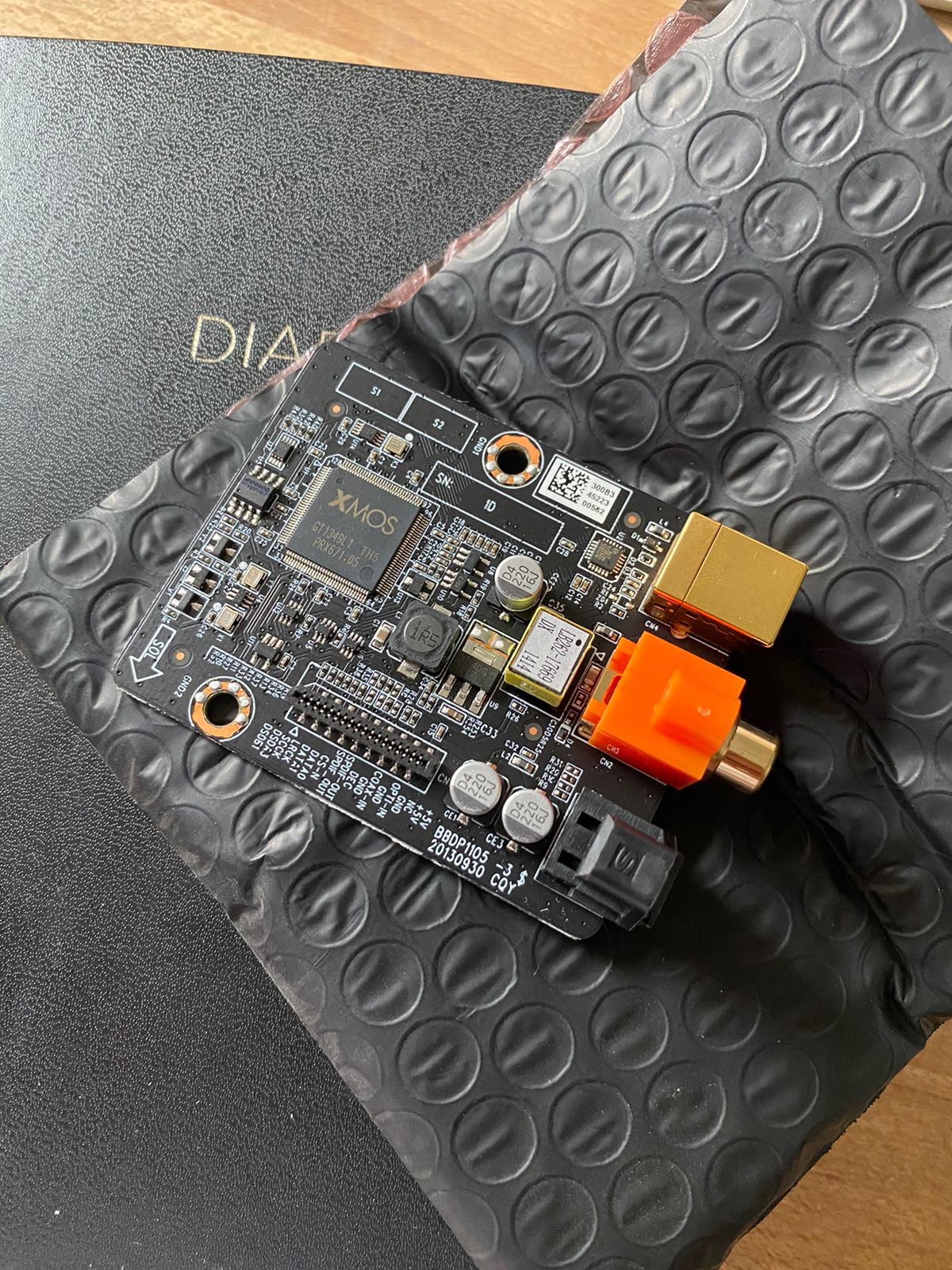

Igor is a top man. He answered me within 1 hour. Already in the first answer, I received a picture of a USB XMOS card on an antistatic package that he received from an Oppo authorized service in Moscow. Igor talked to the service to send me a card for Belgrade, with of course my acceptance of responsibility for personal installation and replacement. I am currently making arrangements with the service to send it.
Keep your fingers crossed for me! 🙂
Good to hear, I had also good first contact that's why I mentioned ru service. German service is very slow and I don't recommend it, but we don't have much choice..
Finally, the spare part arrived from the Moscow Service. After many attempts to get the part mailed to me and not being able to do it, I arranged for someone to fly from Moscow to Belgrade. Fortunately, I only needed one day for that organization, but after two months of trying in vain through various mails.
