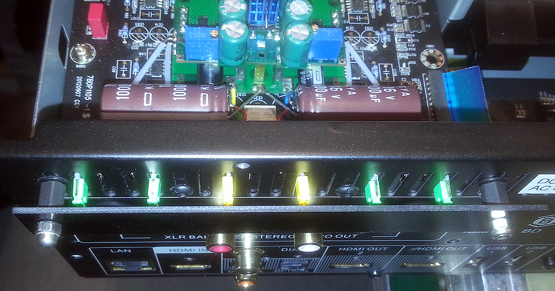

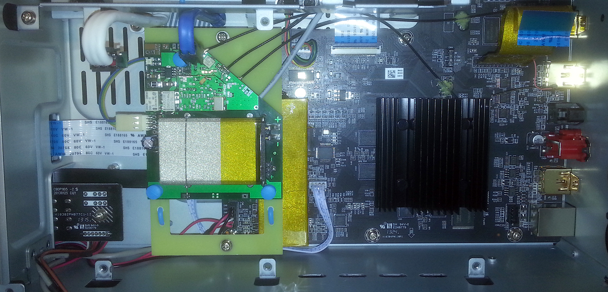

New installing approach for a new clock board version in the old 105...
And an AC/DC coupling selector for RCA/XLR outputs...
Hi Coris
Did u say you preferred the xlr output via a switched attenuator instead of using the volume control on the oppo?
Ta for any help
John
Ta for any help
John
The best approach is to have the XLR output level so as it is, without no any attenuation (supposing the next amplifier device/stage it will have a analogue volume control).
Personally I will prefer a such analogue volume adjustment rather than using the inbuilt digital volume control into the Sabre DAC chip (setting the Oppo volume level on Fixed).
