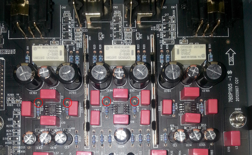

The AC coupling caps are to be used in AC domain, This it mean that the main appreciations and voltage rating for these caps it have to be in this respect. On a XLR output it can be voltages peak to peak up to 9v. A cap is to be rated almost three times higher voltage than the targeted voltage to be used to (AC domain). So...
6,3v rating is not good for a AC coupling cap used in that place you intend to use it.
A minimum 16v rated AC cap is a good compromise voltage/dimensions in this case. As higher the capacity, the better the results (as ESR too)...

BTW, the voltage level you found on the outputs is not good at all. You should measure the offset right before the AC coupling caps (opposite AC coupling cap pole/leg to the one going to the RCA/XLR connector). This is measured referring to GND. As normal, you should find the offset as few +/-mV (into 10mV)...

It seems to be a pain to do.Is there any point on the pcb you can measure it without flipping the board over and measuring it at the capacitor pin?

R241 -0.6mv R3 -3.2mv
R140 -0.9mv R128 -3.4mv
R244 -0.9mv R141 -0.4mv

Just perfect levels (for the original circuits on board).

Was going to put up a picture of the power amp input but as the dc offset seems to be ok will not bother
Will remove single ended 100ufs and see if amp ok with it then if ok remove the balanced output ones.

Amp working fine with the ouput caps removed.Noticable improvement for the removal of just one cap(and two on balanced output)
The voltage has risen with the Schottky diodes.So is 10v cap ok with 8.1v digital supply going through it?
John
Yes.
